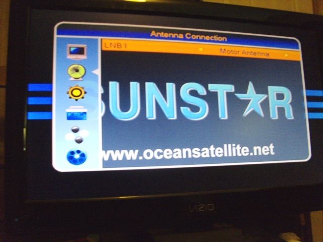

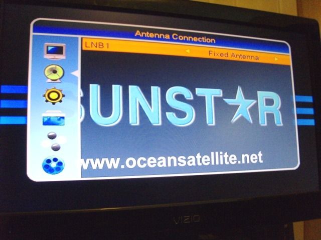

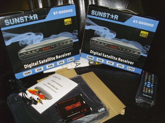

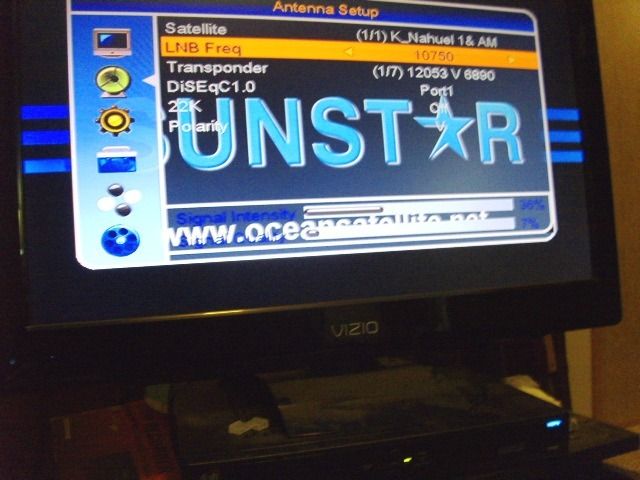

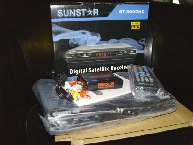

ok guys got my Sunstar ST-5000HD boxes in today they have their good and bad aspects so far havent really did a lot with them since I have just been home a few minutes but I did a fast blind scan and it detected one less transponder than my openbox s10 and more than my pansat units scan was under 2 minutes and it scans the channels in for each transponder as it goes they do not come with a hdmi cable so I used the small rca cables supplied with them and had to adjust the res on the stb for my tv in the menu hooked the other up with a hdmi cable I have and it came on just fine I will post more when I play around with it more also the power plug isnt polarized the menu and the add says it has diseqc 1.2 and it is really 1.0 so I can only use with a 4x1 instead of my 8x1's PICT0137.JPGPICT0138.JPG
8x1 is a must, are u sure no 8x1? and does it do bandstacked lnbz?

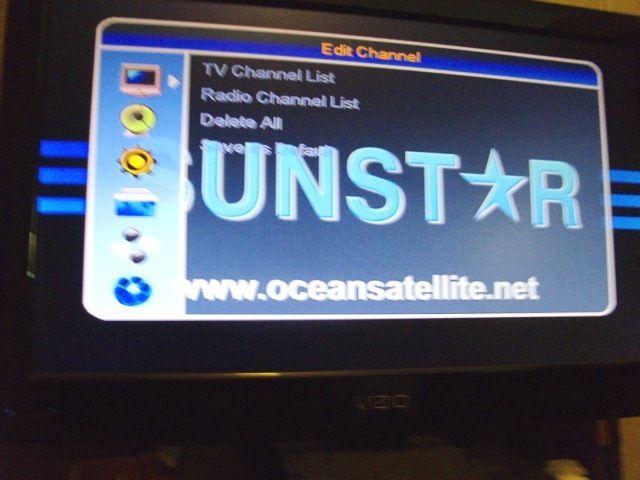

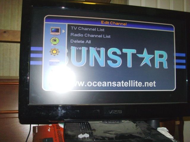

All of my Lnb's are bandstacked For my salvaged dish 105 ku lnbs that I have on all of my ku sats I scan LO 11250 V only in a blind scan and for my B1sat I scan H only with 5750 Im still playing around with it and I emailed oceansat about the 1.0 issue and asked about the symbol rate if they are going to have a software mod to fix it to make it go to 1.0 instead of 4.0 in the near future Oh yea another downside is it comes preloaded with a eastern hemisphere satellite list so until we find a software editor we will have to use the remote to delete everything and edit it to how we want it

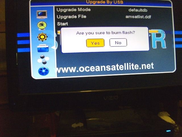

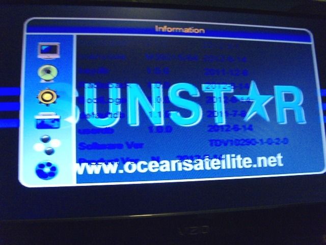

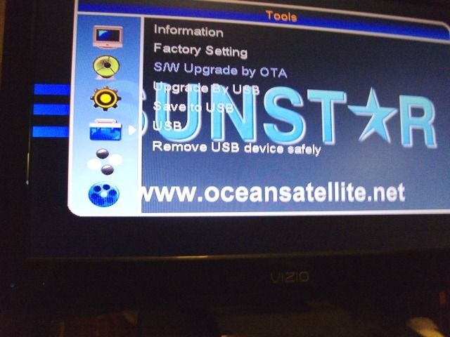

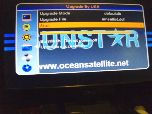

ok it uses abs files and a userdb satellite list so it should be compatible with openbox editors the maincode is M3601SAllCode.abs Channel data is defaultdb.ddf

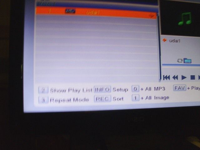

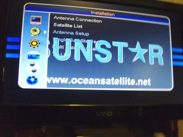

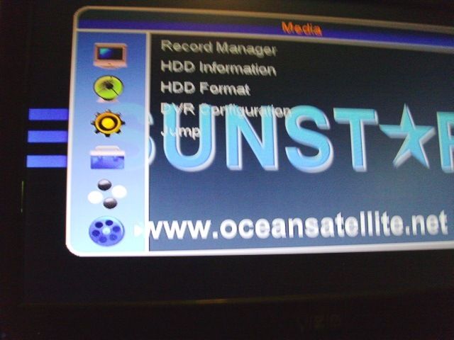

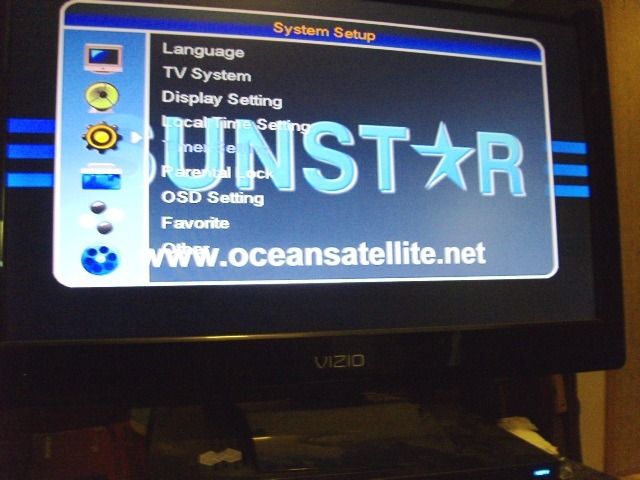

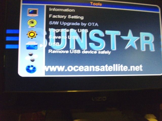

PICT0139.JPGPICT0143.JPGPICT0144.JPGPICT0145.JPGPICT0146.JPGPICT0148.JPGPICT0149.JPGPICT0150.JPGPICT0151.JPGPICT0152.JPGPICT0153.JPGPICT0154.JPGPICT0155.JPGPICT0156.JPG
Any of your dishes have motors? Curious if it handles USALS or not.
it has a mover feature I havent tested it yet I have a independent dish positioner in my living room for my 6' cband dish my other ku sats are stationary to edit my channel list I used the openbox s9 editor and saved my openbox list as a .ddf file to a flash drive then did the flash db onthe st-5000hd did a factory reset and there everything was
