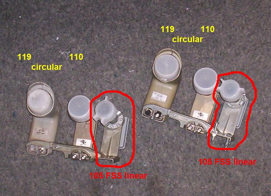

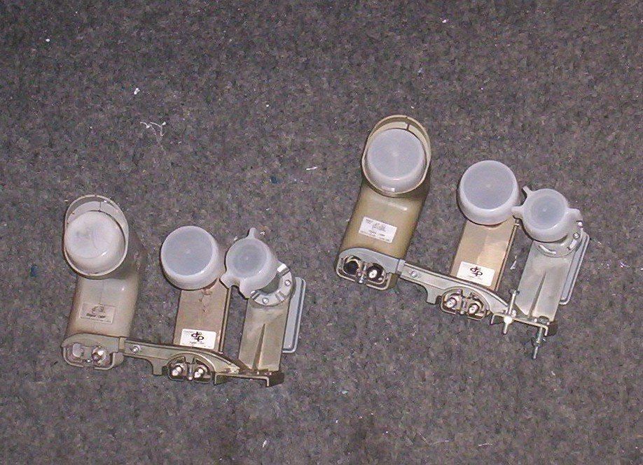

lnb assembly
anole: here are the lnb assemblies i have. is this what you need?

Yes, thank you. - :cool:
PM sent.
I appreciate the help, and I'll pay it forward (help others). - :up
