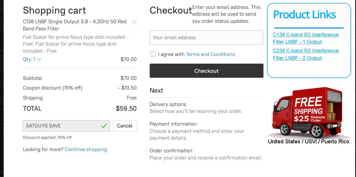

Put " Satguys Save " in the promo code coupon field. It'll give you 15% off the order
Yup..did that. But the total comes to ~$78. He is selling the same item on ebay for $70 with free shipping..so kinda wondering whats up with that.
You must somehow be doing something wrong, because I just tested that on his site, and I get $59.50 for a final cost, with free shipping...
Reactions: madmadworld
Well I guess this is where the saying YMMV comes from..

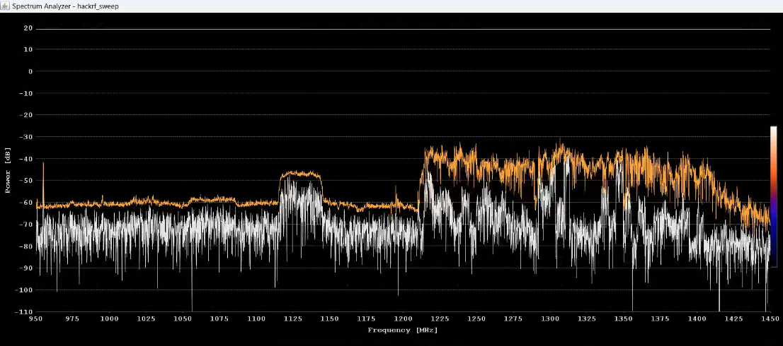

Finally got around to swapping out the original c138 with the plus and don't see any difference.
Actually the only difference is signals are 1dB+ lower across the arc. Full disclosure my area has 5G well passed 3800MHz as you can see in the screenshot (93w), but I figured I would give it a try since by the time the c140's are available old man winter will have set in..
