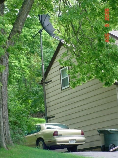

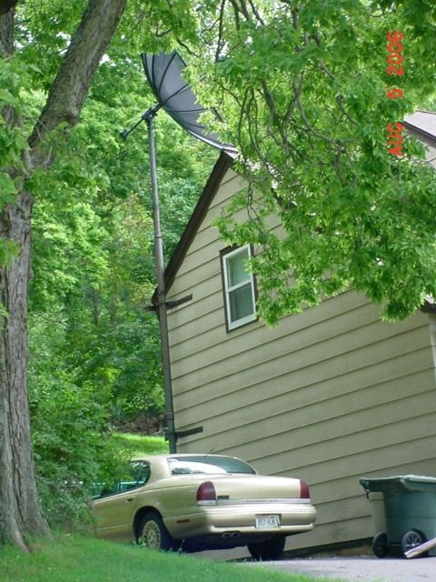

Here's a picture of the end result of my biggest weekend project I've tried so far. I had a buddy make me a 30' dish pole out of well-casing. I then attached the 10' unimesh dish to it. Had another buddy, who's dad owned a semi-sized wrecker to 'hoist' the thing in the air (at least to the point where two guys on the roof could grab hold of it and pull 'er against the side of the garage.
I then took two pieces of flat iron that I secured to the pole, ran lag-bolts through the outside wall of the garage and using very large wing nuts, seucured the bolts to the inside wall of the garage again using two pieces of flat iron.
Believe it or not, I had preset the elevation (I had installed other BUD's before) and 'eye-balled' the north/south axis so when it came time to peak the dish it only took a few minutes.
Advantage: no one would dare try and steal the dish.
Disadvantage: hard to remove snow (had to use roof rake poles)
p.s. I did this in 1991

We put up a 12' pole, but the bottom of it is 8' off the ground, so the total height is 22' with the end sticking above the building just enough to clear the dish. I had another friend who owns a pipe and steel company make the mount out of well casing with 3' wide steel plates welded on 5' apart with 1/2" holes drilled through them with the corresponding holes through the wall with steel plates on the inside. The walls are 12" thick brick and concrete block. It took quite a while to drill the holes and we used a lift to put the mount in place. It is all bolted down now, and almost perfectly plumb.
I have several guys coming out early in the morning to help put the 10' mesh Winegard on it, and help me line it up. By this time tomorrow afternoon, I should be watching FTA.

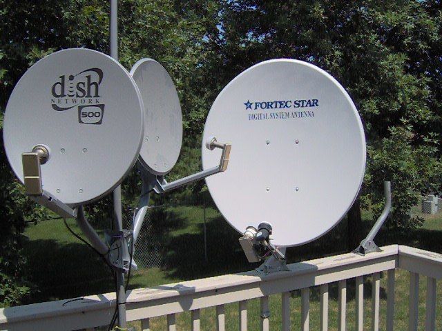

Put the 30" hotdish up where the Dish500 was. Have about 1/2" of clearance on the side between that dish and the StarChoice dish :)
Have no clue where its aimed right now (thats for tomorrow) and hooked 2 cables to the dual LNB.

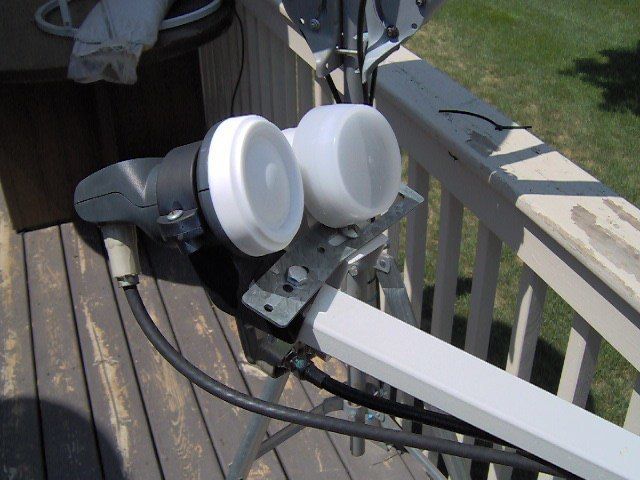

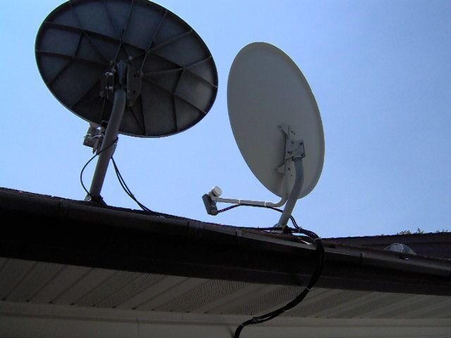

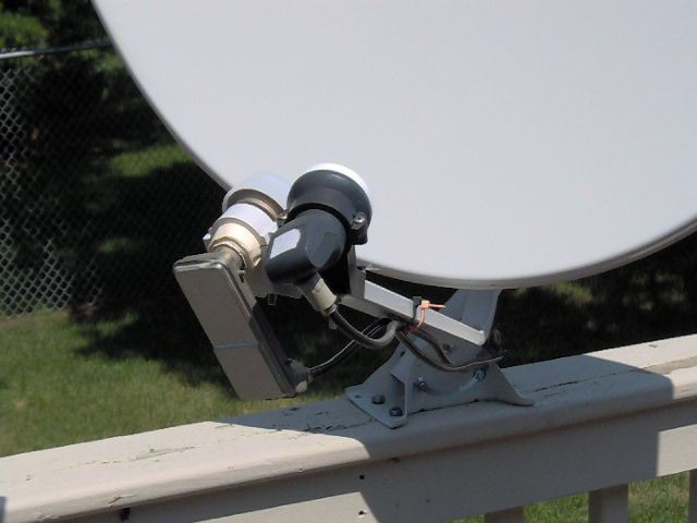

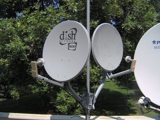

Switched to DishPro. Swapped LNB's on the 61.5 dish, put a "I" adapter on the Dish500 so that can be peaked for 110 and put a DBS LNB on my G10 dish (with a handy 2 LNB adapter) and had to run new wiring from the switch to the house since the cable was only good for 1800MHZ (now I have stuff good for 2800)
so now its working fine :) I know this isn't really FTA related but it was a weekend project :)
1st picture is the 2 dish setup that's bolted to my TV antenna mast (110 on left, 61.5 on right) (the hole in the "I" adapter on the 110 dish was due to needing a hole in the adapter for an old project)
2nd picture is the 123/119 setup :)

4th is a closeup of the 2 LNB bracket (needed a little modification)
5th is my 30" dish on the roof now (satellite spot unknown)

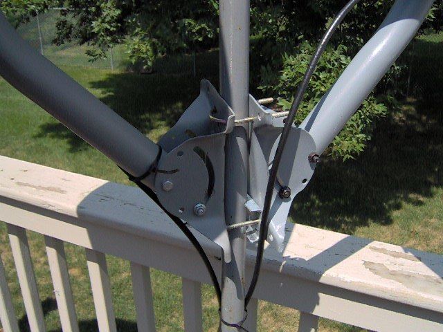

6th is the bracket to hold the 2 dishes to the mast :)

I originally had a mast to the tripod of the antenna setup but LOS issues (roof blocked it) so I moved it about a foot up from the tripod
The reason the LNB's are gutted is because that's how I got them. :)(If someone was wondering)

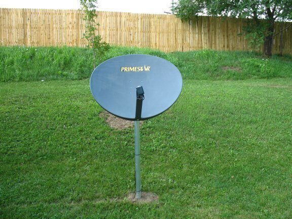

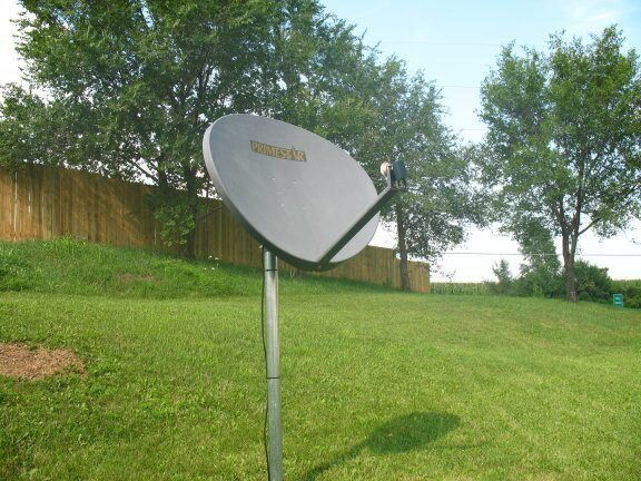

OK, here is my FTA project for the weekend... I just went outside and here are pics of my completed Primestar project. I do plan to add another lnb to this. The sky pic is the view I have.
