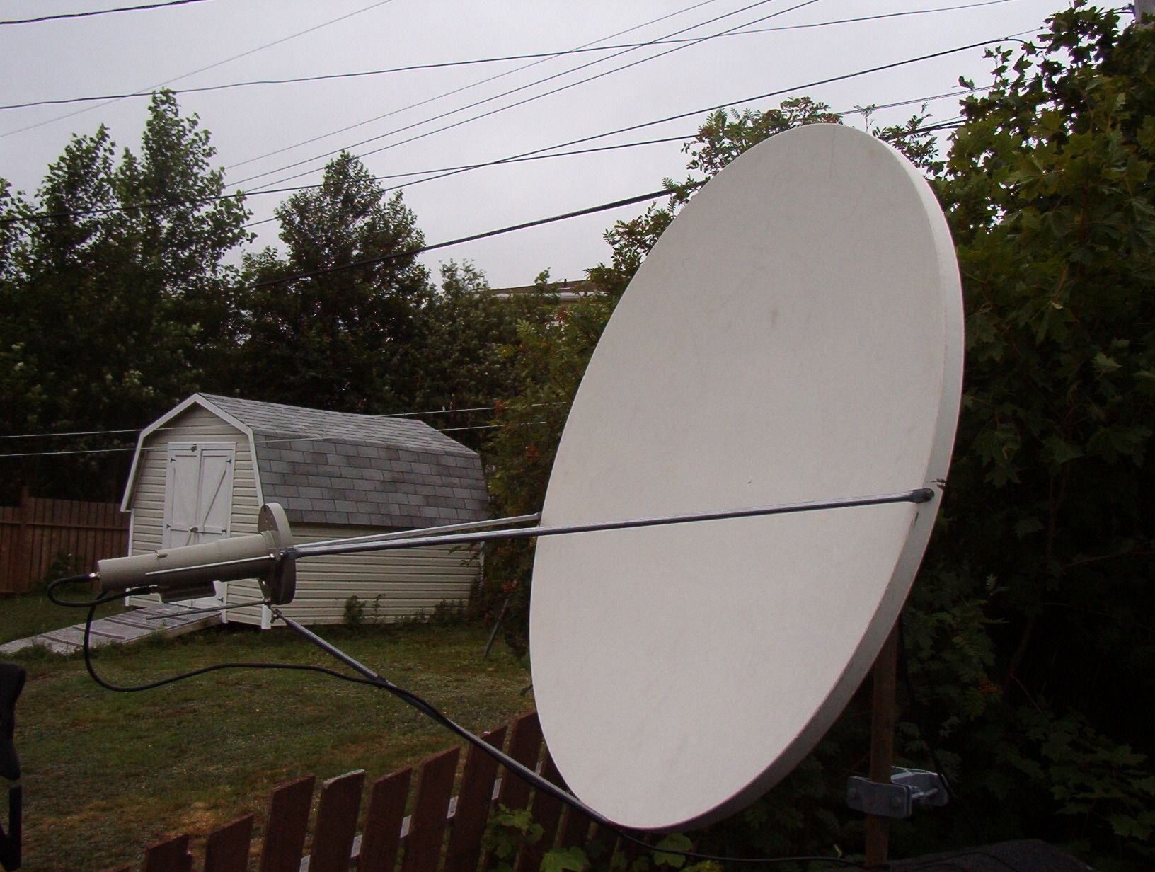

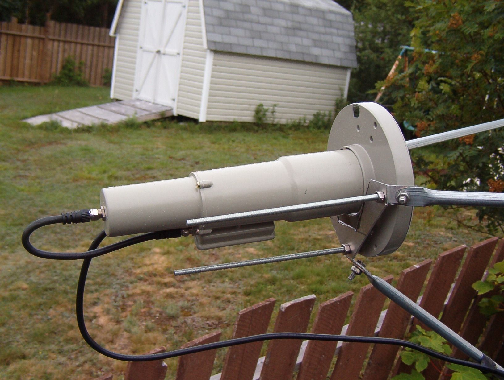

The LNBF support arms were meant for a KU type lnbf and would not allow me to move the scalar ring back far enough as they were in the way, so i cut out a piece of aluminum to spread the wide enough to allow the scalar ring to come back farther(also added some threaded rods for adjustments).
I' now thinking it may need to come back a little further so I will have to rig up another mount.
Here is a quick picture of the fabricated mount and can't do much but think about it now as it is pouring rain out.
Dave

Sa my picture shows I don't have the offset scalar ring and not sure what that may do for me in this case.The dish spec I've seen says it is prime focus with an offset feed??
