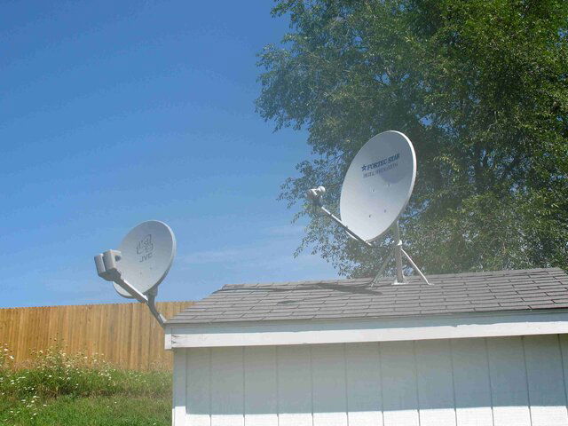

Lets see if I can upload a pic or 2. Looking on the screen, the pics are hazy as I had not let the camera get adjusted to the outdoors yet, so ther is condesation :-( SORRY!

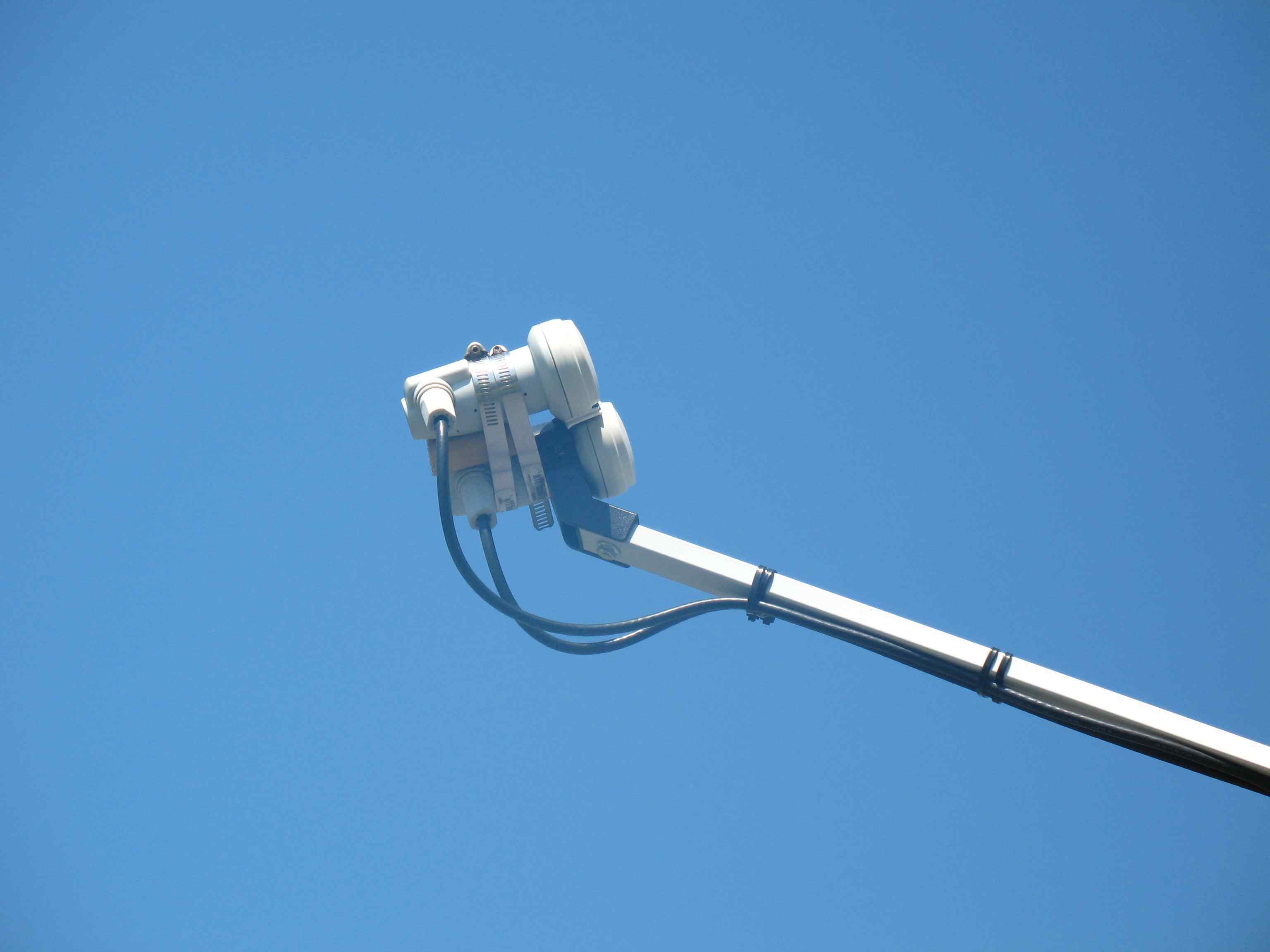

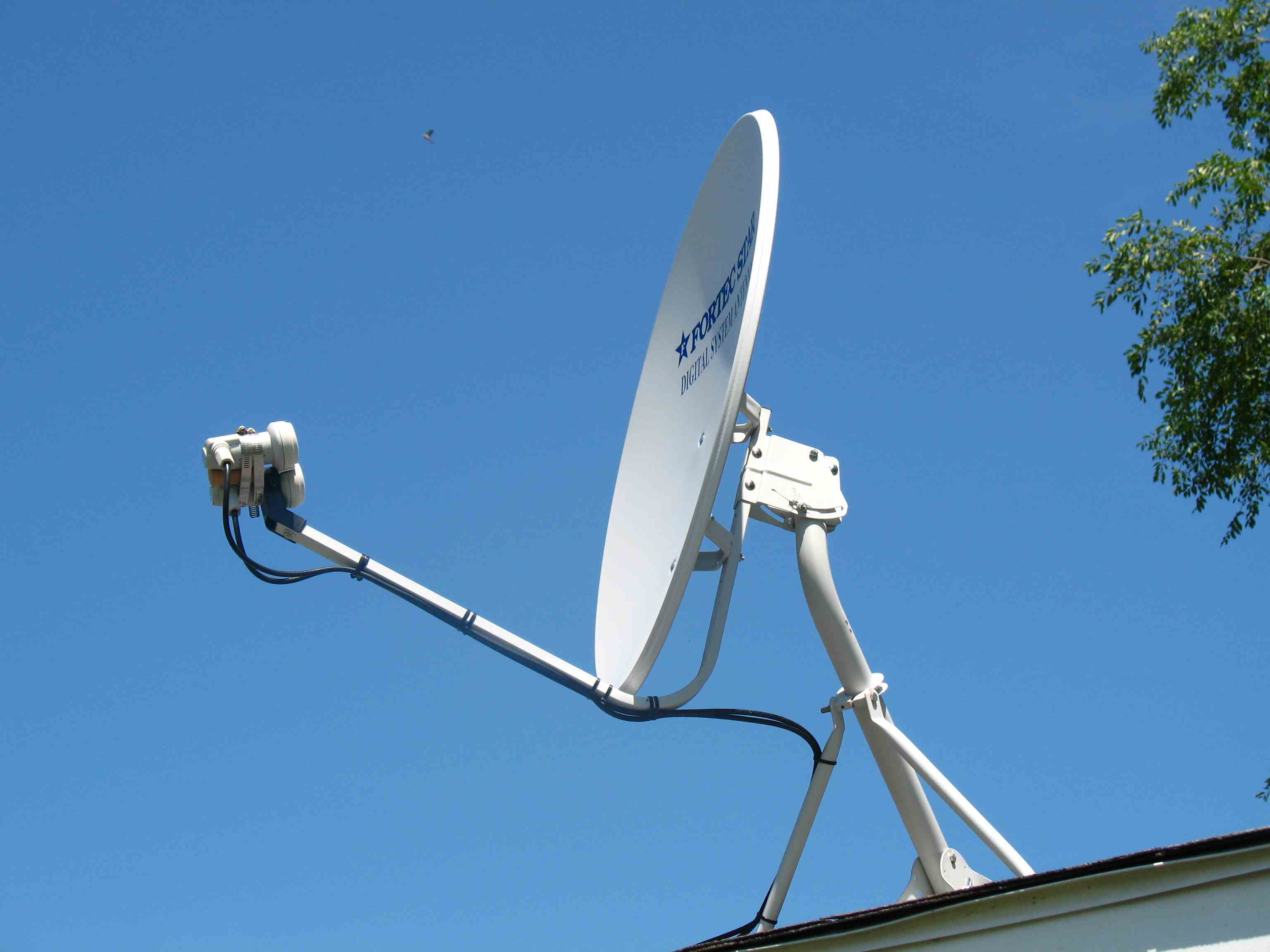

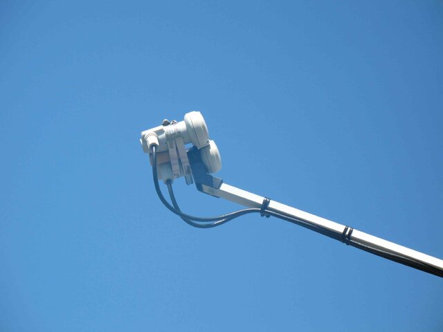

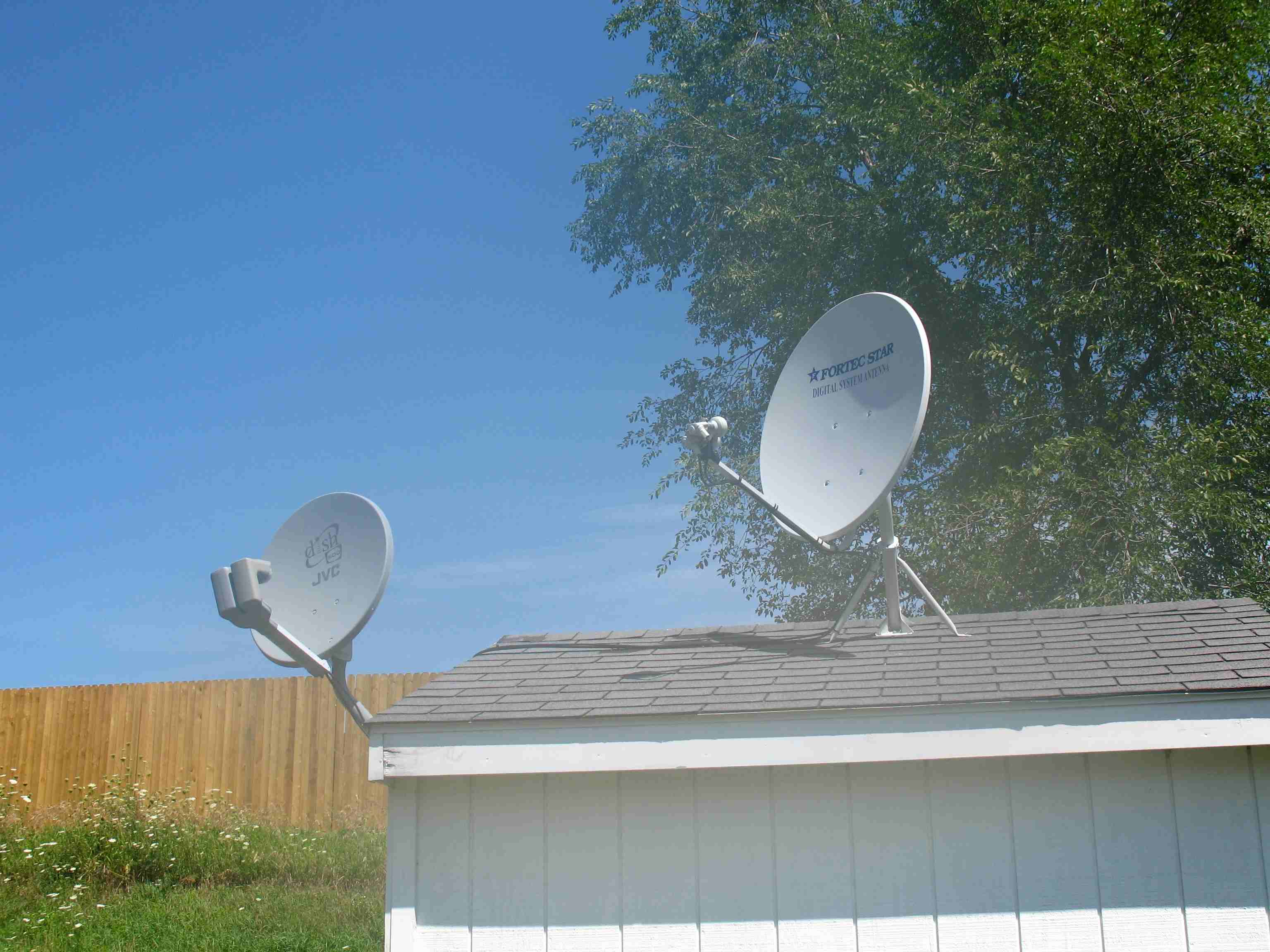

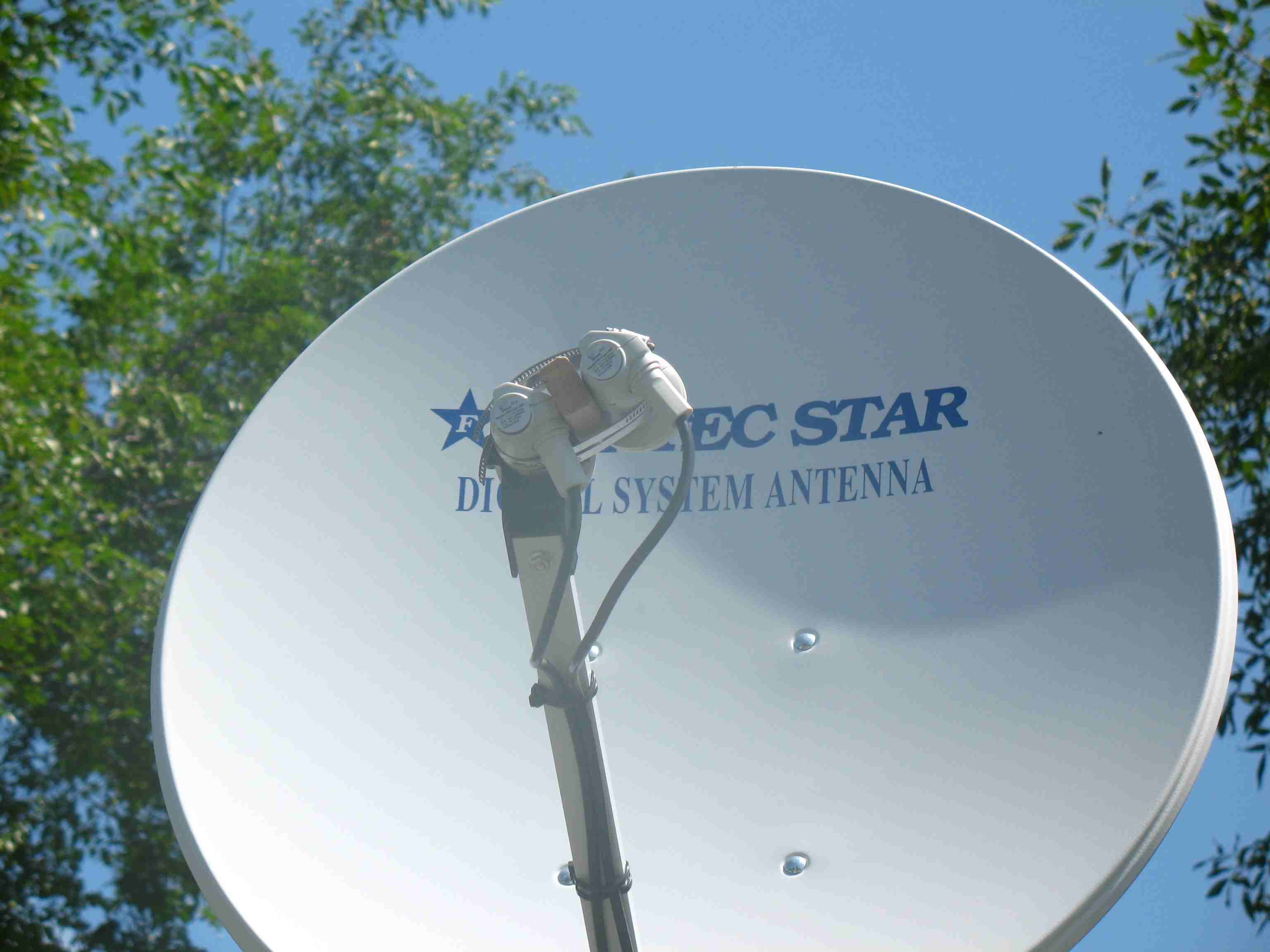

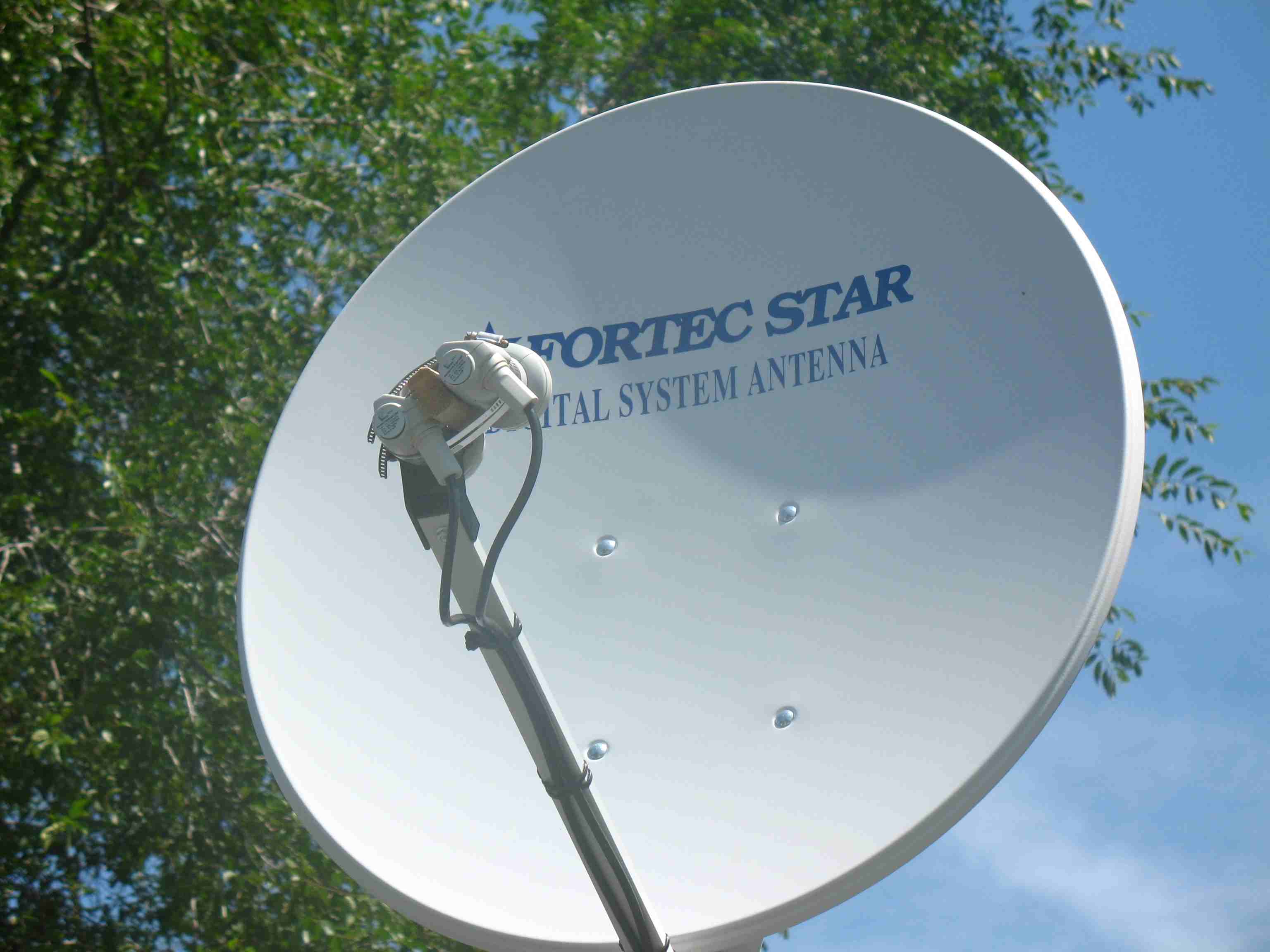

I had a small scrap piece of wood and a thin piece of plastic in between. I used 2 hose clamps as when I had 1 it was still loose. I have a signal quality of 60+% on White Springs. I took a little b&w tv up on the roof with me and moved the lnb around until I got a strong signal, then mounted it, adjusted. Really could have used another set of hands :-) But, it works real good! While adjusting, I received 127 I think - the one with chinese tv on it - or japenese, cant remember :-)

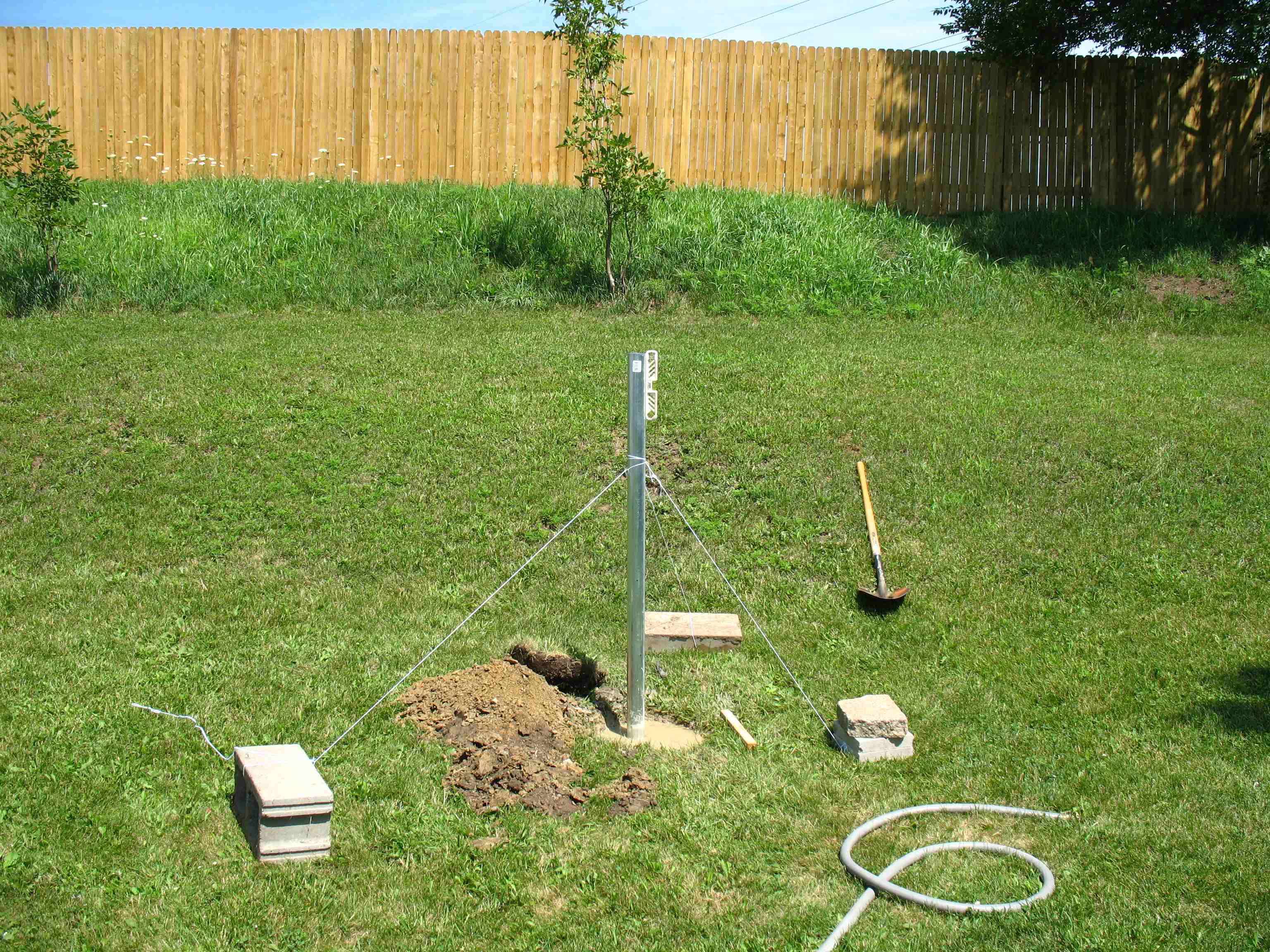

Thanks for the kind words! I copied your pics and took your advice! I had to use 2 clamps, as I think due to the design of the KUL1, they were"wobbly", so 2 held them in place. It looks like the Fortec Universal LNBs I have for the Primestar dish might be easier to moutn side by side. Which, that reminds me.....I can probably go out and throw the dirt around the pole, and put this Primestar up. The cement instructions said it can handle a load in 4 hours :-) BUT....it is "warm" out :-)

nice job Larry with the setup
Love the hose clamps :)

Nice pics... I always love to see others setups. I always give cement at least 24 hours to cure before messing with it. Did you fill the pipe up with cement?
I don't see the coax in your pic?? In the few setups I did I ran 3 direct burial RG-6's to the FTA. I ran them in some PVC through the cement and buried them by themsevles in the ground. The PVC ran about 2 foot up the pole to keep the weedeater off the cables. And you might ask why 3 cables? I should have went with 4, right? ;) The diseqc switch will be after the motor on the dish, what if I want another stationary 18inch on the house? Mount the 18inch on the house and run it out to the motorized dish through one of the 2 spare cables and tie it into one of the diseqc ports.
I am going to bury the coax once the dish is in place. My house is close by, ans I am going to run the cable to a diseqc switch, which will then feed another disqec switch. So, I will have 2 disqec switches involved. I still have more room for another Primestar dish :-)
I do like your idea of running the cabble through pvc.

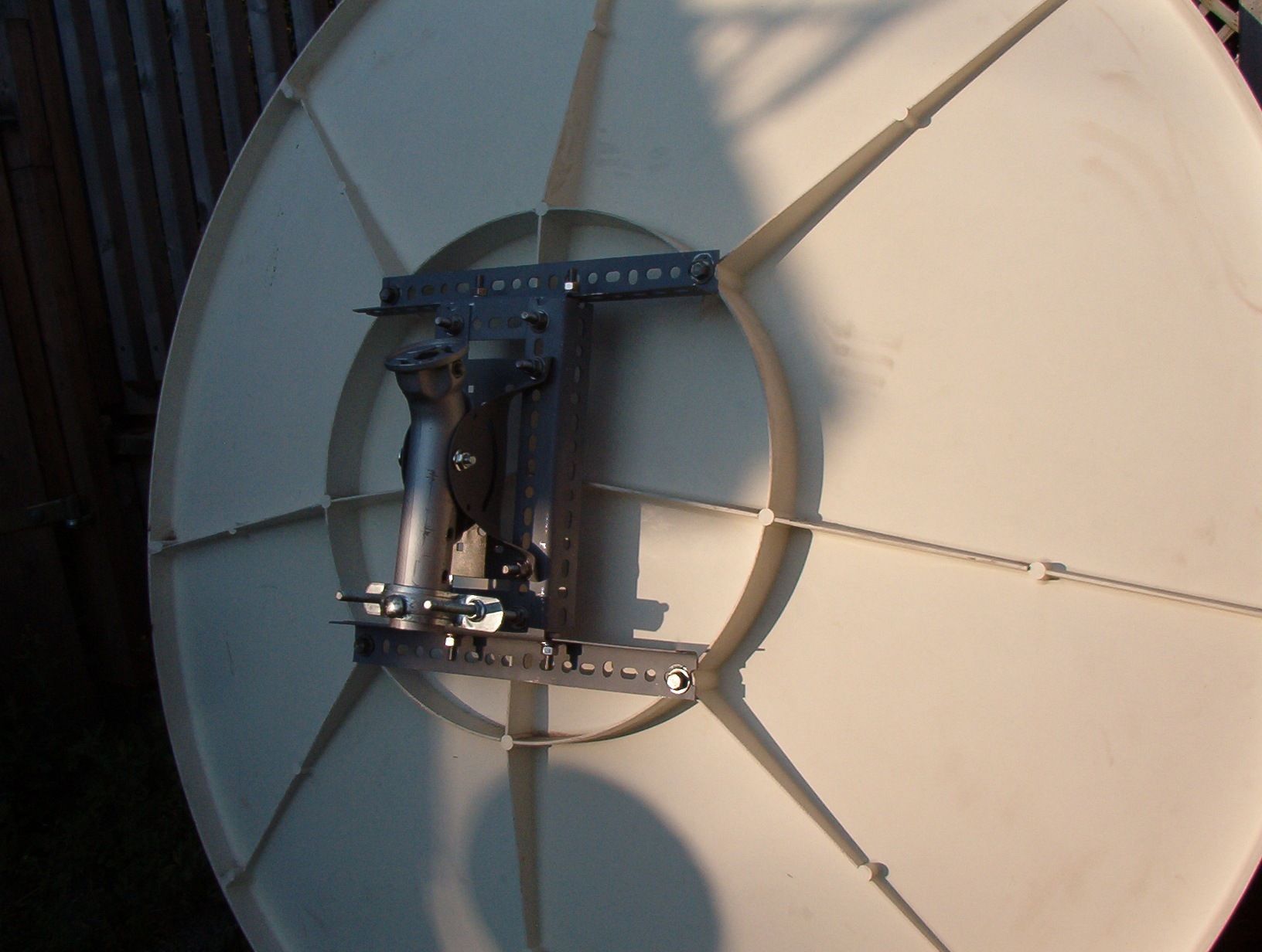

I put together a mount for my 1.2M dishbased on some pictures I seen from others members ideas,the distance between bolts on the back of the 1.2 m are 12.5 in apart thats why I decided to do it this way.
So I did manage to mount the dish in place of the 1M with no problems. THIS Mount i made weighs 3 lbs compared to 11 lbs of the original,
Here is a pic of my new mount and sorry its not a great picture as it was half in the shade and I was in a rush.

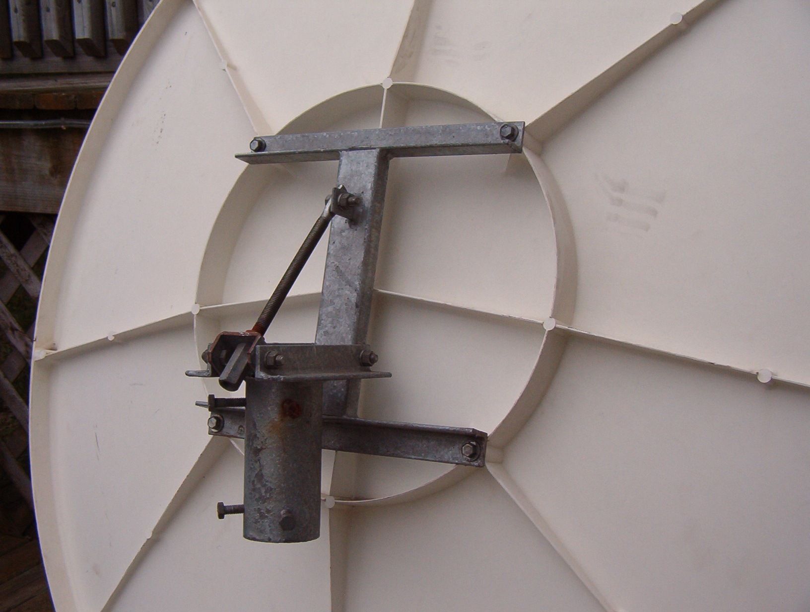

Here is the one that was on it originally too.

VERY nice work Dave! What did the dish weigh that you took off? Just wondering how much extra weight you have now!
Will be keeping a SHARP lookout for one of these :up
Thanks Pete, I followed the thread you referred me too and got those ideas. The dish I took off was a 1M Winegard although I never weighed it I believe it is around 22 or 23 lbs, so i have about 5 lbs more at about 28 lbs.
Also stuck the ku lnbf on there for a test and lined it up pretty good,the sig lvl is up don't think Q moved at all.

Well, just got back inside, went out and filled in around the post, and spread the extra dirt/clay/lime in a low spot of my yard. It is only 95 out, so I was chilly :-) Had to take my 3rd shower for the day, so I will call it quits for this weekend. I will put the Primestar dish up sometime this week (who am I kidding, I will be out there tomorrow after work) :-)
