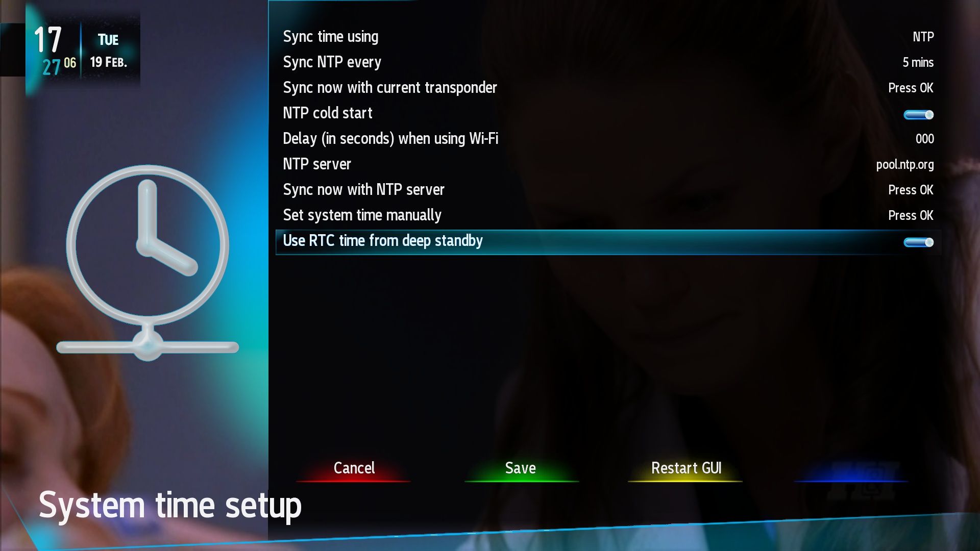

Make sure you have it set to sync to a NTP time server, and to sync at "Cold Start", and "Deep Standby" and that does seem to help it not happen so often.

interesting... I reboot often (as the blind scan seems to like a freshly booted image), first time i'm seeing this problem though. I do have the time settings like you suggest.
