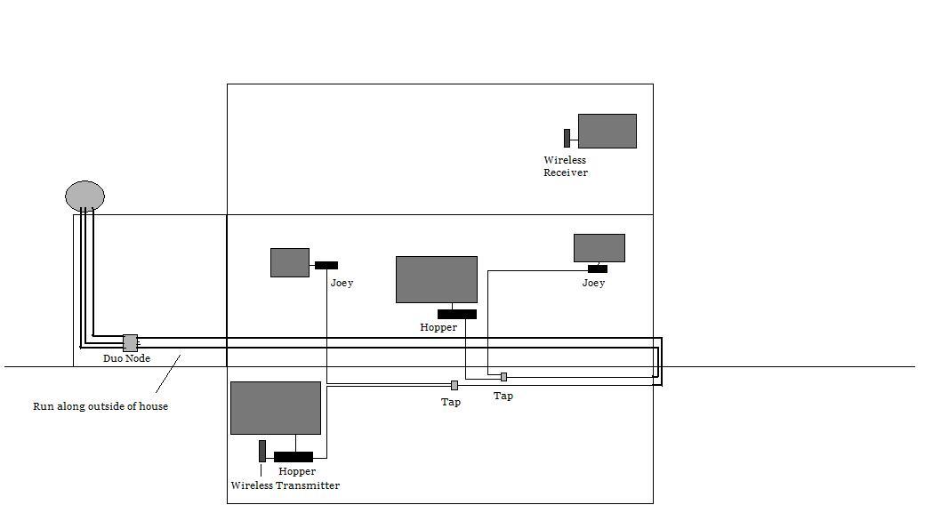

i think the way the installer hooked mine up is less than optimal. two taps, splitter, no Joey feed coming off the duo node. I got tired of the hunt and peck fix it myself. I've got the tech coming back Sunday. I'll repost on how that goes.

Did he have a good reason to use the taps?
Isn't there a limit on how many splitters/taps/nodes you can have between devices? I thought it was two. So, based on your description, there are three between the Joeys on the three way splitter and the hopper on the other side of the node. (Joey --> 3-way --> tap --> node --> Hopper)
But, I could be wrong. It has happened once or twice... :)

Looking back at the comment I notice that there is yet another tap. So it is: Joey --> splitter --> tap --> node --> tap --> hopper
Is that one too many?

your description is close, to the other hopper it's (Joey --> 3-way --> tap --> node --> tap -->Hopper) I'm not aware of a restriction, but it seems like there is.
Did he have a good reason to use the taps?[/QUOTE
not really, just did it to use the Duo Node outside my house, even though there are plenty of coax lines there that run inside my house.
That seems odd. I put my duo node outside because I only had 2 cables going into my house and I did not want to run a third around the house. The duo node outside made it so easy. All I hade to do it find the correct cables in my basement and put the taps in.
It seems to be too many. Where did you get the information on number of taps?
This is a diagram of my house. I hope it makes sense. Looks confusing but it was very easy. I already had 2 cables run around my house, that's why I put the node outside.

Mine is the same except for behind one of the Joey legs off a tap is a splitter to serve 2 Joeys. It works, just not correctly/consistently.
This might be why It's not consistent
Tap
Taps are used to create a host line and client line from a single host line off of a Node. Think
of it as creating a line for a Hopper and Joey from a single host line.
• Limited to one Tap per installation
• One TO NODE port supported
• One TO HOST port supported
• One TO CLIENT port supported
Key line is limited to one Tap per installation
