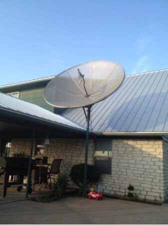

I keep finding free or cheap 10 or 12 foot mesh dishes, but they are all mounted where I'd need a crane/ get on a roof to uninstall them to get them down(that's how they installed them here in Texas) (I'm alone and too old to do that to get free/cheap dishes my arm is too short) So ... that's why I'm looking at buying a new unassembled 2.4m for $600 if I need to
Example of what I keep seeing, but do not have the height/tools/ladders/resources to actually get
It won't fit on my Toyota...
http://waco.craigslist.org/for/3301356008.html

If the pole you are talking about purchasing now is 3" outside diameter it will not properly fit any 8-10' mesh dish I have ever seen. It is possible to use a smaller diameter pole in a larger diameter mount, but not a good idea.
Sched 40 wall thickness is commonly available, and acceptable for most applications.
Why not install the larger diameter pole now and bolt a step down pipe inside as an adapter for the current dish?
Reducing a 6" pipe to a 3" pipe isn't tough, been doing things like that for over 45 years. In fact, a person could sink a 12" pipe into the ground, set it in concrete, and have it stick a few feet above ground, and pour concrete into that pipe and set any diameter pipe inside of that he wanted ... so I don't get what doesn't make sense about sinking a 6" pipe and then mounting a smaller diameter one in it/ to it.
...or I can weld a plate across the top of the 6" pipe and weld any size pipe on top of that plate ...
Cutting isn't tough with a welder either, so not sure what isn't making sense.
If I need a 6" mast, it's there, if it needs reducing, that's easy enough with a welder.
My kid would be in some major trouble.
Dish and motor adjustments
