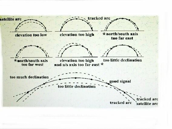

If so I would start from the beginning again by motoring to "0" re-peak your signal on your true south satellite and double check your latitude and Longitude are set correctly in the antenna setup screen.
