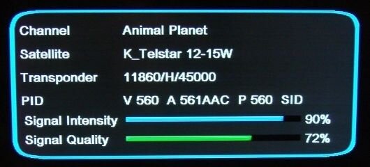

I was wondering why my microHD would not receive any signal quality for the 45000 SR tps on 15W. So I swapped back my S9. Sure enough, those tps are the strongest signals on this satellite.
Is there a known problem with the microHD receiving higher SR? I get zero quality on these tps.
Maybe there is a known issue now then. microHD receives zero quality while S9 is showing 75% quality on 45000 SR scrambled signals on 15W. I notice it takes the S9 a few seconds before it shows quality. It never is this slow on slower SR. Anything I can try in order to get the microHD to see quality on these scrambled signals? This is purely an academic exercise since the scrambled signals are of no interest anyway.

I am bumping this thread again now since I've had to dig my Openbox S9 out of the basement and re-install this old receiver in my viewing area. My microHD can no longer serve me exclusively. microHD cannot receive any of the 9 SR 45000 ITC channels on 15W. In other words, microHD cannot receive most of the channels on 15W but the S9 can. That's a problem worthy of attention. I have a fixed dish on 15W now and I receive it well (SQ70%), but I don't have capability to record and submit any of its signals for analysis.
