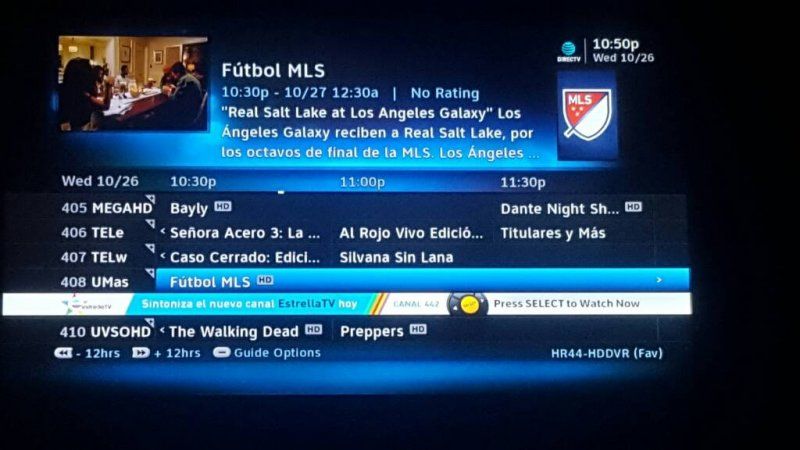

Unimas 408 is, and always has been, on the 119 satellite so you need the 5 LNB dish to receive it, in HD or SD. Local Unimas (if there is one in Maine) will be on the SL3 dish.
It's there, I promise you! Is streaming it an option for you?

I should also mention that I believe that Unimas is one of the 119 channels in the traditional Directv English packages so perhaps a LNB swap is in order. There are a few of these such channels. Unimas has a lot of MLS coverage, as it appears you are aware.
