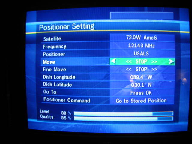

Okay.. this is what I have, how do I save the position? USALS is off for me, way off...maybe 10 degrees.
EDIT: Nevermind, I rooted around and found it.....I am a doofus...working on getting the sats all stored in...I got ONE so far...
USALS is broken on this receiver too. In entered it just like I have it in my Coolsat 5000 and it will not hit ANY satellite. I tried to recalibrate it on AMC6 then go west satellite by satellite...never hit a one. Have to do it manually.
It also will NOT switch my disecq switch. I took it out of the loop and the receiver works fine. Put it back in, no signal. grrrrrrr......
