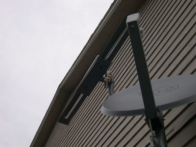

Help ID this antenna...
Hey all... This is the antenna that the installer put on... I wasn't home when they did it and my wife doesn't remember...
I'm pretty sure it needs power from the STB since when I pluged it directly to my TV's tuner... I could only get 1 or 2 channels.
Question is what antenna is it and what power supply (injector?) do I need?
The antenna was a small black W on the bottom.
Help is appreciated... I know I could use the STB, but my TV has a tuner and can get the show data OTA.
Thanks!
Thanks!
:confused:
That looks to be the Winegard Sensar III. Below is a link to their website. They have all of the technical specs and accessories listed. The part number that you will need is PS-9370 power supply.
http://www.winegard.com/offair/sensar.htm
