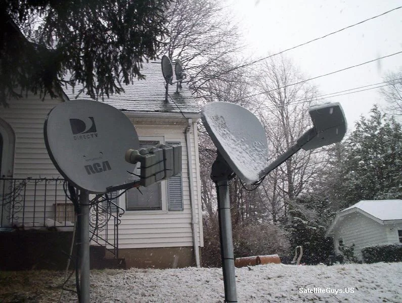

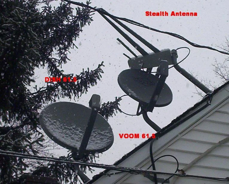

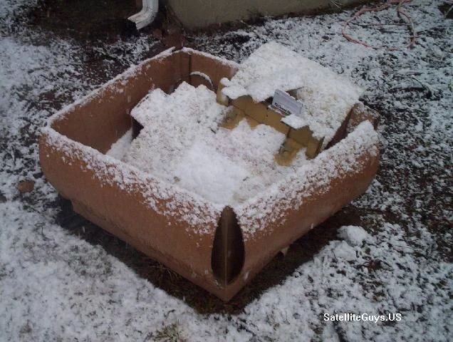

Ok I am all installed! I will do a full writeup later, but for now the guys in chat wanted pictures...
So Here you go!
Note the big BOX on the ground, that was the garbage left behind by the installers. (grr)

K4LK said:
It looks like they mounted a support arm on the front of the Stealth?
Yeah, whats with that? Shouldn't it be mounted to the Dish arm/assembly?
