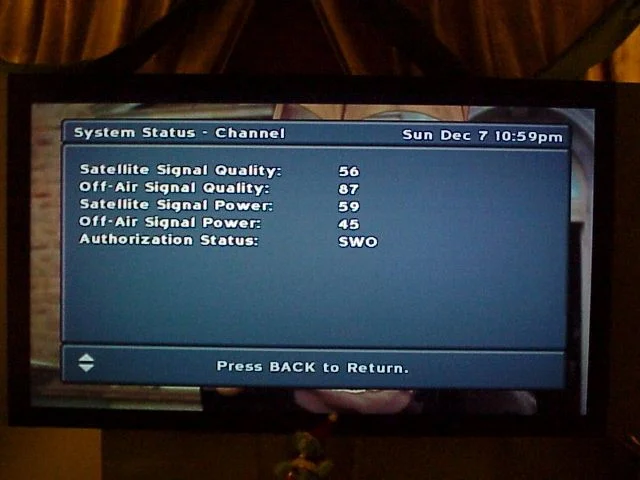

Ok. It might be a mapping problem. Do you see ABC on the PG at all? You must be using a displexer, not a multiswitch. How is your satellite strenght and satellite signal quality? How is the strenght of your OTA and signal quality of the OTA?
It should look like this:

ABC is on the PG. I can't check my signal strength right now. I'll do that when I get home.
The installer said that the signal strenght was about 30. He said that 30 was normal for my area (zip code 76137). I'm not sure he new what he was talking about but my Voom signals seem to come in pretty good.
The installer said that the scale was different than for DirecTV. I know that with a DirecTV signal strength of 30 on my e86 my picture would freeze and pixate real bad.
The splitter they installed works the same as a diplexer but the installers were calling it a multiswitch. It has two satellite inputs, one antenna input and two outputs. They installed a module on the back of the Voom receiver that I believe is the receiver end diplexer.

Ok this strenght of 30 does not sound good to me. All the people that got installed have reported a strenght of 55-70 after the download without a diplexer. Try it but if you lose the satellite signal it is probably due to the diplexer. Most people I know have opted out of installing a diplexer because it lowers your satellite signal strength. Is there a way you can get two direct lines to the receiver without using the diplexer?

I checked out my signal strength and, as I suspected, my installer didn't know what he was talking about. My satellite signal strenght is about 65.
My OTA signal strength is perplexing though. On the local signals that come in the signal quality is about 70, but, on the ABC channel the quality is only about 14-20. I am trying to find out if there is a problem with the trasmitter.
