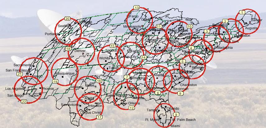

I was researching Voom articles and found the following excerpt in the October 1st issue of The Mercury News:
"Analysts also have raised the question of how much reach Cablevision's single satellite, Rainbow 1, can have. Although the company said the Rainbow can reach across the contiguous United States, experts contend that the satellite will have difficulty reaching the West Coast, particularly the Northwest, from its orbital position."
Has anyone signed up for Voom from the Pacific Northwest area? Can anyone verify or refute this information?
Thanks!
take a look at this map as well.
I like that nice big circle around the Seattle area! Thanks Sean. I'd still like to hear anyone's opinion from the Pacific Northwest of Voom coverage. Maybe I'll be the first?
