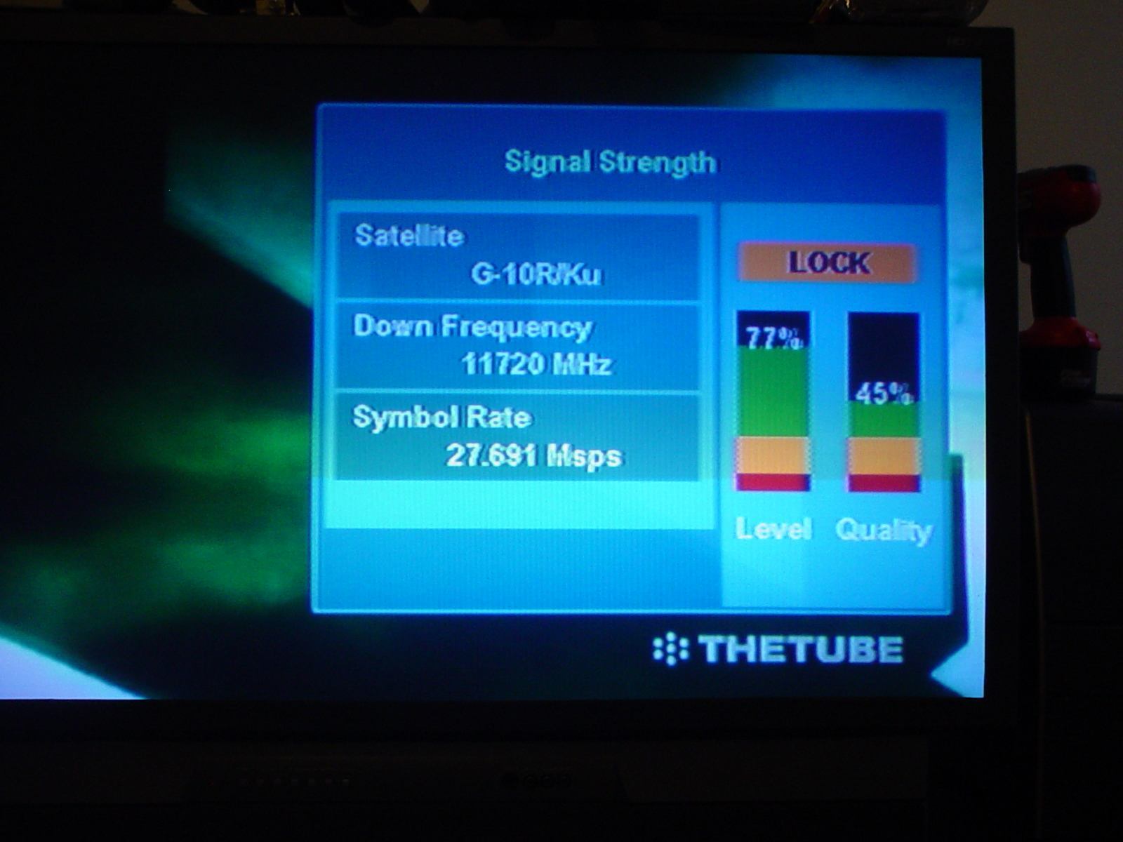

My Invacom showed up yesterday, threw that on the F* 80P, and the DMSI SG2100. did some fine tuning on the motor setup, now I am getting high 40s on G10R, and I am tracking the arc just fine from G10 to PAS9..

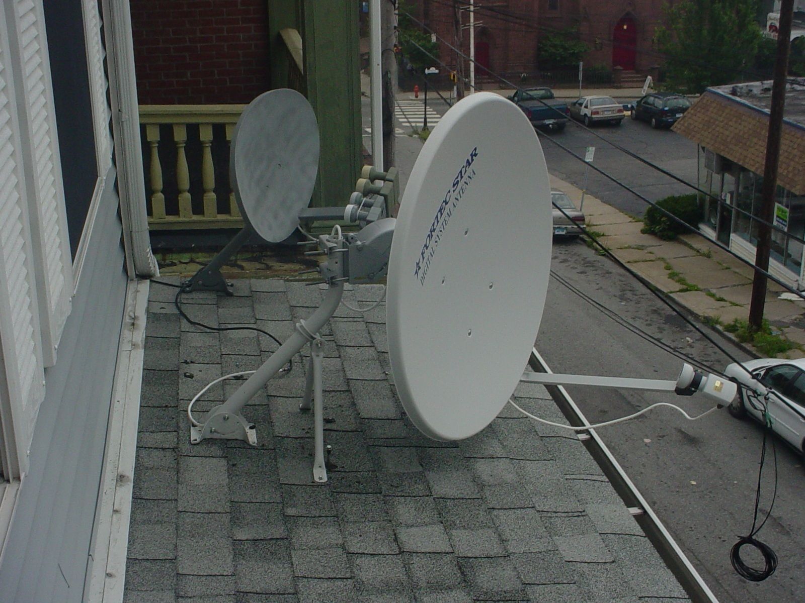

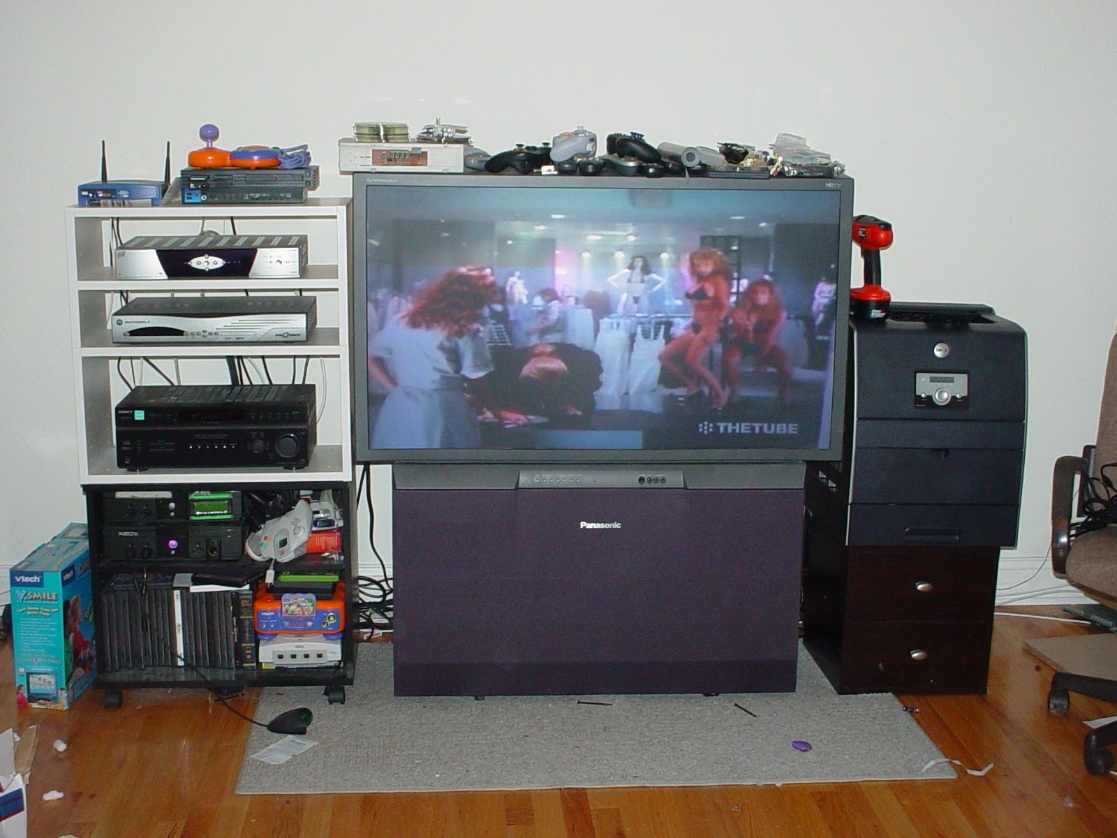

Ok.. it looks like I have everything together.. Moved some stuff, and rewired my living room.. Replaced my 80P with a 90P.. I have some slight fine tuning to do, but all in all, its together.
Photos follow:

The Laser printer is there, because its the most central location in the house.. when you live with 3 other computer geeks, you cant really put the printer in any one room ;) and of course, its the Dell 3100cn, which we bought for $329 shipped (cant go wrong with that!)
