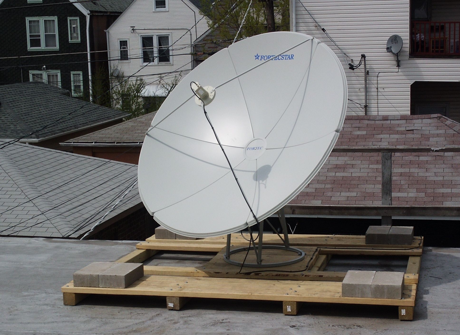

UPDATE 4/17
Today I assembled the platform and put the dish together, took most of the day. Next I need to put the struts on and feedhorn LNBF and run the wires. Then will be alignment day and setting up the dish through out the house's antenna system.

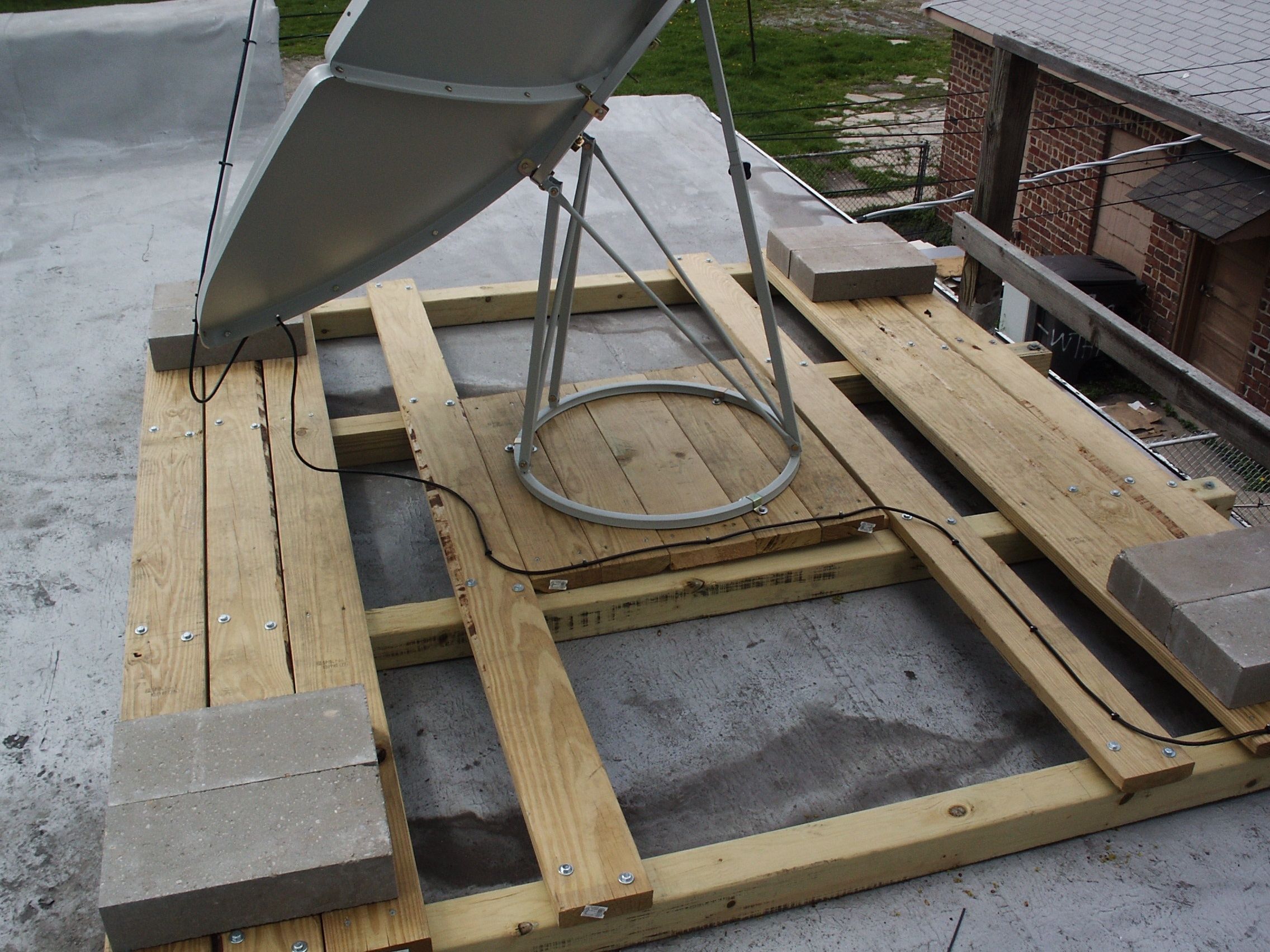

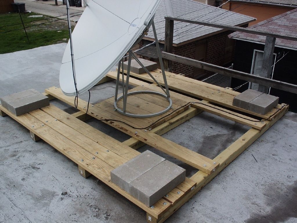

The funny part is the base we built for the flat roof is built like a tank. :D It uses 4, 4"x4"x 8' 's -- 6, 2"x6"x 8' 's and a platform with four strips from a 2x6 and one from a 2x10 for the ring in the middle that we compensated for the pitch of the flat roof so the platform is plumb. (all pressure treated lumber is used on the whole thing) This monster could easily support a 10 foot dish. I tried rocking the dish the other day and it was like it was attached to concrete. Im still putting 4 lag bolts through the 4x4's to the sill of his roof in the back and we have 8 cinder blocks on the platform. When I get a chance I'll scan the plans for the base (I have to use my other computer for that) and post them up here. I hope to get some pictures when it's all done also for everyone to see.

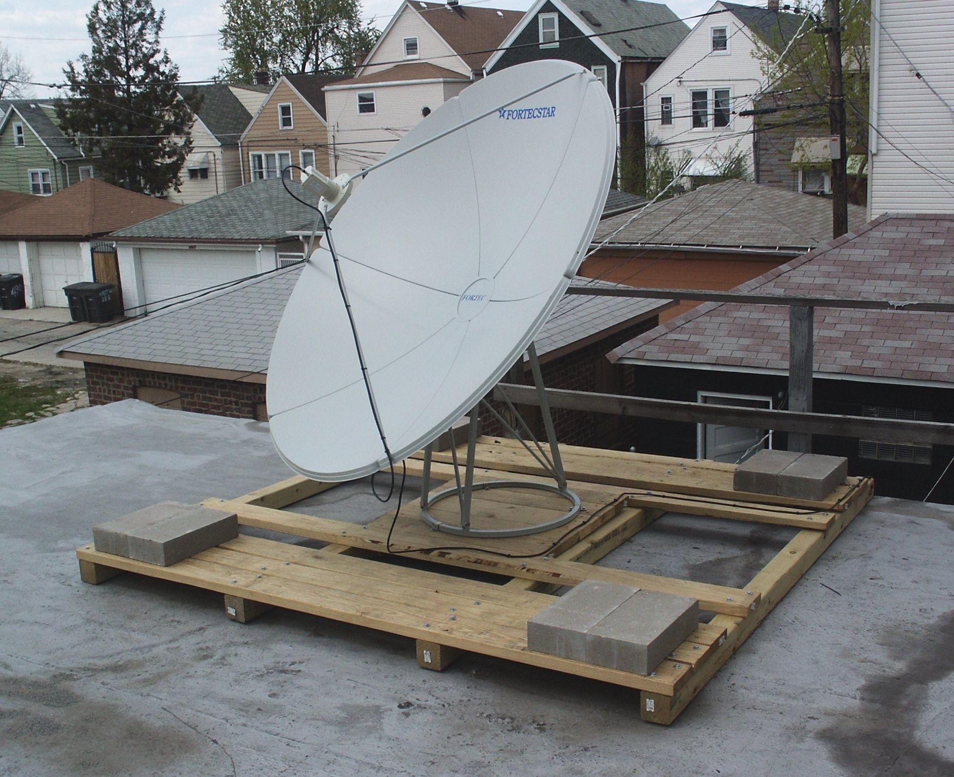

UPDATE 4/24
Well just got home. Today I put the struts & feedhorn on. Ran the coax and did some work inside on the guys new Smatv system. I will be injecting the 410 on channel 4 with the OTA antenna to feed 6 tv's.
I cut the guys cable line pulled it out and used the hole to feed the dish's coax. Adios cable tv for good. :D They disconnected him yesterday. :up
I did some static angle adjustments so the dish is in the ballpark for W5 already.
Next week I will align it and install the 410. It's going to rain the next 4 days so it will probably be done later next week.

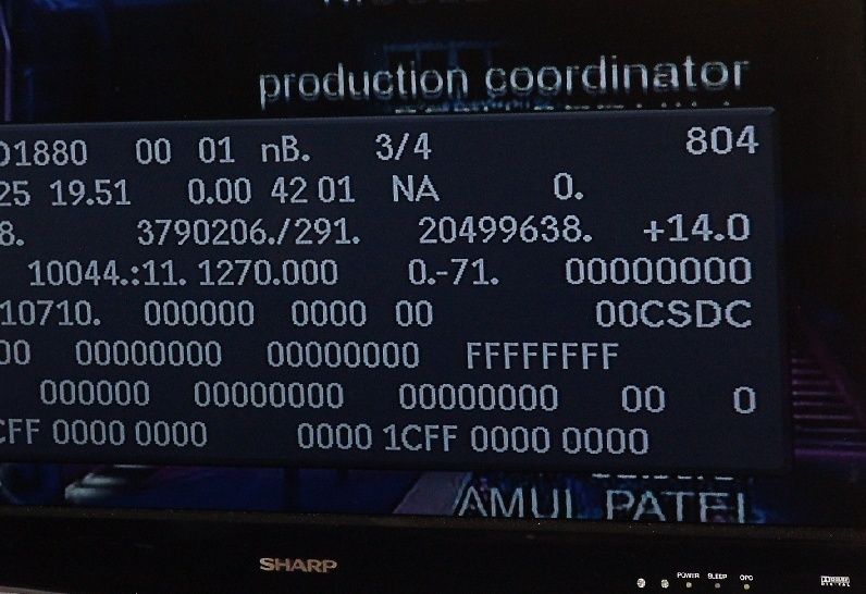

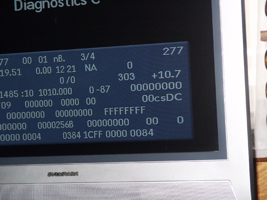

Its done :) turned out real good. I made my static adjustments and when I powered on to the arc I had a picture and a +4.0 ebno right away. It is so cool to just set angles and get a digital lock and picture from the get go. Then I peaked the azimuth and elevation and skew. The feedhorn liked the F/D of .36 the best and the LNBF ended up at about 4 o clock. I ended up with a +10.7 ebno. Pretty darn good for a 6 footer. I tweaked every last drop of signal out of that thing
Pictures are attached of the dish install, the base and the clients 10.7 ebno. I enclosed last a picture of my W5 ebno on my 12 foot when I got home +14.0.

Glad it worked out so smoothly. I really like the frame that was built to bolt the dish to. I had an idea on what it was but the pics make it so much better :)

I was looking forward to the pics of the base. Good job. WE can use this as a guide for others wanting to do similar installs.
