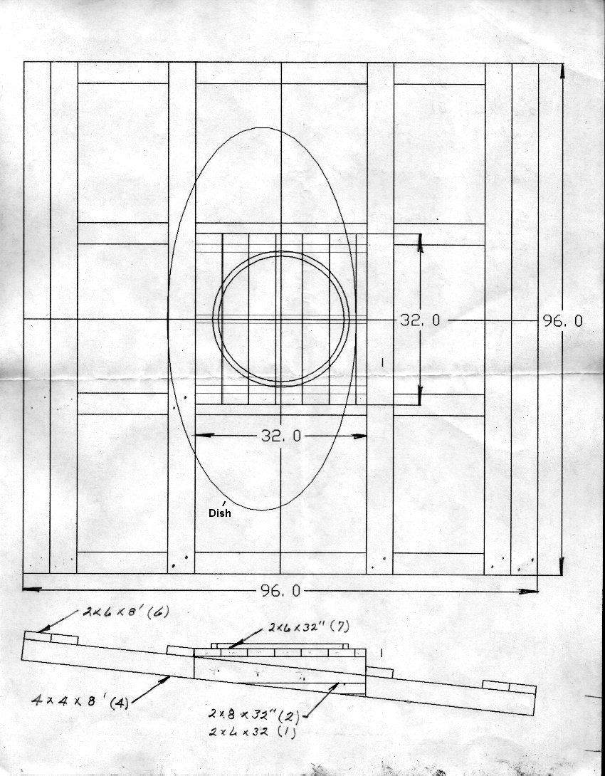

Here is the original base plans my neighbor made. I added 2 more 2x8's from the original plans shown here.
Feel free to build and enjoy.
Note: The center platform pitch may have to be adjusted for your install. This roof was pitched for water drain off and I wanted the platform plum so we compensated for the roof pitch.

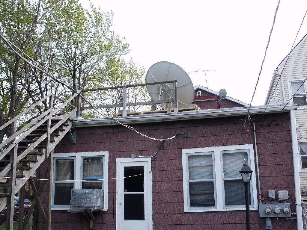

It was fun. Now I have to put a new tv antenna and coax up for him for his OTA locals. I just ordered a Winegard today but it's on back order to the 22nd. His 38 year old tv antenna isn't cutting it. When Im done he will have perfect OTA and satellite at every tv in his house. Just like my house is set up :D His own cable system so to speak :)

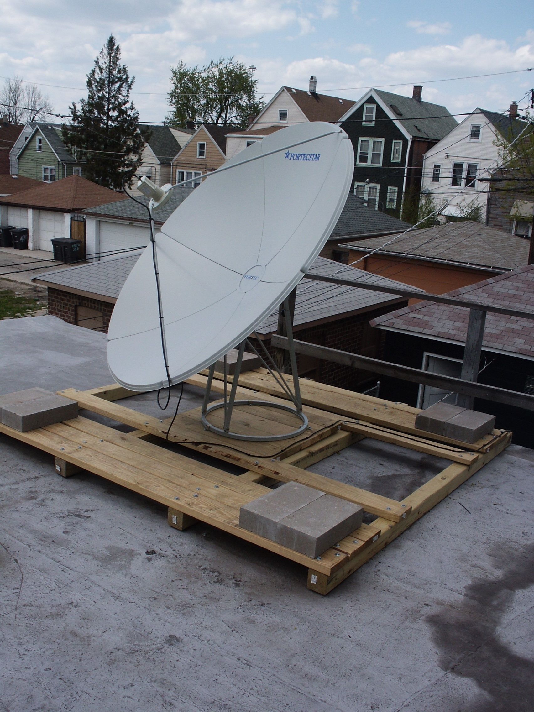

Here's 2 more pictures a full size dish & base and a shot from the ground.

Looking at the pictures I have to question is the dish secure enough if a bad storm blows through? A little extra support tieing the dish to the platform and then some cables tieing the platform to the roof will prevent the dish being blown off the roof in a violent storm.
Larry

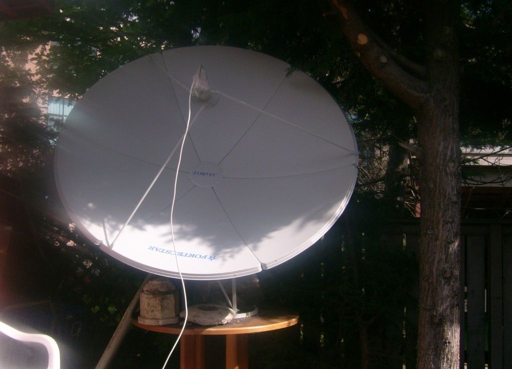

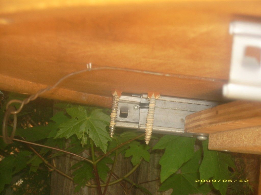

If those brackets are bolted down it will hold. When I had my 6 footer on the table and a strong wind flipped the dish AND the table :eek: and it was bolted with long screws, washers & nuts
I drilled holes on the platform and put stainless steel nuts & bolts through the clamps & holes. The base can support a 10 foot dish easy, I even have the 4x4's anchored in the back to his roof sill with lag bolts. That puppy ain't going anywhere :D
Glad to hear that. Those bricks did not look sufficient to hold it in place. With the lags it will not go anywhere.
You can put as many bricks or cinder blocks as you want on it. The mount itself is heavy, it took 2 people to rock n slide it about a foot to get it in position so I could lag bolt the 4x4's. Even without any blocks it would be pretty hard to move by the wind. May need a twister :D
I steal Ice's idea to bolt my foot on an unused old table, and it's been there stable for a month now...but windy season is not here yet...cross my fingers:cool:...
But my table is against the tree, so it won't flipped and hit the ground like Ice's pool 6ft:D
