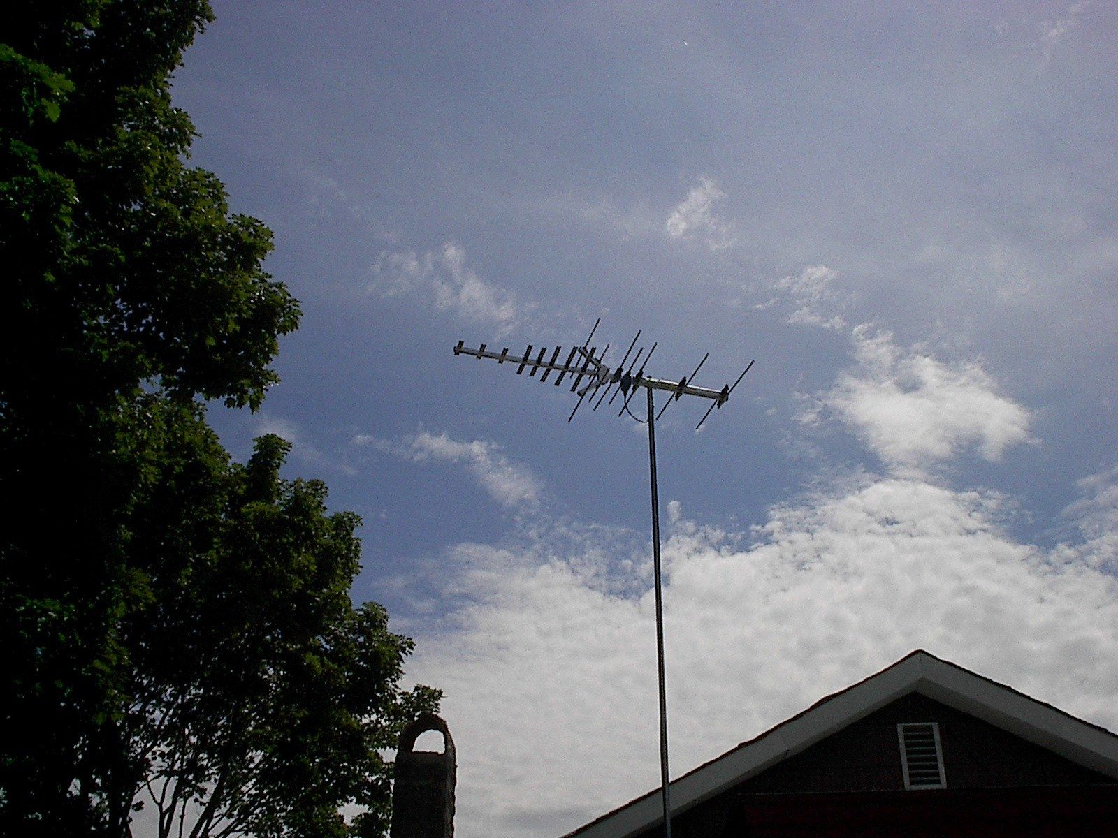

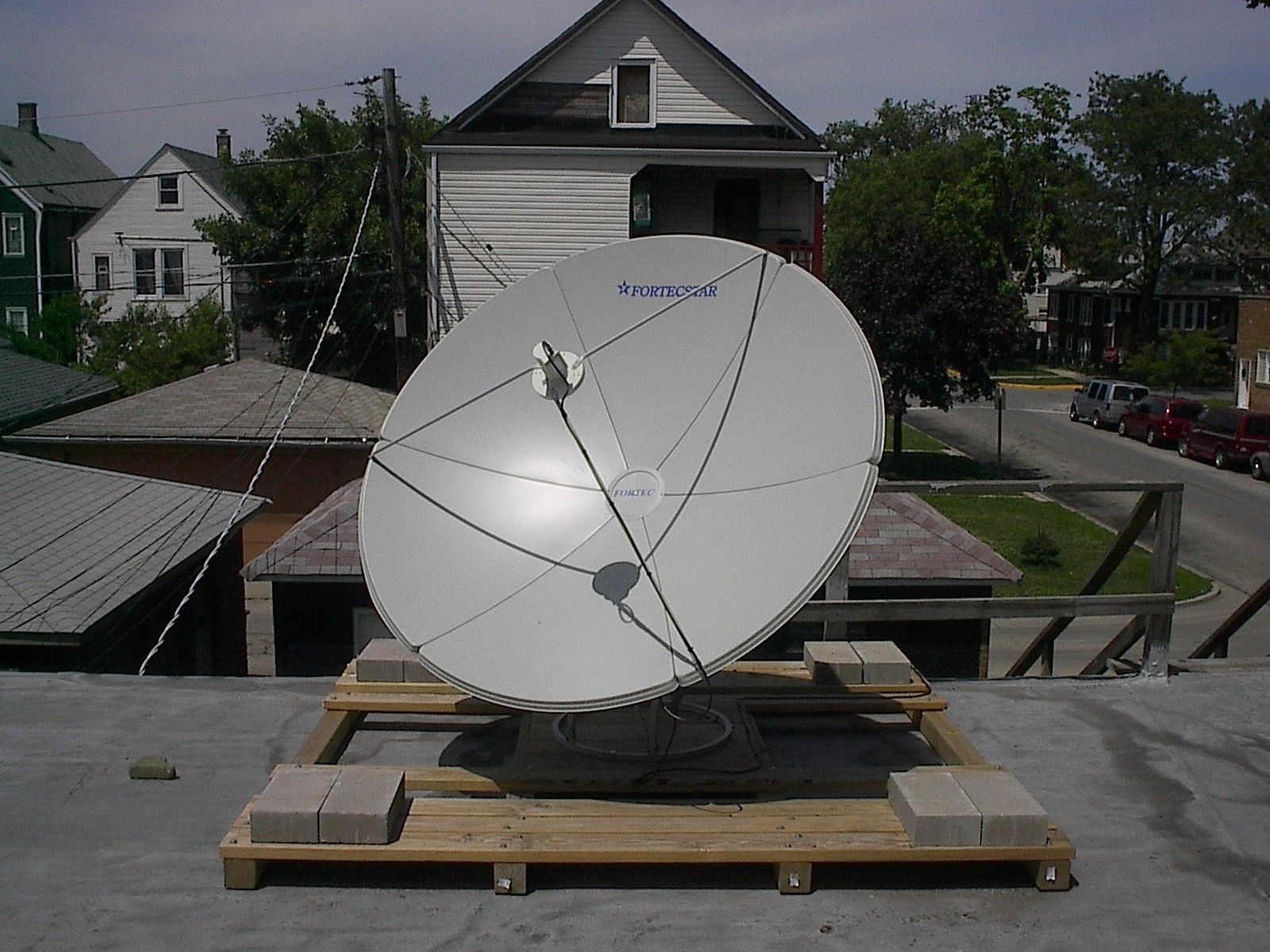

UPDATE: Finally finished the whole job.
UPDATE 6/26/2009
I finally replaced the clients OTA TV antenna (New mounts, cable etc) and added another channel to his in house SMATV system. So now his Dish is on Channel 4 and we put a OTA converter box on 16 so he can watch either or on any tv in the house.
I put up a Winegard 7694PHD, The new antenna's tuned for the digital spectrum Ch 7-51 It worked out nice.
I checked out my dish install and everything has been holding up well. We also were discussing modifying the 6 foot Fortec to a polormount, tossing up an actuator and getting him a 4DTV. He now has his feet wet and is looking for more channels (Wifey wants the food network and travel channel) So he will need to get to C3 and C4 for those. So possibly a modification may be coming up in the future.
A note to all Sat Guy members. If you have an extra, or see a good 4DTV for sale let me know because he will be looking for one soon. Just post the details here and I can let him know.
Finished Pictures
These show the dish and the Winegard OTA antenna I put up for the finished job.
If you look to the left (on the dish pic) there is the spot I marked if the guy ever goes to make this thing movable. That's where the dish will move to for a polar mount install to see the whole arc.
I wouldn't mind doing these for people every month it was allot of fun. :D Wouldn't mind the cash either. :)
