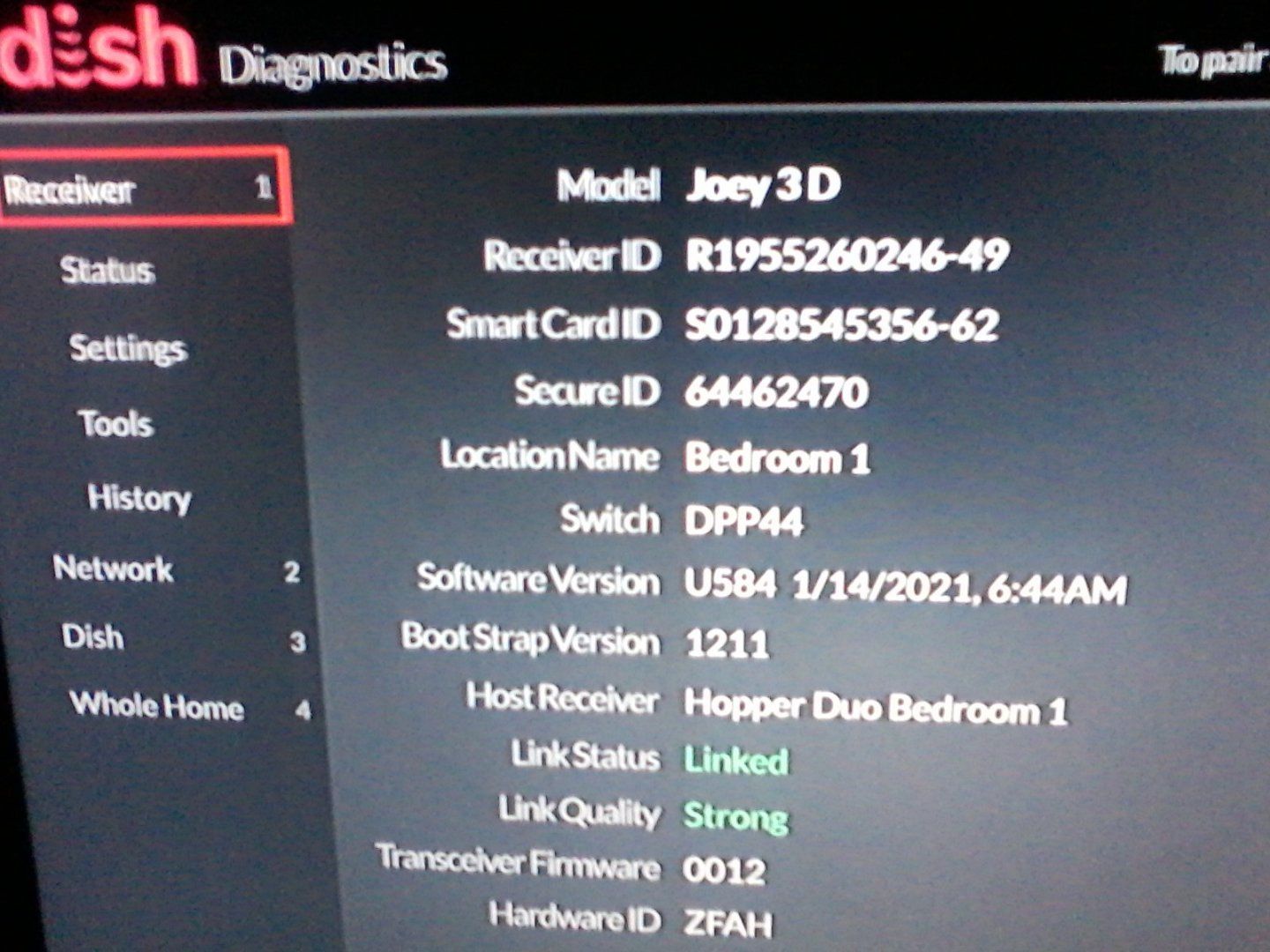

Actually, I am back to the same "D" (DVR-disabled) issue that I have been reporting throughout this thread. Sigh! This had been working properly with the leased Hopper Duo, and the previous software version. I hooked up my purchased Hopper Duo in place of the leased one, linked the Joey 3, and downloaded the latest software. This is the result. No DVR functions on either the Hopper Duo or Joey 3. It looks like I will be going back to the ViP211k for all of my DVR needs from now on. I am not going to waste my time calling a "special" 888 phone number, just to add DVR functionality every time I want to activate my Hopper Duo and Joey 3. This Joey 3 will soon be listed for sale in the Classifieds section here, where I have already listed the Hopper Duo.
