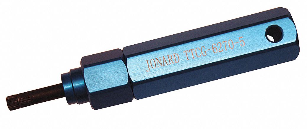

The third most common, which are no longer being installed here but which linger, are the ones with long, hexagonal bodies that require a more expensive tool to remove. They have a cam tip that is on an eccentric shaft, and, as explained in post #38 above, one twists the handle to tighten it for removal.
It is the one referred to as a a cam tool...........couldn't get any pics to copy...
23Z378_AS01
Here is that cam tool on ebay for $22.50 including shipping. http://www.ebay.com/itm/NS6270-1-GI...D-TOOL-CABLE-TV-ACCESS-FREE-/160981283749?pt=
Many cable technicians stick those security blocks on satellite TV ports of distribution components that are not in any way connected to the cable distribution, just to be nuisances, which is why I always carry all three removal tools.
There was another old security sleeve that is incompatible with the industry standard sleeve removal tool that I came across when servicing some really old PPV boxes in Baltimore that have been installed by Hotel Movie Network of Mesa, Arizona. Fortunately, they only put them on the guest boxes, which had become obsolete, so I would just cit the coax and install a new F connector. I eventually found the removal tool online, but never bought one because I was sure I'd never need it.

+ AntAltMike got the correct pics to print...cool! & thanks.
