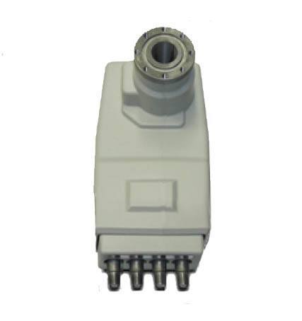

I picked up a 1.5 m offset dish. I want to replace the original tx/rx electronics with a decent c120 mount lnb using the original feed. What works good and is still available?

thats what i use with my 4ft channel master,and works great
I use the old Hughes C120 flange LNB's....they used to be still available on eBay. I think I still have an Invacom SNF-031 that I could part with...and I could probably dig up a Hughes as well...
The LNBs off a DishNetwork SuperDish (obsolete by now) has the c120 flange.

This link takes you right to some pictures of the Dish FSS bandstacked LNB.
The one to the right is courtesy Tron, who's posted quite a lot about 'em.
The middle picture is from Global-CM.
