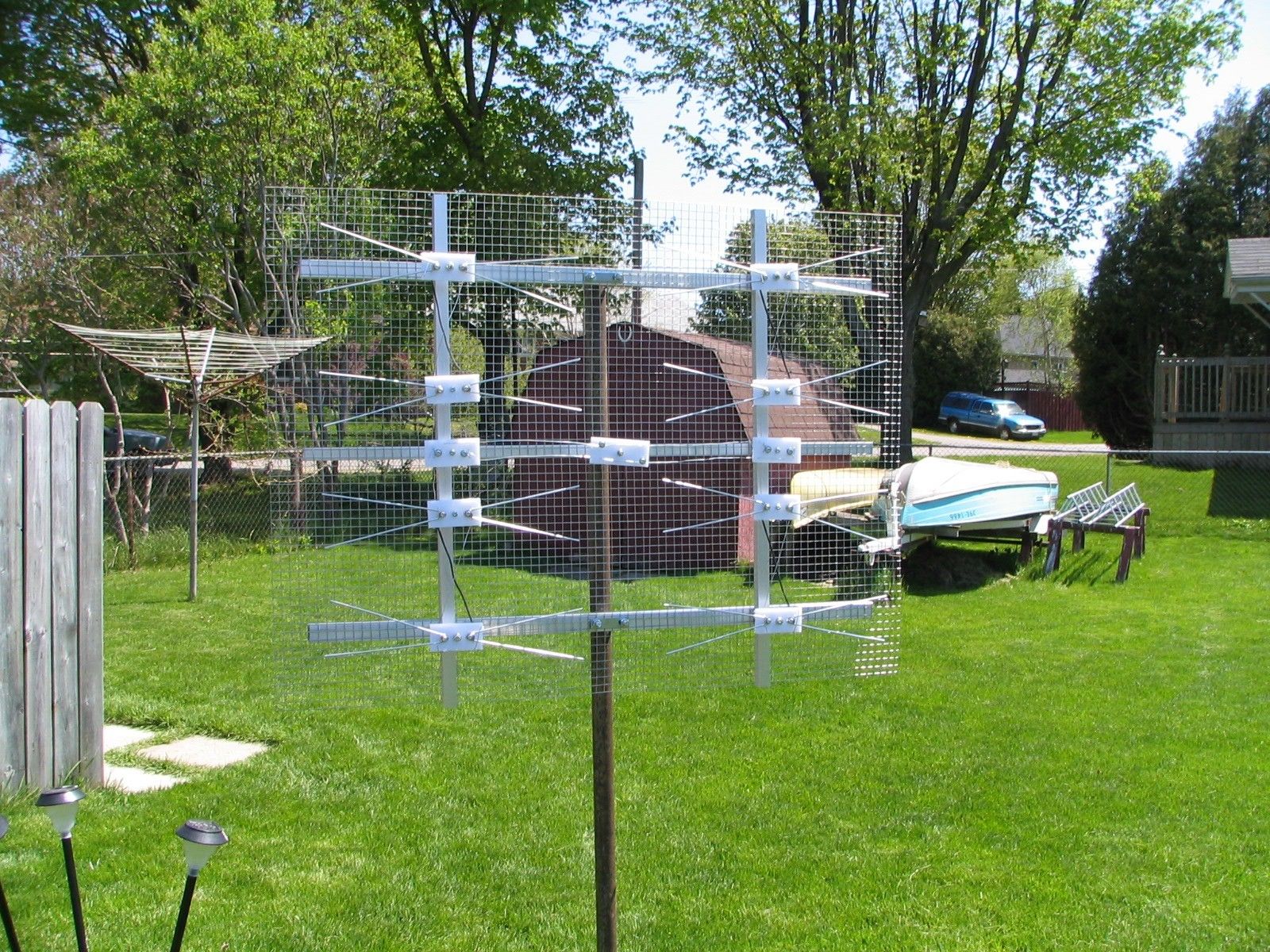

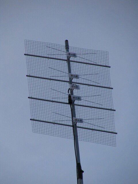

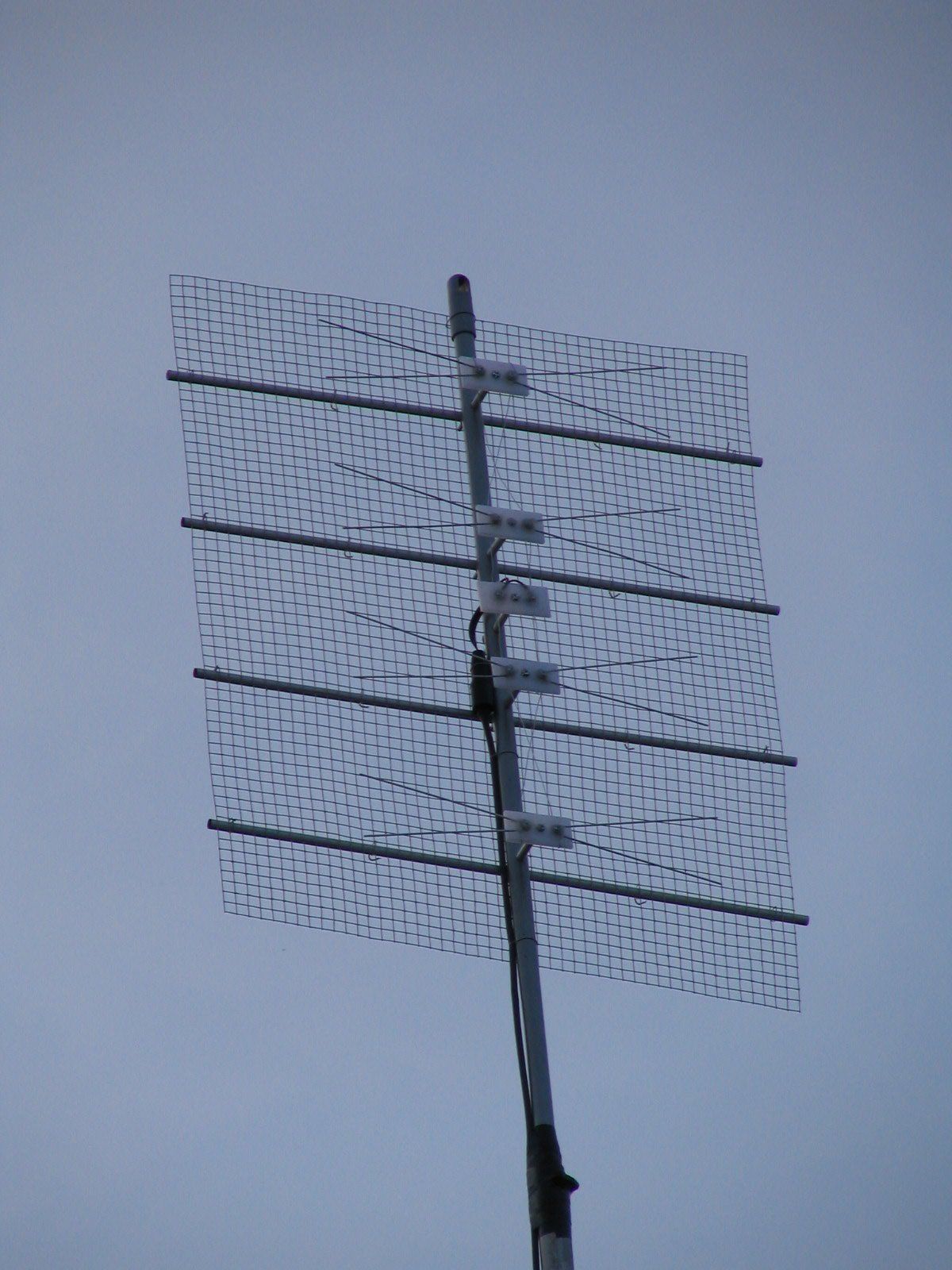

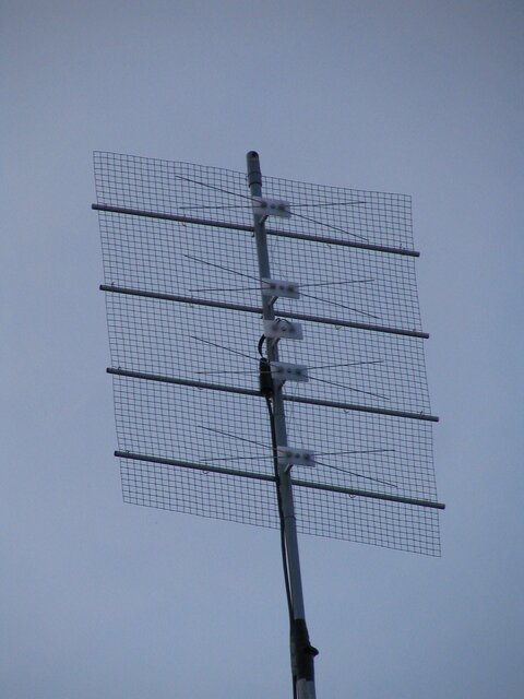

Heres a couple I have made. The 4 bay bow tie is currently in use for my RTN recording everyday. The 8 bay bow tie was used up untill a couple of weeks ago when I replaced it with a XG91. There was only a very small improvement with the new antenna. I'm 93 miles from the transmitter. (with a poor line of sight)
