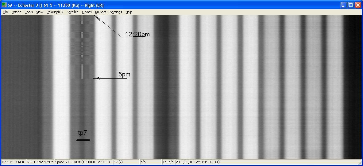

OK, finally we have real evidence - spectrograms by Hokie. Thanks man.
So, some SB on tp1 and tp3 at East Coast lites on.
I don't see anything unusual for routing 110W mux into testing tpns at 61.5W - I got similar picture when 157W has been tested a couple years ago.
Perhaps on West Coast they play with tp7 ? But the signal curve ( you saw it) is distrophical :(.
There is new 'skyscan' from 12:20pm to 22:30pm
(timeline from top to bottom, tpns - from left to right 1-31, black - no signal, white - high level)
- you can see a few attempts to make works tp7 , but so far there is no good result.
