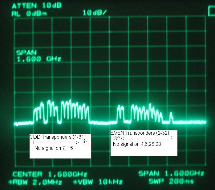

What signals can you "see" at 61.5?
Sorry guys, I'm very skeptical - only two persons one from IL other from SC - nobody else and that is huge distance for one SB.
We need to have our resident on East Coast with Spectrum Analyzer !

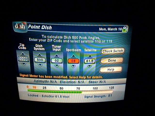

Ok, P Smith. I hooked my receiver straight to the 61.5 satellite. Here are results: Locked Echostar 61.5 tp 3 changed to spotbeam, signal 92. A lock is a lock is a lock. A green line is a green line is a green line. The receiver knows what it is seeing. And I live in NC, not SC almost in the heart of spotbeam 5.
That's third location, but again SA spectrogram would show real signal - a receiver could adjust frequency to next tp.
Or if someone with Sky-Walker USB card or DVBTech device could lock to the tp7 and using TSReader will post screen-shot.
How do you tell it changed to spotbeam?

I am in NC. I had to mow the lawn when I got home, so I haven't been able to check the spotbeam again. Watching Charlie Chat now. Will post the screenshot when it is over.
Ted
Got bored with chat. See attached screenshot. Signal strength is lower than yesterday. Perhaps it is cross-talk afterall?
I'm getting good signal strength on transponder 1 as well, and it clearly states "wrong satellite Echo 110" or something like that. Now that's crosstalk. I also get a highly variable signal stength on 3. I see it anywhere from 30 to 60, new scale.
When we get a lock on 61.5, I cannot imagine how it's crosstalk from another satellite. Now I suppose it could be crosstalk from a different transponder on 61.5, which also explains why brownover could still see "spotbeam" when directly connected. But then why don't we see "spotbeam" on any other transponders?
I think we've got a spot illuminating our territory, and the others are just green with envy. ;)
