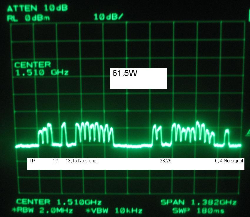

TP 7,9,13,15 disappeared here in the east.

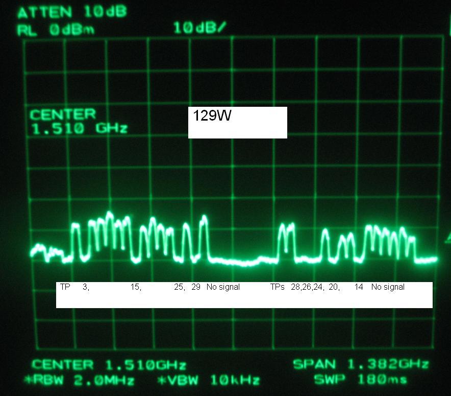

Edit: Added spectrums from 61.5 and 129 for comparisions.

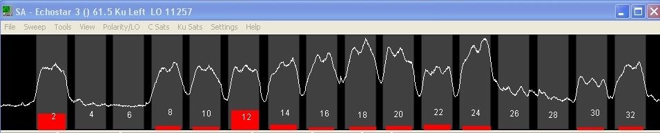

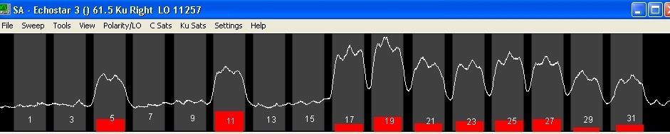

Here are the latest BLSA scans for Echostar 61.5 from San Jose, CA.
I previously had no signal on Transponders 1, 3, 4, 6, 7, 15, 26, and 28. Now, Transponders 9 and 13 have no signals also.
