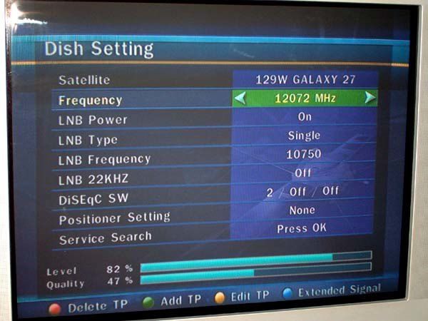

Here's a screen shot of the Visionsat. I have this bird (G27) zeroed in on my 4DTV. I designated a spare (4DTV) Ku to 129.0W (H). I used a User definition (Visionsat) to create the Galaxy 27 one you see on the screen. You can see all the settings. The diseqc switch setting of "2" is for Ku. Can someone tell me what it's seeing? I get this quality signal reading at 12072 and 12075Mhz. I looked through Lyngsat for these freqs on G27 and the birds on either side. They aren't listed. What is it?

Well I tried to manually scan in White Springs about 25 times, (Signal Quality was only around 10 to 25 at max) but just like 123.0W no luck with Ku Band on the far west satellites, but C Band is okay to the far West, guess I need to do more adjusting.
Same thing here. It used to come in at about 95 quality, but now average quality is about 13, which is worse than what I used to get on a Dish 500 with a linear LNB held on with scotch tape (I got up to 55 with that!) I think something must be wrong with White Springs' uplink or the transponder itself.
The three 30.0 Msps data transponders (11780H, 12100H, 12080V) come in at 60-70 quality, even though they are 7/8 FEC. You might want to use one of those to adjust the dish.
