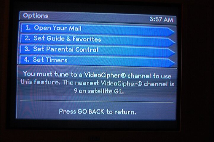

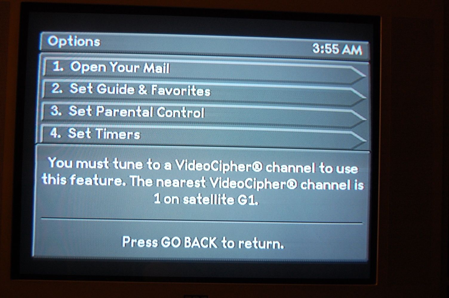

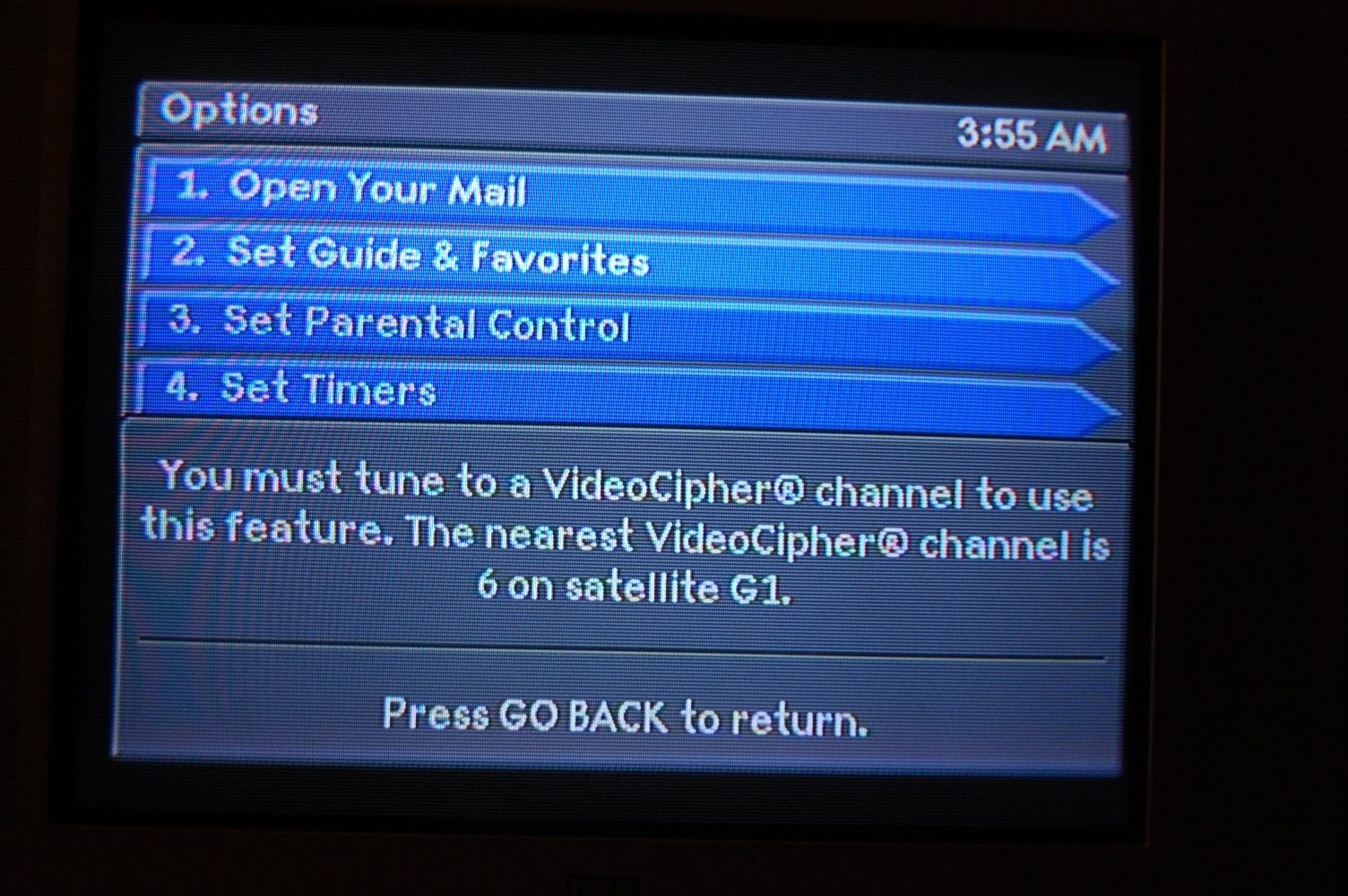

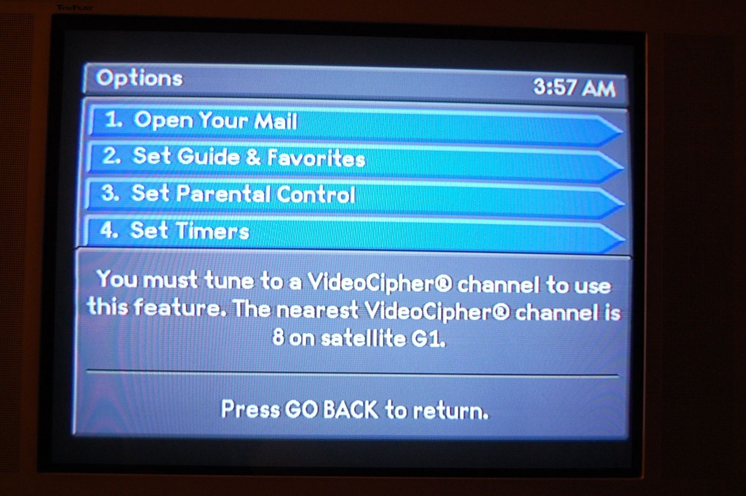

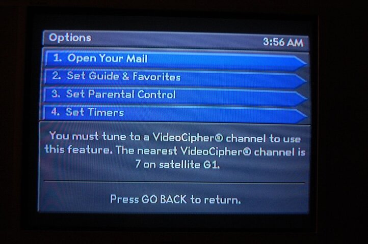

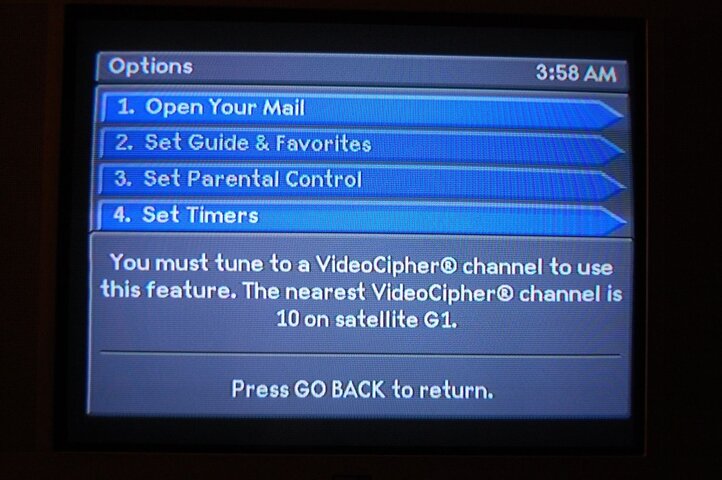

Although you are far more experienced at this Euro, I know what it told me to do. Since you have called me to question in front of who knows how many people, I have gone back and photographed the first part of the series of a dozen or more channels it sent me to, in search of my VideoCipher number.
In photo 0001, I am on channel G1 3, and you can see the screen instruction telling me to go to G1 channel 1.
Photo 0002, G1 1 tells me to go to G1 6.
Photo 0003, G1 6 tells me to go to G1 7.
Photo 0004, G1 7 tells me to go to G1 8.
Photo 0005, G1 8 tells me to go to G1 9.
Photo 0006, G1 9 tells me to go to G1 10...
and on and on. As I said in my earlier post, I checked a dozen, maybe more, following this procedure that the receiver was doling out to me. And to be even more accurate, I stopped getting up and peeking around at the front of my receiver after the first few times. The DCII light was always on, so I stopped getting up and walking over to it. My receiver is facing the wall because I need to check my polarization wires often, as you can assume from reading my earlier posts.

I get rejected the same way at number 9. I have tried a dozen different channels already... maybe more. And yes, I do have a good DCII light each time.
Which is why the rejection....it wanted the VCII light to be on. Like LAK7 said though, this doesn't matter now since there's no VCII left to sub to.

I see now about the channels. Most everything about a 4DTV including that menu, is outdated, and it's suggesting channels that no longer exist. That's where the communication breakdown on my end occured, because I've never seen that menu. I've always been on a VCII channel if I hit "9"in options. Wait 'till you start looking around the guide and see all the listings for channels that are gone now. And I wasn't calling anyone a liar, you became confused and thought DCII was VCII, no biggie, but that's why I said there was no way, since there's only 3 VCII channels left. Sorry if I ruffled any feathers.
If your dish have been there a while and is aimed like it is supposed to, then you need to redo your settings from your 4DTV receiver.
The dish position on G1 should be around 5000. Your picture show the setting at 6699, WAY off! You need to redo your dish settings, including the east/west limit settings. I remember reading from somewhere online that the dish setting on G1 should be around 5000.
