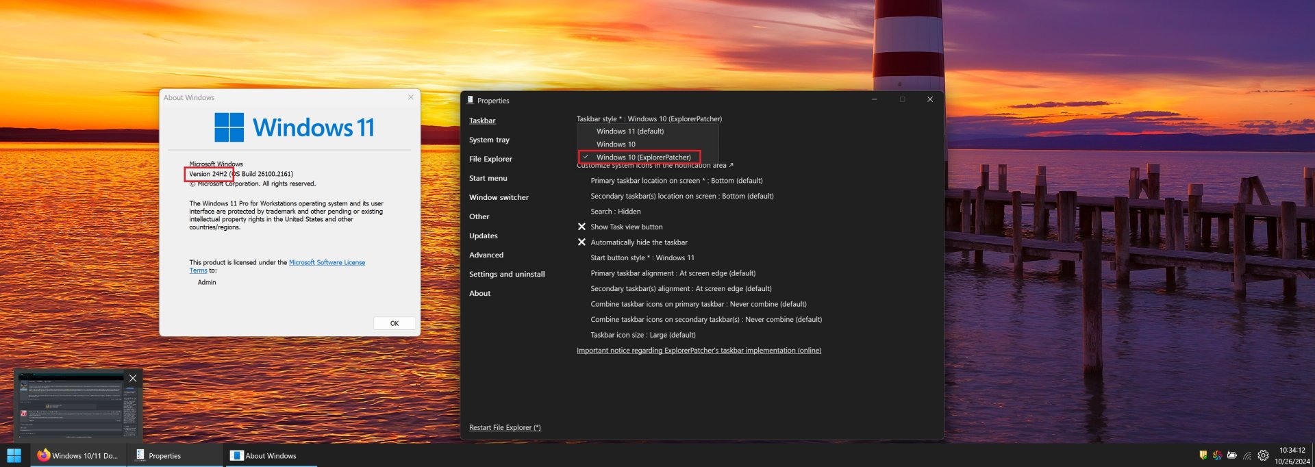

ExplorerPatcher doesn't fully work with 24H2. Most of the features still work, but some, like reverting to Win10 Taskbar are disabled. I did go through privacy settings after upgrading and they were still toggled off. I DID have some Startup programs that needed to be disabled again
The developers came up with their own Windows 10 style taskbar that works for 24H2 and it is virtually indistinguishable from the taskbar Microsoft removed the coding for that ExplorerPatcher enabled. The only thing that I cannot get working is the Windows 10 battery flyout (Windows 7 style does work though), which is not a big deal for me.
Ohh, that must have been added after I installed the app
