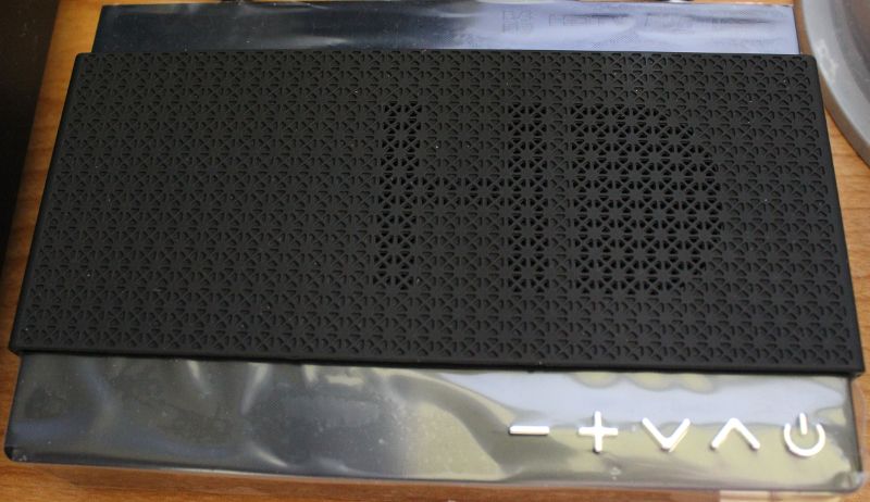

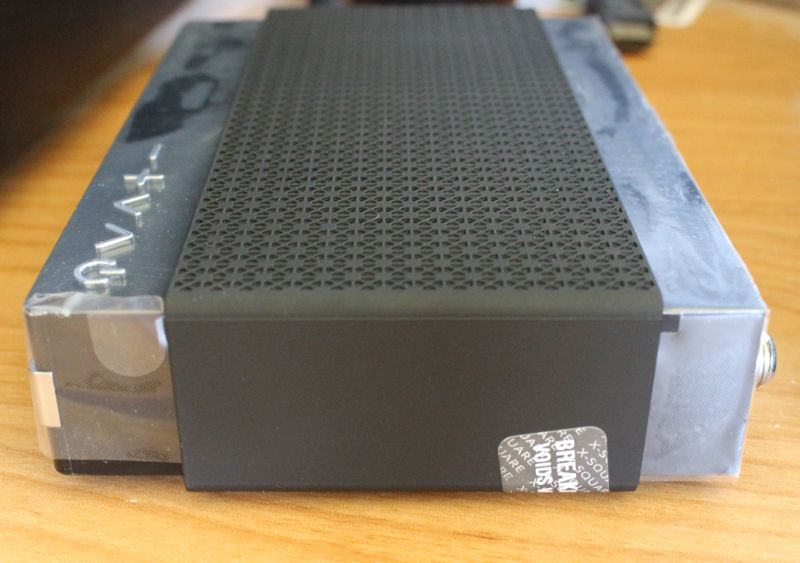

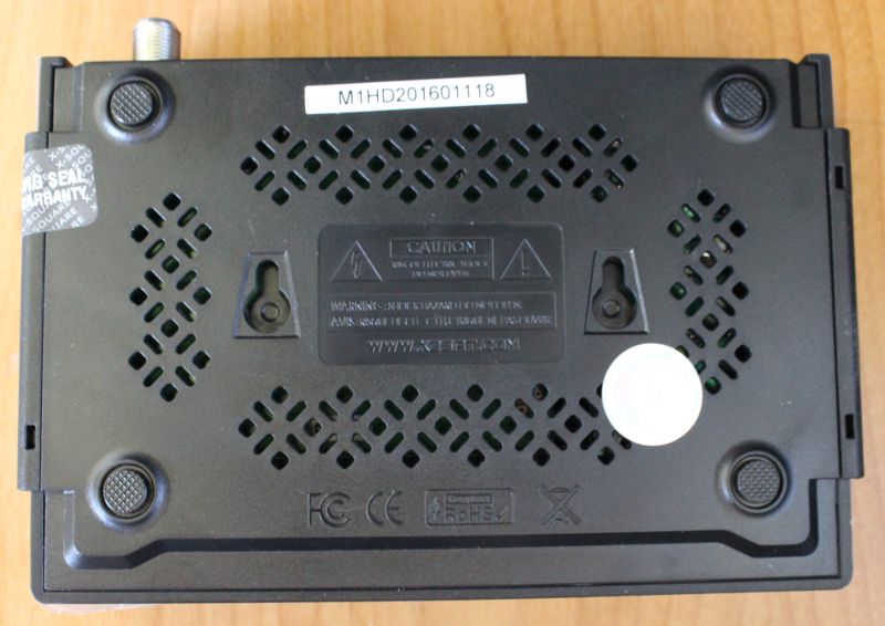

I ordered an X2 M1HD from Amazon about two weeks ago and got a chance to try it this weekend. I connected everything and scanned two sats (which are fixed dishes) without issue. After I figured out how to use the editing interface (move, delete, rename channels) I actually liked it. I sat back and started watching a channel and the receiver turned off by itself then back on again. It continued to do this over and over about every two minutes until I pulled the plug. When I plugged it back in it booted so I manually shut it off with the power button on the receiver. A while later I noticed that it had turned itself back on and began the off/on loop again. The box is hot to the touch (and this is in a room thats only 67° F). I am thinking this is most likely a heat problem as the venting on it is poor. There are a decent number of holes on the bottom but there are no side vents and on the top there is only a small area (roughly only 1/8 of the surface area) that is open where an HD logo is.
I don't know about any heatsink size/placement as I'm likely going to return it and don't want to open it. I saw mention of this rebooting in another thread here. This is twice that I have had problems with an X2 product. A while back I tried an X2 Mini Premium HD only to have it constantly reboot (you couldn't even get to the menus before it would reboot). Apparently some people get lucky with these but from my experience I would avoid them. :(

The new one does get hot, and I watched it go off and turn back on, even in a room at 65 deg. with the unit on a shelf below the TV. I re-positioned it so that there was open space beneath the unit, where the ventilation holes are, and it cooled off and quit cycling on/off. Hopefully, it will run cooler. Electronics really don't like too much heat, shortens their life.

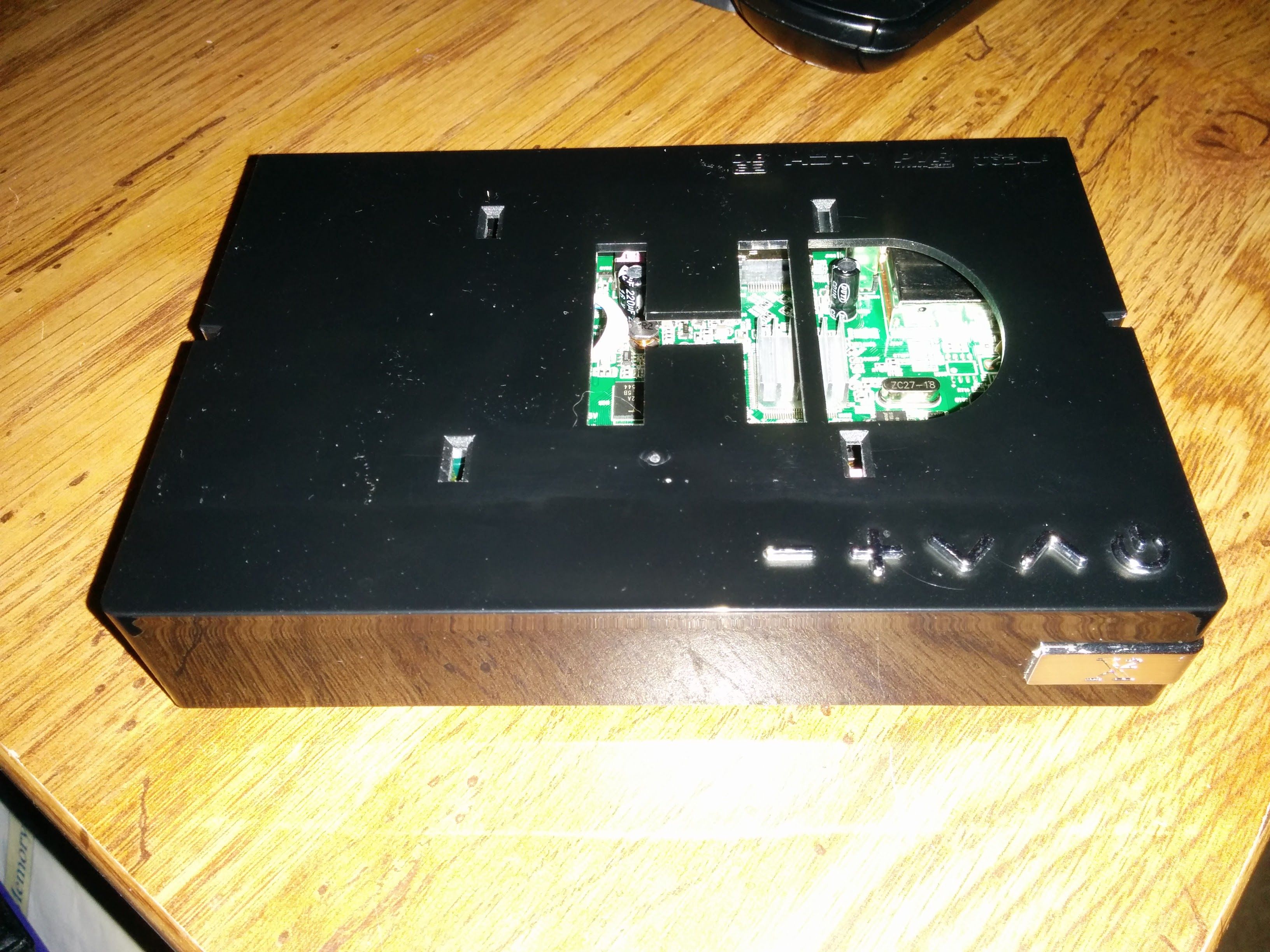

I went ahead and opened mine up. It has a GX6605 chipset, according to it's website. If I look for pictures of other receivers with this chipset, essential the mainboard is the same. I think this is another one of those receivers where companies buy the boards, put them in their own cases, and then put their modified version of the stock software on there.

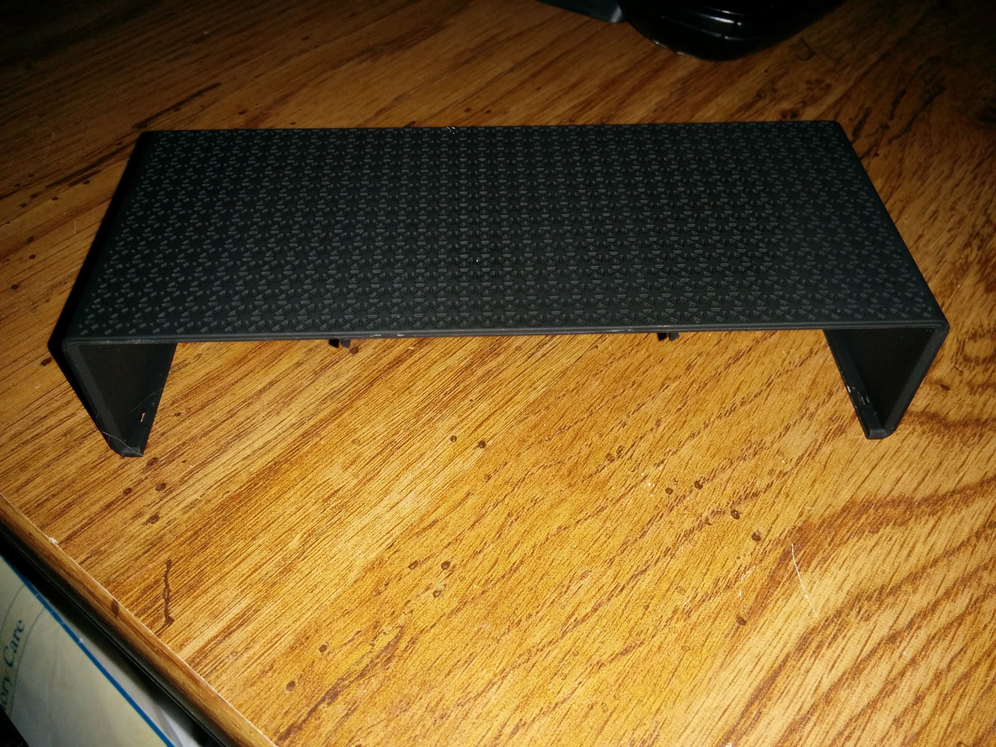

It does have a little room to breathe in the top cover, as it is a plastic mesh near the top of the chipset/heatsink (the area that says "HD"). I decided to take the decorative cover off and leave it -- hopefully this will give more airflow. It still should be opened up a little more above the heatsink, so I'll do that some other time after I see what kind of effect this has.
Reassembled, leaving off the decorative cover:
The decorative cover that I left off:

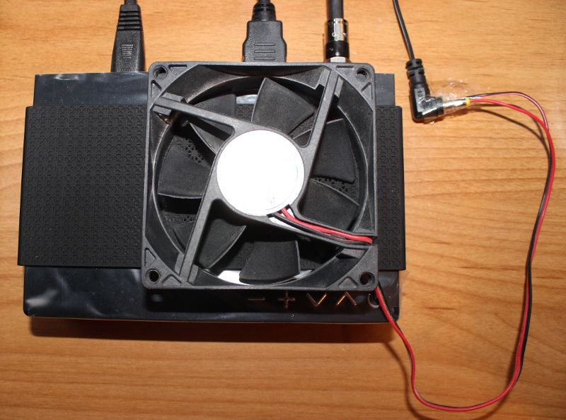

Funny you mentioned that! I didn't want to give up on this receiver just yet so earlier this evening I pulled an 80cm fan from an old pc that I built and just laid it on top of the M1HD temporarily to see if it would solve the reboot problem. I ran it off an old 12VDC/100ma wall wart.
I watched tv for just over three hours (6:00pm to 9:02pm) and there was no reboot at all. :) It was also 82° in the room today instead of the 67° it was the other day. So it's definitely a heat issue. Obviously it would work to just let the 80cm fan sit on top of the receiver but one or two 60cm fans could be attached permanently to the top so I ordered a few from Amazon today and will give it a try. It would be nice if the fan(s) could be powered from the supply inside the receiver. I wonder if 12VDC is available in there? :rolleyes:
