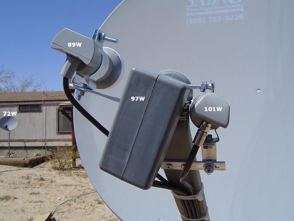

This newby with an old 3ABN dish of 2002 vintage needs to find a dual LNB mount for its approx. 1/2"x2" arm. Anyone know of a multiple LNB bracket for it, so we don't have to buy a new dish?
The dish you have is probably a 90cm KTI dish. I don't know of a 4 deg bracket for it. I also don't know the focal length, if it is the same as a GeoSat then you might be able to adapt their dual LNB set up. I think you would be better off to get a second dish and tie the two together with a 22khz switch.
Bob

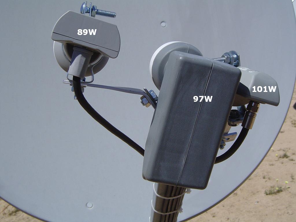

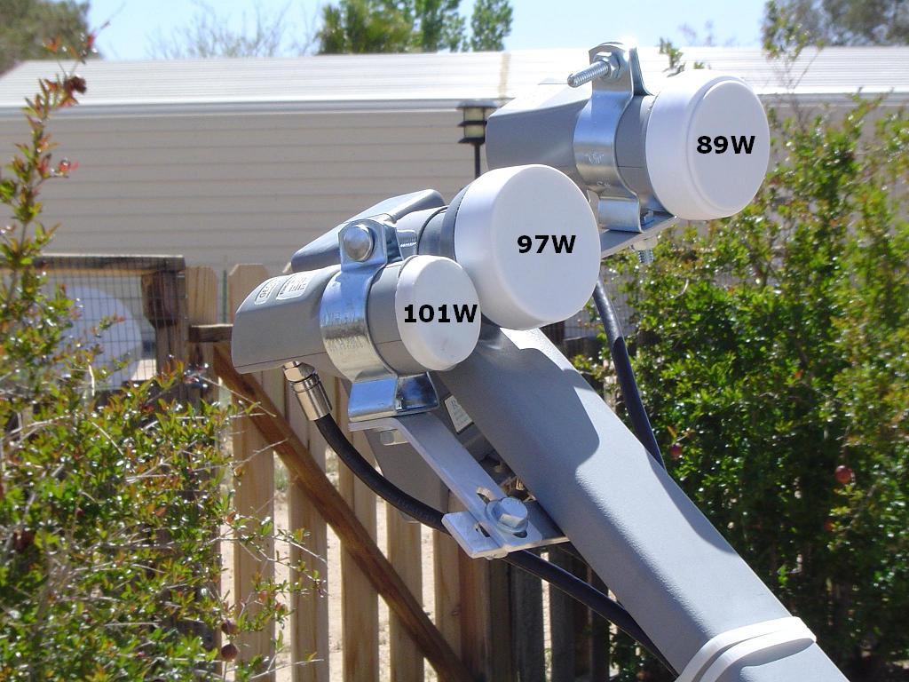

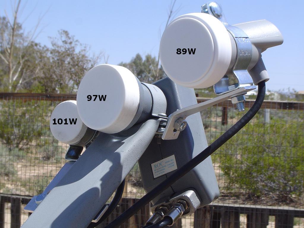

This dish has a unique configuration and I have a solution for you if you have some basic fabricating skills, look at my dish and see how I used aluminum and steel flatbar to mount 3 lnb's. The conduit clamps are 1-1/4", the 1-1/4" to 1-1/2" universal clamps are too big so look for the ones that are for only 1-1/4"
