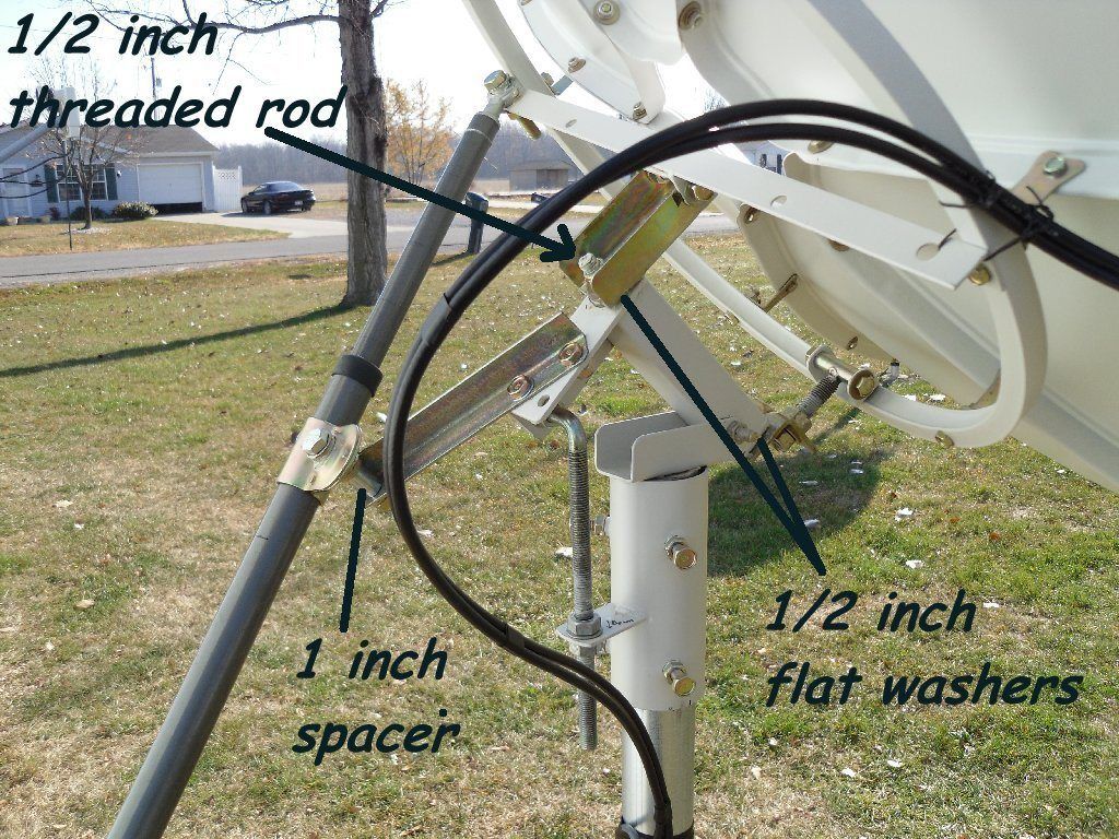

Brent or anyone else have you figured out how to stop the actuator from overshooting the sat your moving to? mine normally has to be moved a couple times when i go to each sat. the stronger tps are normally fine but sometimes they even get passed. it's really not a big deal but if there is a fix then i wouldnt have to keep going into settings and re-saving to view each sat.
Mine is better, but not perfect. I just haven't been able to get all the "slop" out of the system. Go out to the dish and move it sideways by hand, and you'll see what I mean. Unless you can conquer that, there'll always be the niggling problem. My problem is at the azimuth pivot point primarily, and I probably won't address it until spring.
Wouldn't actuator control problems like that be rooted in the controllor? VBox or GBox? Or is it totally a problem with quality of workmanship/design on the mount? I have never operated a BUD before. I'm getting ready to set one up and find this thread quite informative about the little pitfalls ythat happen to folks setting this 6' dish up. I built my own mount powered by an SG2100 and intend to use USALS on my C-Band dish. I hope I don't have those "niggling problems" with this setup. But if I do I may not abondon my project so easily if all I have to look forward to with an actuator is stuff like you guys are talking about. Kinda reminds me of the days when TV remotes first came out. Sure you could change the channel from the couch but you still had to get up and adjust the rabbit ears lol.
I think this is a quality issue, on the mount. Complaining about it, though, is silly considering that we knew these were "cheaply made" dishes starting out. They were also a bargain. There's nothing wrong with my setup that I can't live with, and I have hopes of finding a workable improvement that I'm competent to make.
I replaced the pivot bolt with a 1/2 inch threaded rod cut to length. I also added
some large flat washers and some white lithium grease. Replaced the two spacers
for the actuator with a one inch spacer from the hardware along with a slightly
longer bolt. Mine has no slop now. If I push on one side of the dish, there is no
play at all. I still notice with the Gbox, if I move from the west to east to my
recorded numbers it is more accurate than going east to west. I'm very happy
for the money spent.

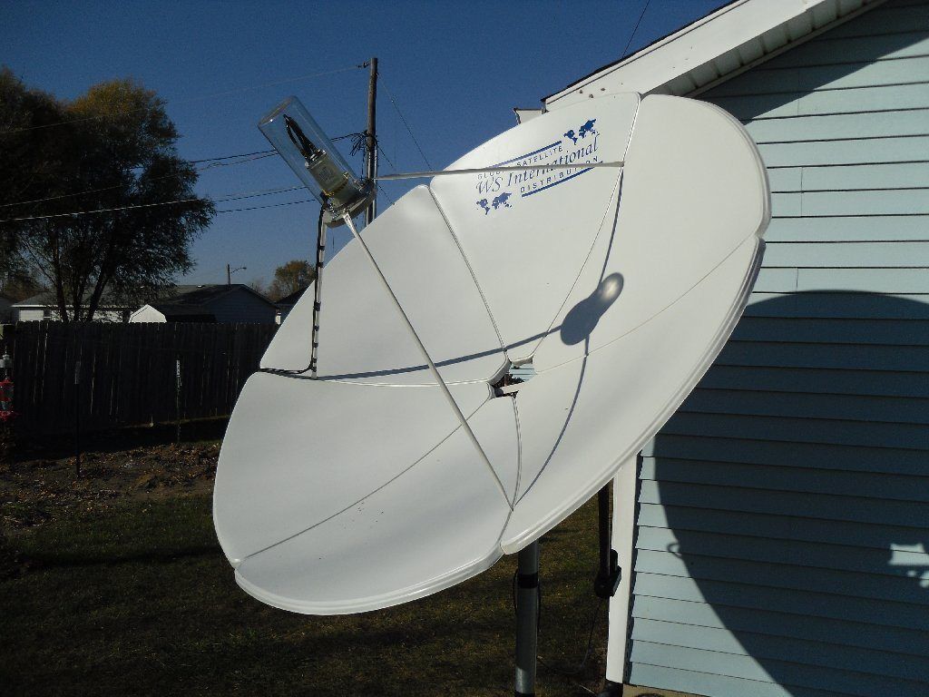

Whats that covering your LNB? Looks like a jar of some sort to protect the LNB +connectors from the elements! Good Idea!!
