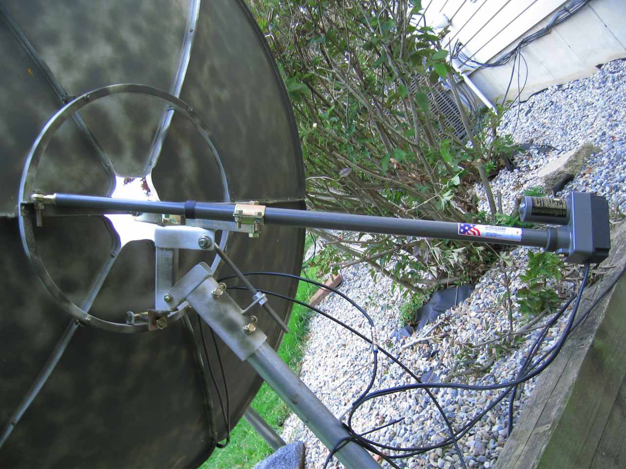

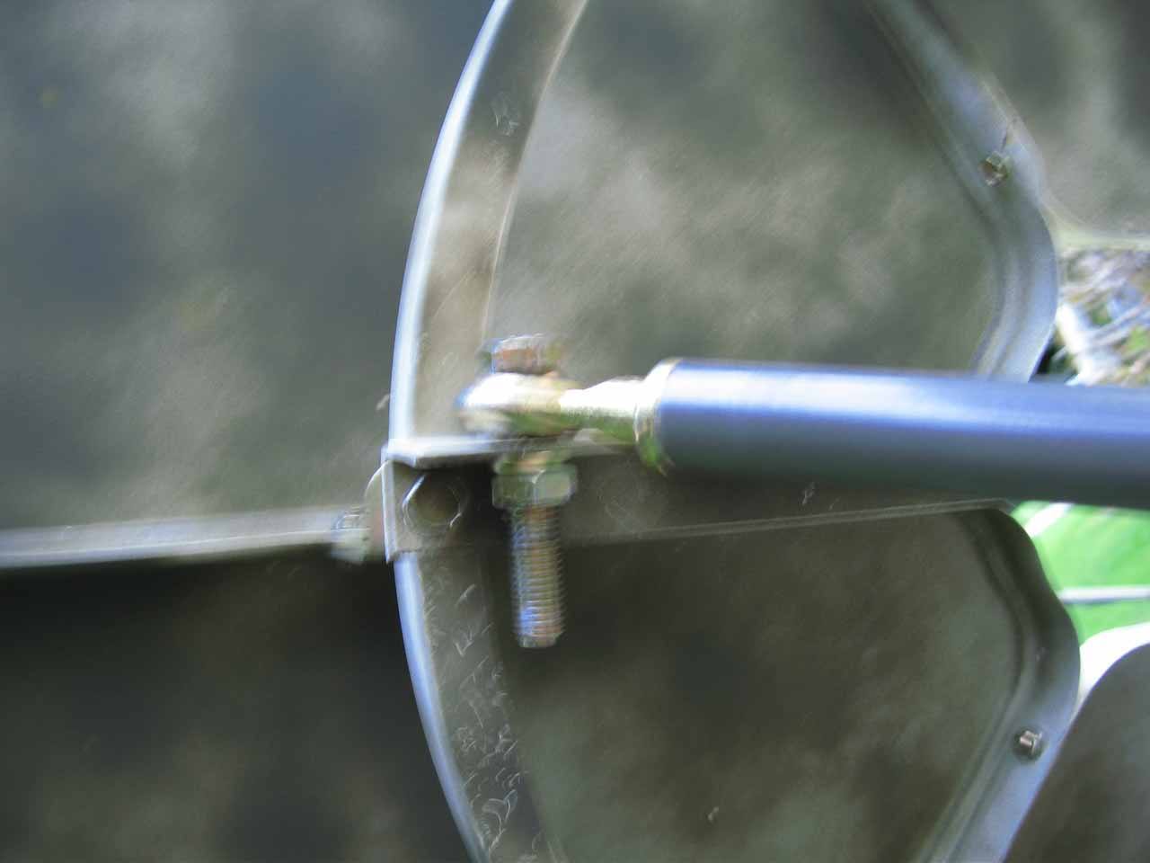

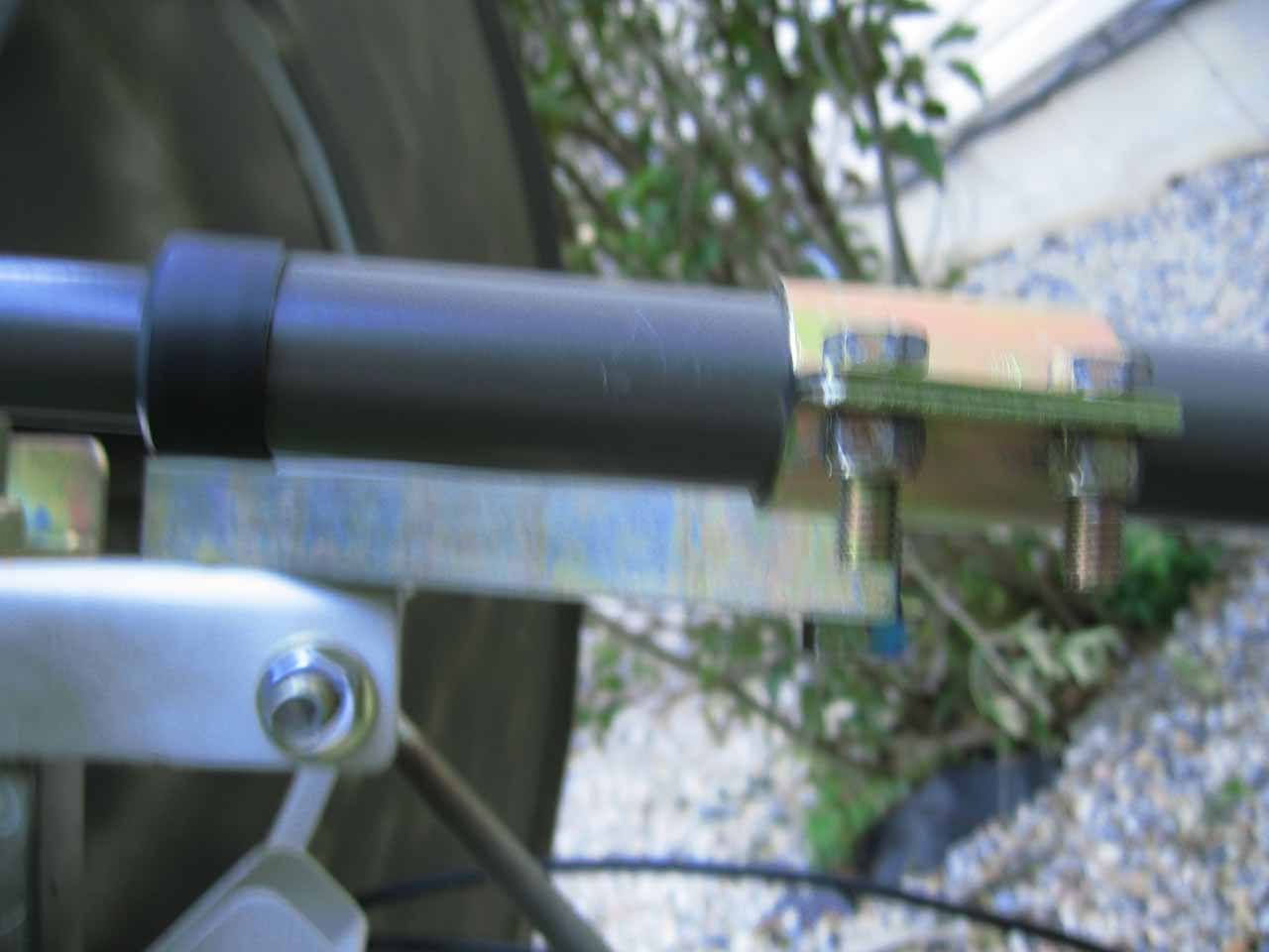

Here are a couple new pics. Show my actuator moved to the "high side" position, providing a straight shot with fewer spacers. Currently I'm okay from 87W to 123W ( all that I've tried for) with good quality. Only had to make one small adjustment to the declination, once I got about 10 deg from south ( 87W) . Because of some flex in the whole structure, the positioning is only repeatable from east to west. If I try to move back to a more easterly bird, I need to overshoot it and come back from the east side. A problem that will have to be worked on , bit by bit.
The Q values are MUCH better than from my 4 foot mini-BUD . Many channels that I never picked up before. Haven't even thought about optimizing the lnbf yet, still setting this turkey up, and having fun.
