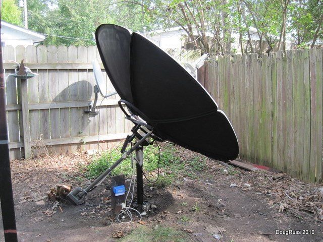

I thought the dishes from WSI supposed to be Actual size: 185cm = 6.06 feet mine only measure 70 inches did any off you measure your dishes .
Mine measures 70 inches across !
If you measure from the outer edge ( not the reflector diameter ) to the opposite outer edge, you might just get 72" . :)
I'km sure no one sent the "wrong dish" . These are the only bargain dishes that they have. The size spec may be a little "fudged", but it's definitely a 180cm class dish. My 1.0M dish is only 38.5 inches wide but 42" high. it's a 1.0M class dish.
Come on man we are not talking about a ku dish we are talking about c-band 6.6 ( 185cm ) is 78 inches on the WSI post on Satellite guys C-Band dish for $69.00 the specs are Actual size: 185cm = 6.06 feet. not 5.9" 72 inches.
185cm = 72.8" .
180cm = 70.86"
