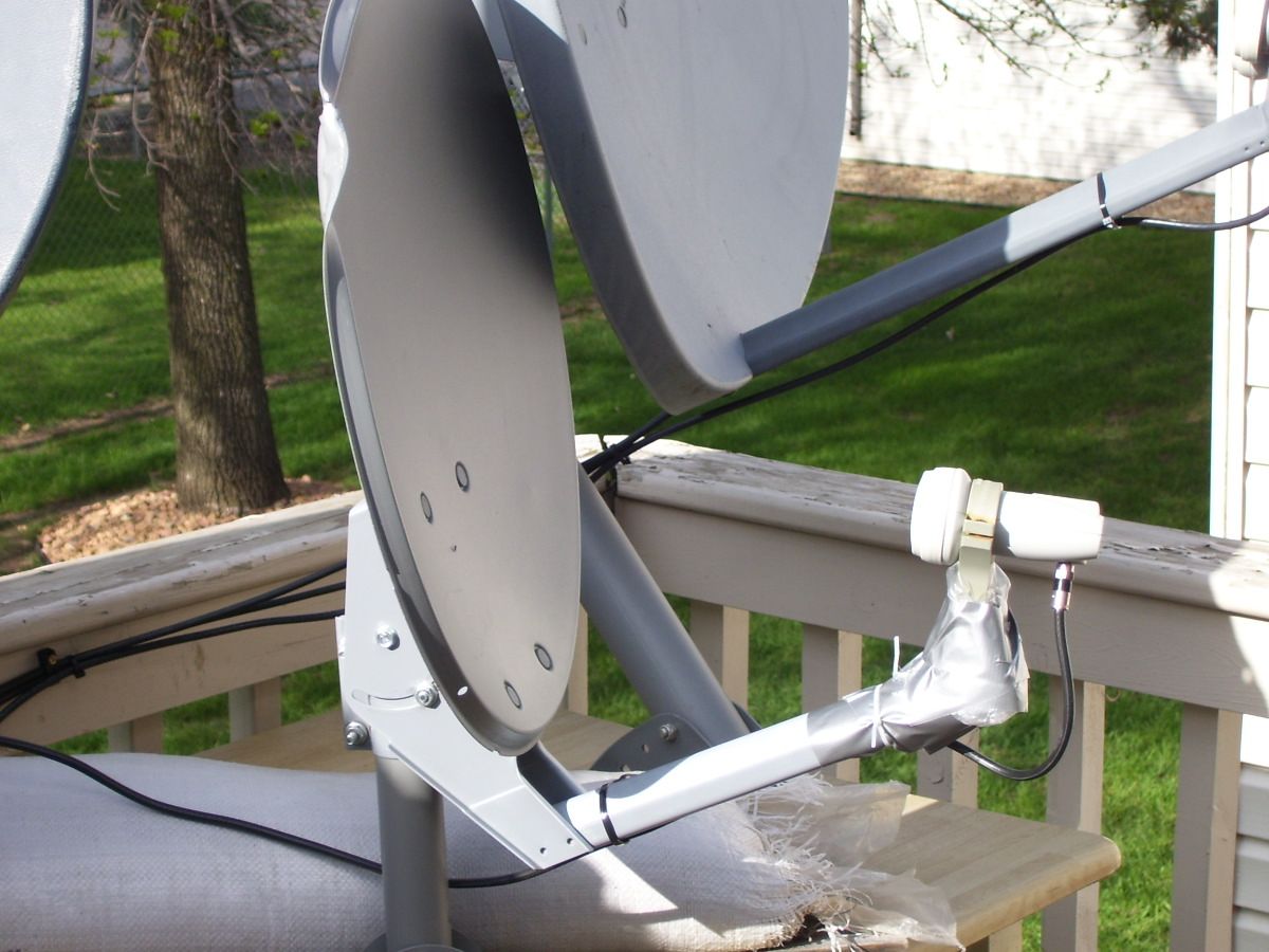

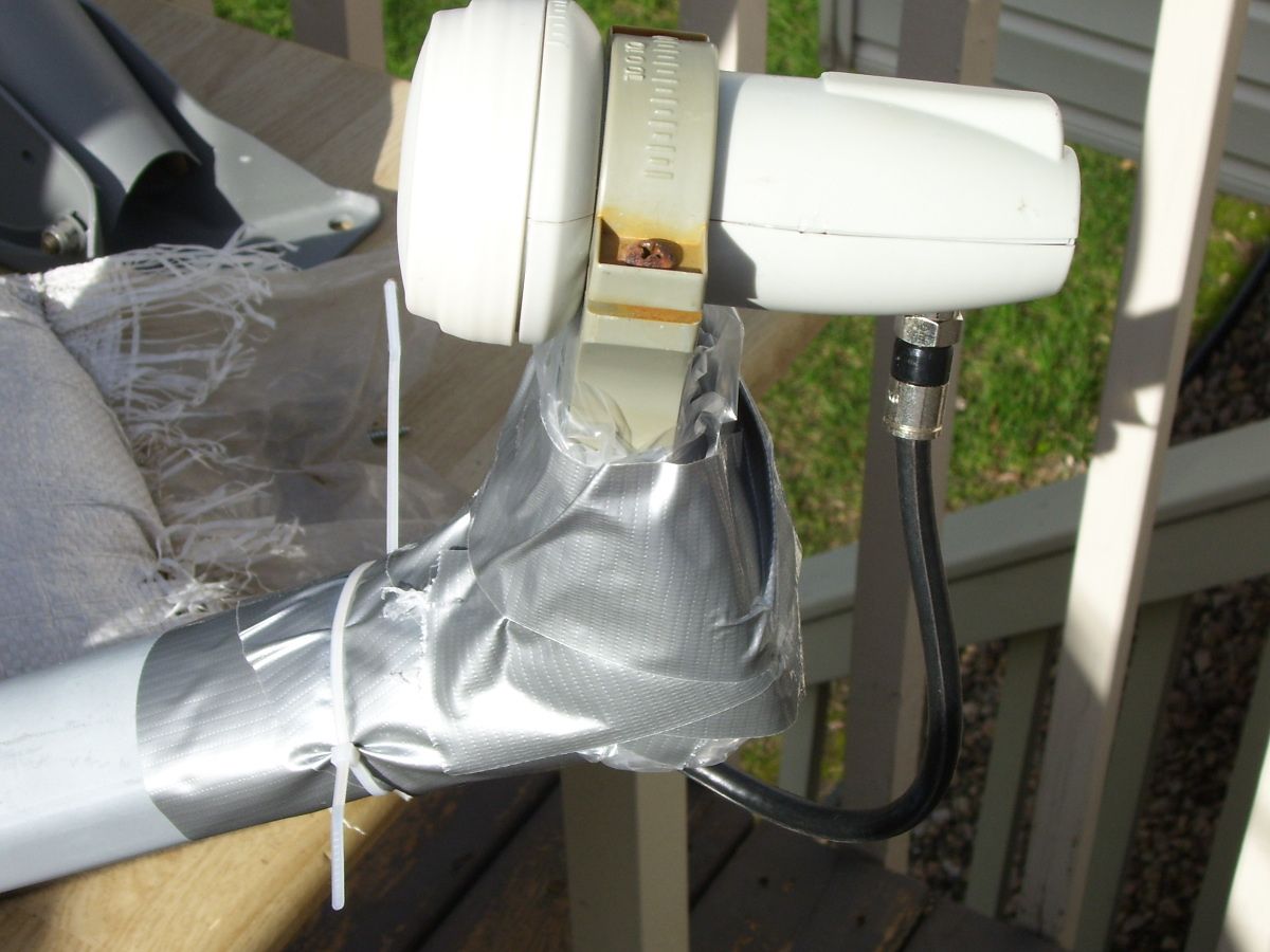

yes it will work fine. I used an 18" dish (dish 300) when I had my FTA setup and it worked fine for the DVB channels
