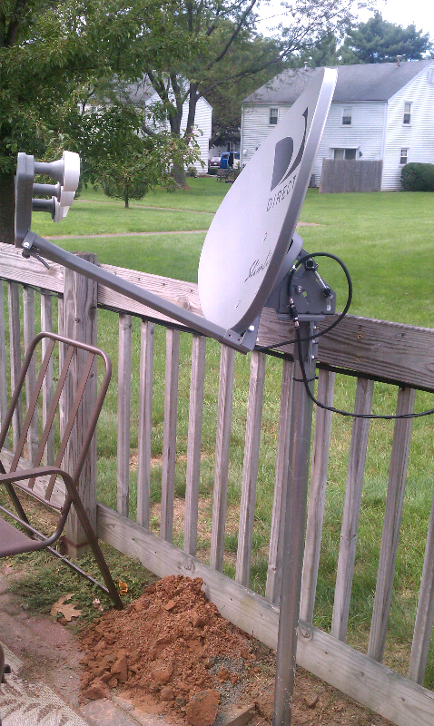

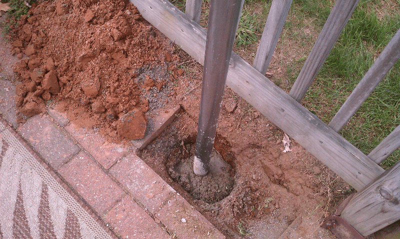

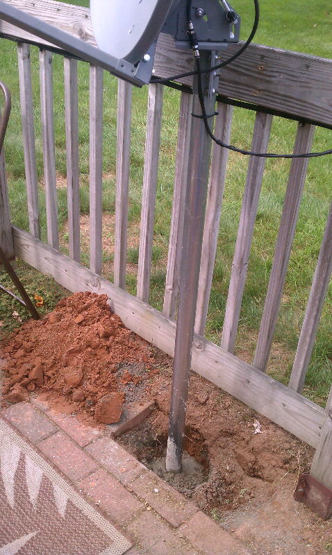

Okay I bowed to everyone's expertise as I always do here and had a pole installed. I removed 6 bricks inside my fence so no condo laws were broken (lol).

Looks like a great mounting job. May I ask if that is a barrel connector between the LNB line out to the run into the house?
I believe so ... guessing this may/may not be an issue; correct?
Unless protected from the elements; yes, it can become a point of issue. If you ever get time to make a solid cable run, that would be one less possible headache over time. Mine a long time ago became a point of moisture entry. One I removed it, no issues.
