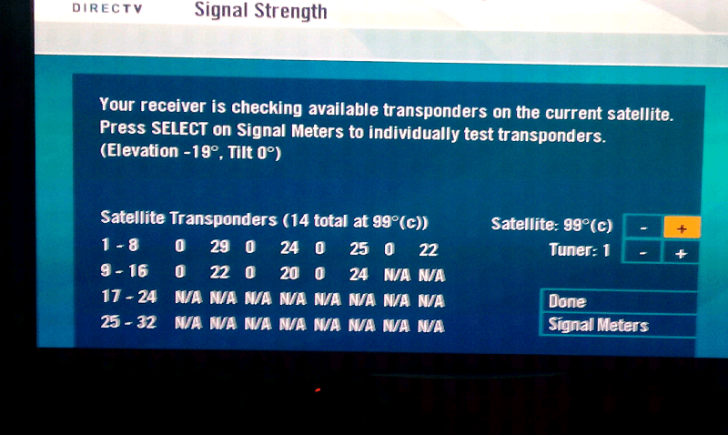

Okay, does this help:
You need to post the signal strengths on all of the satellites. If your numbers on 101 are this low, you most likely are very low on 99c and 103ca-cb.

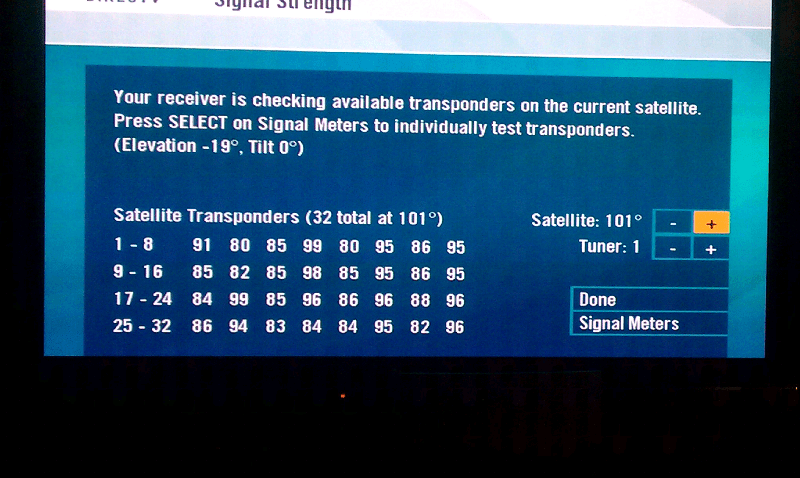

More pics ... getting an error trying to upload more pics sorry, but I am guessing the low signal strengths are the problem; correct?

tvropro said:
20's.... I'm surprised you have any picture.
Only 1 or 2 having problems: ESPN2, HGTV. Other than that, no problems ... wonder why this "just happened"?
Clarifying q: #'s should be in 20s not in 90s or N/A?
Doesn't the odd transponders reading zero indicate a multiswitch or lnb issue aside the low over all numbers?
you might need to find a buddy and try a DIY realignment. or call back saying everything is now out, need service. Do you the protection plan?
Odds are the mast is out of level, guessing a batch of the old monopoles that was sent out a year ago prolly kicked the bucket or the tech didn't mount the dish correctly. Either way, that dish is out of alignment big time
Thanks ... at least this will be fixed ... before tech leaves on Monday, what should the "average" signal strengths read?
