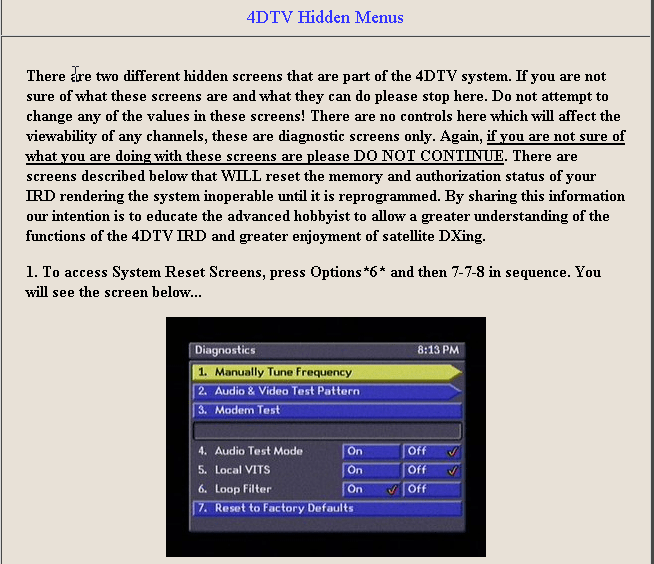

Also try using the test menu to see if it works..see attachment...select the audio / video test.
