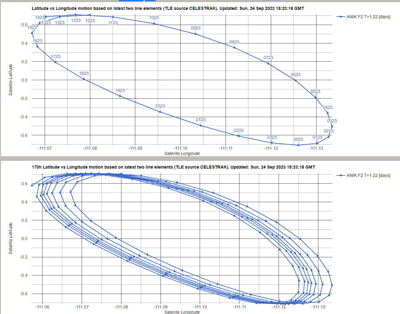

Is the drift getting smaller? I don't see a lot of change from the current Celestrak-based chart from the one posted on this thread 10 days ago.
The drift is slowly but steadily increasing. +/- 0.629 N/S today.

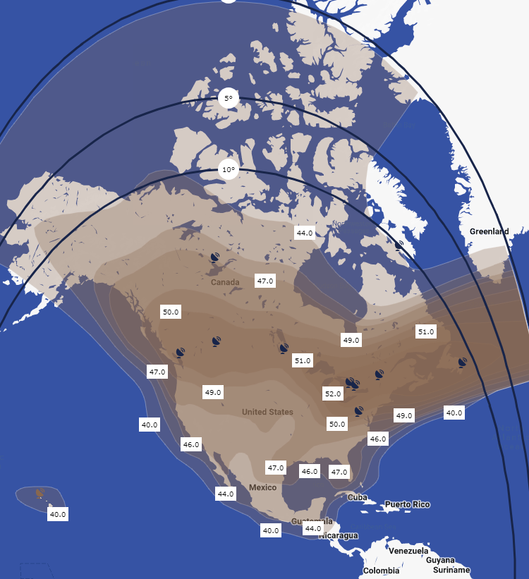

Based on the Telsat footprint ( which is a modeling prediction generated during construction) ,the San Diego area might lose reception at either end of the N/S orbit.

I was looking at the longitudinal drift, which is predicted to be less than the similar graph predicted a few days ago.
What's most striking to me, if I am reading the charts correctly, is the change in altitude. The altitude changes 25 km (from low to high or vice versa) every 12 hours -- a full cycle every 24 hours. That doesn't sound like a healthy orbit to me.
However, I can easily see how a simultaneous latitudinal wobble and an altitude wobble could explain lengthier outages, as they would both affect reception azimuth in ways that could cancel each other out or create an extreme endpoint.
The latitude drift scale is in 10ths of a degree. The longitude drift scale is in 100ths of a degree . So there is essentially close to zero longitude drift.
It takes minimal fuel to maintain longitude but significant fuel for latitude control.
The altitude is similar to longitude. About as close to zero as you can get.

Today, Sept 1 is their estimated loss of service date for the western arctic.
Probably the 40-44 and less EIRP contour.
Their next loss of service projection is for Dawson City,YT on Dec 1.
Probably the less than 46 EIRP contour.
