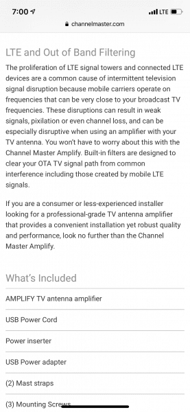

If you have any cell towers near you, you might consider Clear Stream's Juice PA. It has a LTE filter. LTE can screw with your signal. It's worked great for me.
Reactions: comfortably_numb

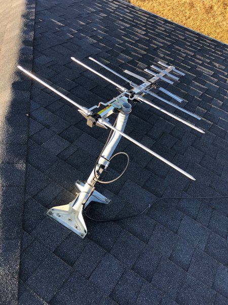

I have a cell tower SW of me about 2 mi but my ant (CM 4228) is pointed SSE and currently fixed since I believe lightning or woodpecker has killed rotor.
The CM7777HD also has LTE filtering :)
I can attest to the fact that it works as I literally have a VZW cell tower right behind my house
If your cell phone is picking up a LTE signal it can interfere, doesn't matter if your antenna is pointed in the direction of the cell tower. Cell towers are omni directional.
If the cell tower is causing lte interference then why did it not cause it for the past 30 yrs. I have never had any distortion until connected to the module and to hopper. I can disconnect and run straight to tvs and no pix.; so do you still think it may be lte.
LTE interferance wouldn't cause a complete blackout just occasional breakups. As far as the past 30 years, LTE hasn't been around but a few years some places still don't have it. Also it only interferes with digital signals not the old analog of yesteryears. I attribute all antenna signal problems to the Sock Fairy. If you could find all those socks that have been lost in the dryer you'd probably have a perfect broadcast signal :-)
I realize the lte is recent problems but as stating when connected directly to tvs via the rg6 then no pix but when I go through module to hoppen then get pix. Also it's currently not bad enough to go back to switching from dish to antenna inputs but do you think it could still be lte or maybe a faulty module.
