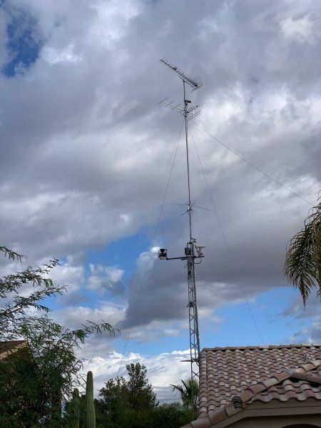

I've got a faulty AirTV module. It wouldn't connect to the channel even though it was showing a strong signal. I went back to the Dish module that I had replaced with the AirTV and that problem went away. Just today I was going to contact AirTV about getting a replacement, it had worked great for about 3 months, but you can only call in, no email address available. I didn't have time to hang around on the phone. I'll do that on Monday. Not sure what their reaction will be to using it with a H3, I'll let you guys know. Depending on the module you are using . . . I know that tuner sensitivity varies greatly. I spent a lot of time and effort to get my signal strength up to tell Dish what they could do with their local channels. Some tuners the signal was fine, other not so. VIZIO tuners suck. I was finally able to get adequate signal to all tuners in a difficult terrestrial situation. Attached is a picture of what it took. I had to split the VHF and UHF because the
the mountains somehow changed the path of the UHF signal (Sock Fairy) so to get both with one antenna you compromised both signals. You can't tell in the picture but there is a 1 to 2 degree difference. VHF is pointed directly at the transmitters, UHF is offset.
UHF
UHFView attachment 136576
That's a nice antenna rig you have there.
Are you able to pick up any Tucson stations with that setup?
I've found the tuner in my Vizio TVs to have better sensitivity than the ViP receivers.
If I rotate the antenna around I can get Tucson. In fact it's probably easier since it's a straight shot, no mountains. I'm on the wrong side of South mountain where the Phoenix transmitter farm is. I have 3 VIZO TVs all had problems picking up VHF 12 before I split the antennas. LG, Hdhomerun tuners had no trouble with it. Dish module was flakey but could pick it up. Complete no show on VIZO.
cell phone could be getting interference right; well that's not possible since I don't use a cell phone at home. It's never on or used unless on the road, never leaves truck; don't like them
LTE signals are there even if you don't have a cell phone. They are coming off the cell tower not your phone. Your phone is receiving the signal just like your OTA is receiving the signals. Good for your phone, bad for your OTA :)

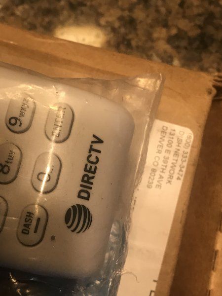

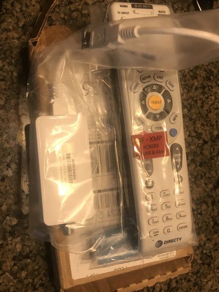

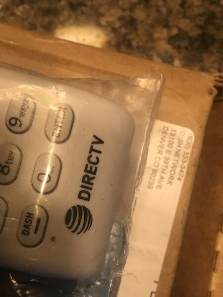

Received my AirTV OTA dual adapter today. Strange thing is. It shipped from Dish network in Colorado, but it also came with a Directv remote. I'm really confused?
