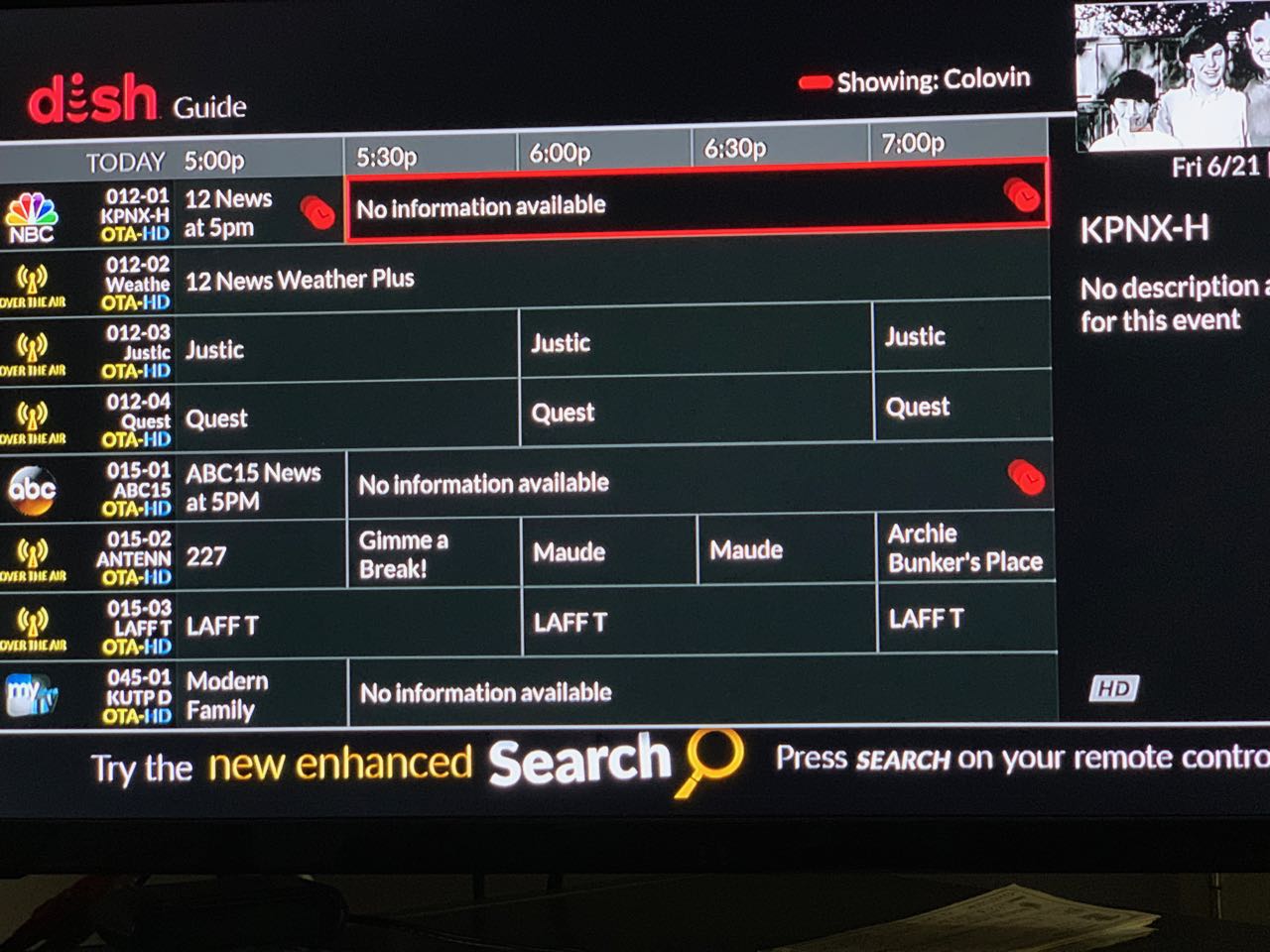

Yes my Guide shows my 49 OTA local channels from Dayton and Columbus Ohio plus the satellite local channels. Of course a few of the subchannels do not have Guide data. I have attached a picture showing the Guide.

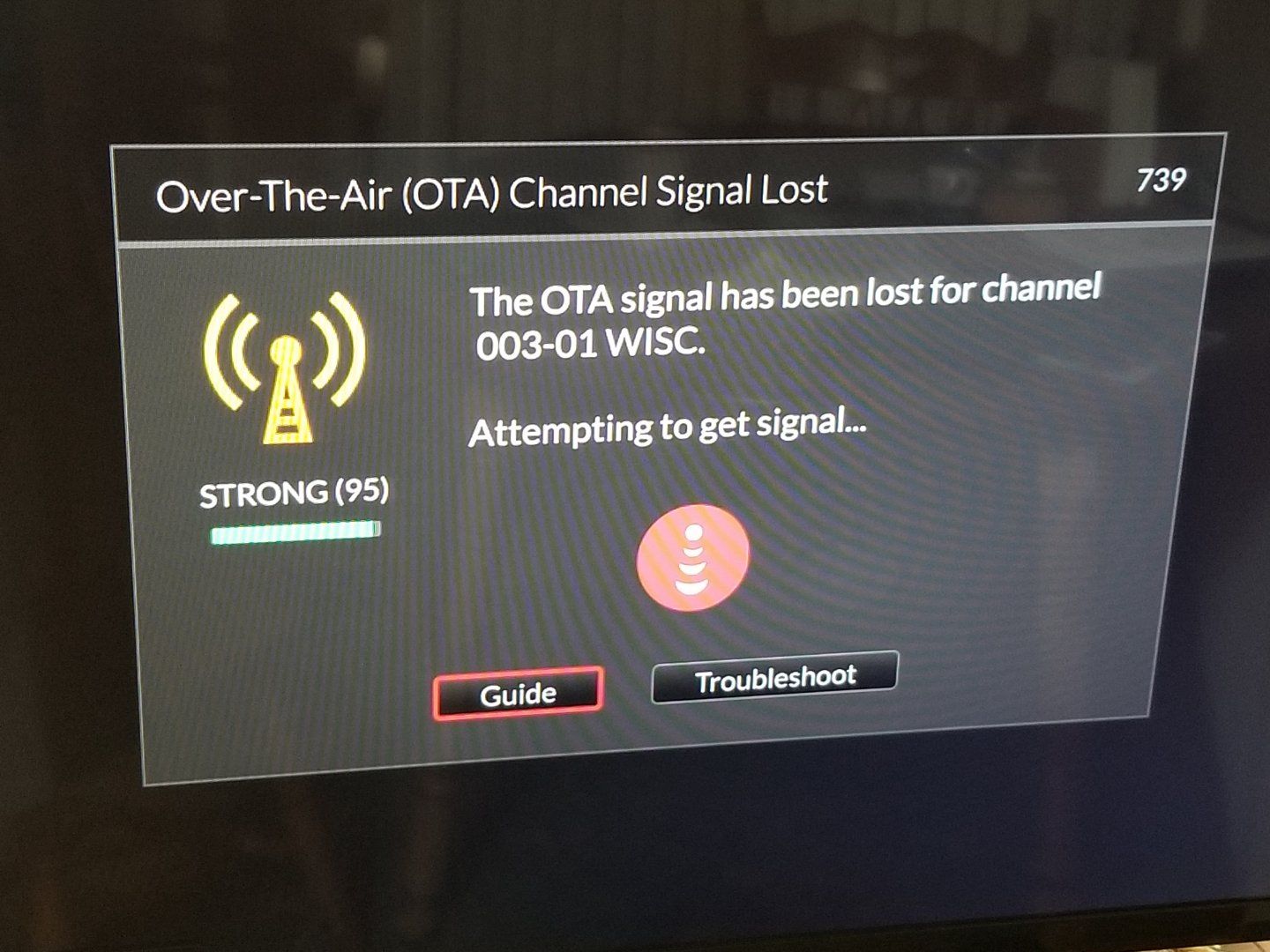

For the 3rd time now my local CBS affiliate WISC OTA ch. 3.1 decided to lock up and wouldn't record anything. It shows in the guide with the red record light but that's it. In the schedule it shows not applicable for recording started and stopped times. When I try to tune to the channel I get the error message below. The only thing that fixes it is by doing a OTA channel re-scan. Changing from U535 to U536 did not make a difference either way. None of my other OTA channels have had any problems.
Is it my AirTV dual tuner dongle or my H3 or a software glitch or the station doing something, or or or?? The signal strength is normally 100%. Don't know why it dropped to 95. Right after I took the picture it went back to 100.

For the 3rd time now my local CBS affiliate WISC OTA ch. 3.1 decided to lock up and wouldn't record anything. It shows in the guide with the red record light but that's it. In the schedule it shows not applicable for recording started and stopped times. When I try to tune to the channel I get the error message below. The only thing that fixes it is by doing a OTA channel re-scan. Changing from U535 to U536 did not make a difference either way. None of my other OTA channels have had any problems. View attachment 139340 Is it my AirTV dual tuner dongle or my H3 or a software glitch or the station doing something, or or or?? The signal strength is normally 100%. Don't know why it dropped to 95. Right after I took the picture it went back to 100.

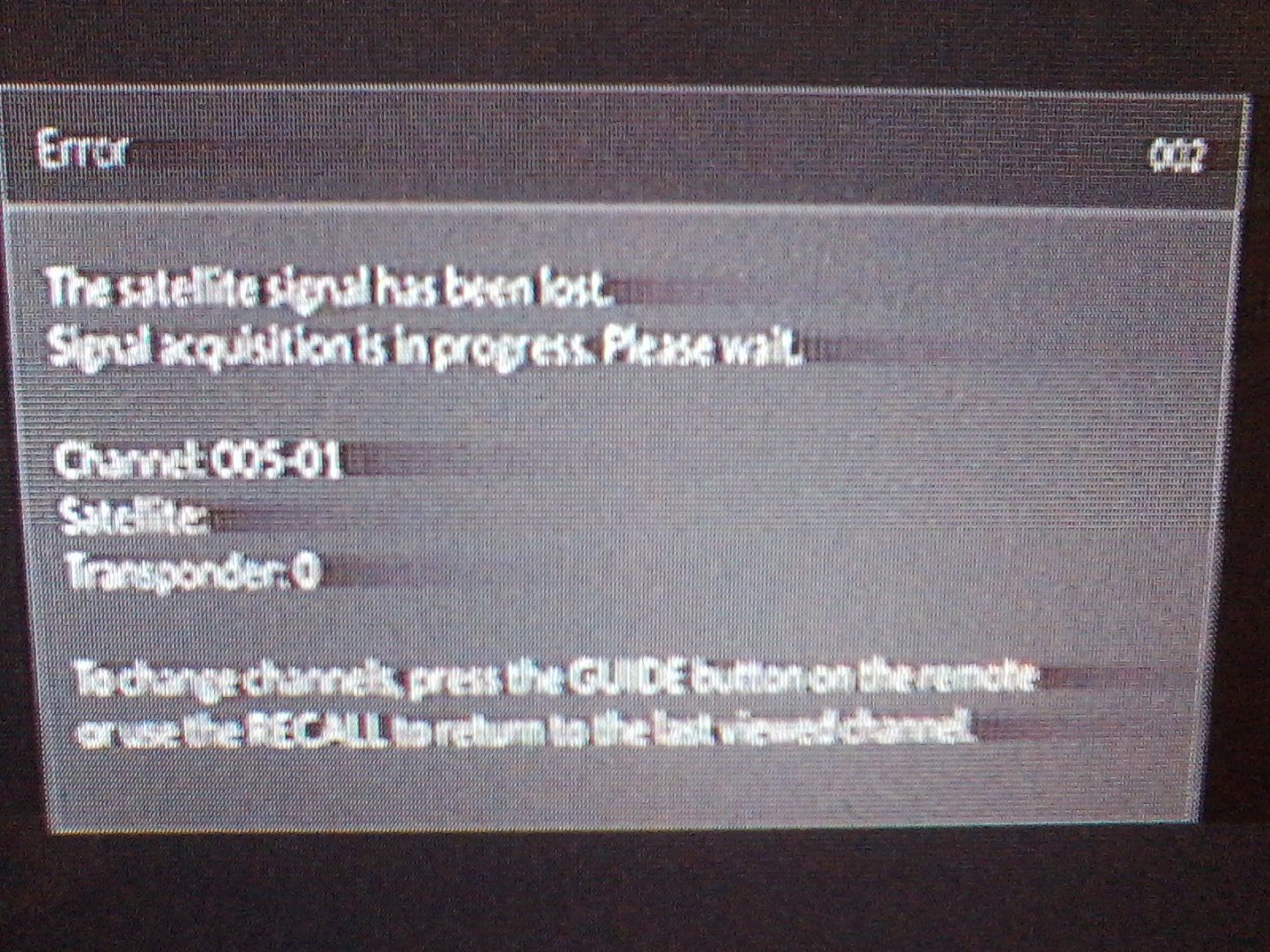

At least the message you get is more useful than what shows up on my Wally. Whenever this happens to me, I get the "satellite signal lost" Error 002 in the picture below:
Notice that the channel number shown is 005-01, which is an OTA channel, but the message says the satellite signal has been lost. :confused: I would love to see Dish implement the OTA 739 message from your picture (or any other similar type of message) on the Wally, as at least it would indicate an OTA problem, instead of incorrectly saying that the problem is with the satellite signal. I have never seen the 739 message on the Wally. :(
The 739 message maybe slightly more descriptive but it doesn't really give you much to go on. When you click on the troubleshooting button it only gives the standard reasons why the signal may be blocked/obstructed. But with a signal of 95 to 100 that's obviously not the problem. The fact that it's only occurred on the one channel(and it's sub) makes me wonder if it is some sort of software glitch. If I switch to the tv tuner while this is going on the same channel comes in perfectly which kinda rules out the antenna.
