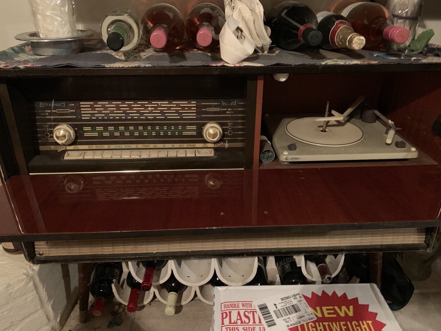

I wish I knew where I could test some tubes- err, "valves." If I could get replacements it might bring my Kuba back to life.
If you have the Komet, then it would be well worth your time to get it going again. I don't know what you would do for a TV station, though...
On second thought, yes I do. I'll contribute my A/V to NTSC transmitter to the cause. People's minds would be BLOWN to see that working again. Especially with your HwS playing on it. ;)
