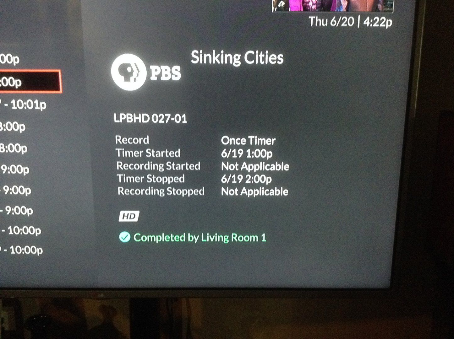

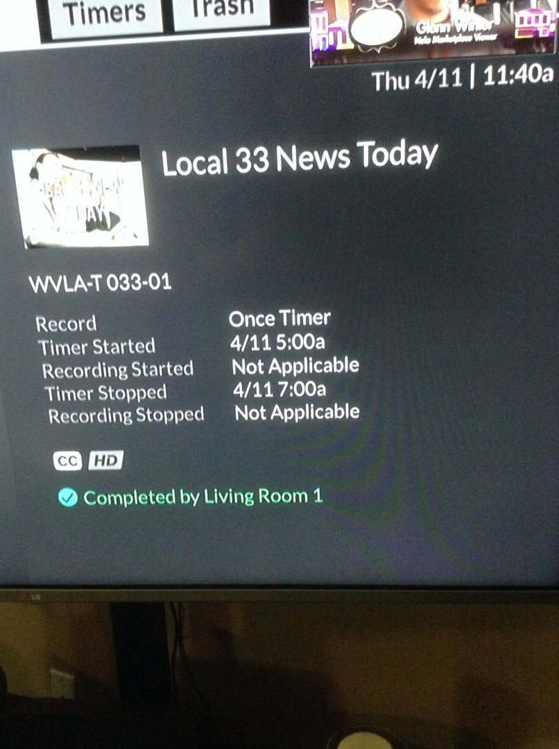

I wish my hws would record ota. When I go back and look The event shows up in the Schedule Tab for the day's activity but it says "Not Applicable" for that event on the right side of the screen, where it gives the details for "Recording Started" and "Recording Stopped"

Yes, that is what I see on my Wally, usually once per week for one of my OTA timers. In my case, though, I am also usually recording another OTA channel at the same time, attempting to use both tuners.

I only have the single ota tuner so it isn't that for me.

If I remember correctly, some people in the thread I linked above were able to solve this type of problem by switching to the newer Lark dual OTA tuner, or the Air TV dual tuner. I am still using the old Hauppauge dual OTA tuner with my Wally, so that could be part of my problem.
