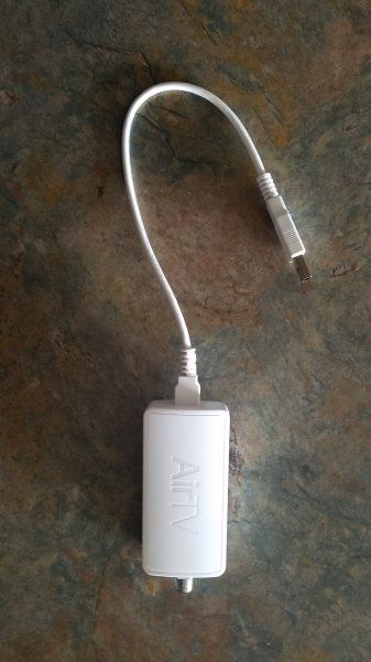

Received the AirTV Dual-Tuner Adapter and it works. Performed a scan test in a Hopper 3 between it and the old DISH Dual-Tuner OTA Adapter. The AirTV channel scans are all over the place. Signal strength for both adapters was 100% for all the channels except one and it was 80%. OTA antenna is mounted in the attic, amplified, and split 3-ways. TV stations are located approximately 23 miles from St Louis. The AirTV Dual-Tuner Adapter is a little cooler to the touch. Went in to DISH Anywhere in my laptop and I see both Hopper 3s but did not try it out.
Attached is the scan results and temperature of the adapters. Will test the Newest Model Dish Dual OTA Adapter Tuner when I get one and post the results.
There you go! Look how much money I just saved SatelliteGuys members.
To be honest I was 99% sure it would work as I have been using one on my AirTV and on my Hopper 3 for about 9 months now. I have been VERY happy with the performance when compared to the old Dual Tuner dongle.
So now stop paying $49 - $69 for these things from Ebay.... and just order yours from AirTV for $29. :D

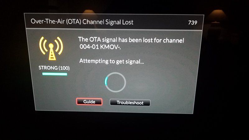

I am hoping it performs better. I have been getting a lot of signal lost on one of my Hopper 3s.

They may have a run on these :-) I ordered one. If it runs cooler maybe it gets better reception. Like Charlesrshell, I've been having some reception problems with a channel that shows up as strong in the OTA menu (96) and none of the many other tuners I have are having problems especially on that channel. So it's got to be the tuner. For $30 I'll take a look see. Thanks for taking one for the team. I'll report my results when I have them.
