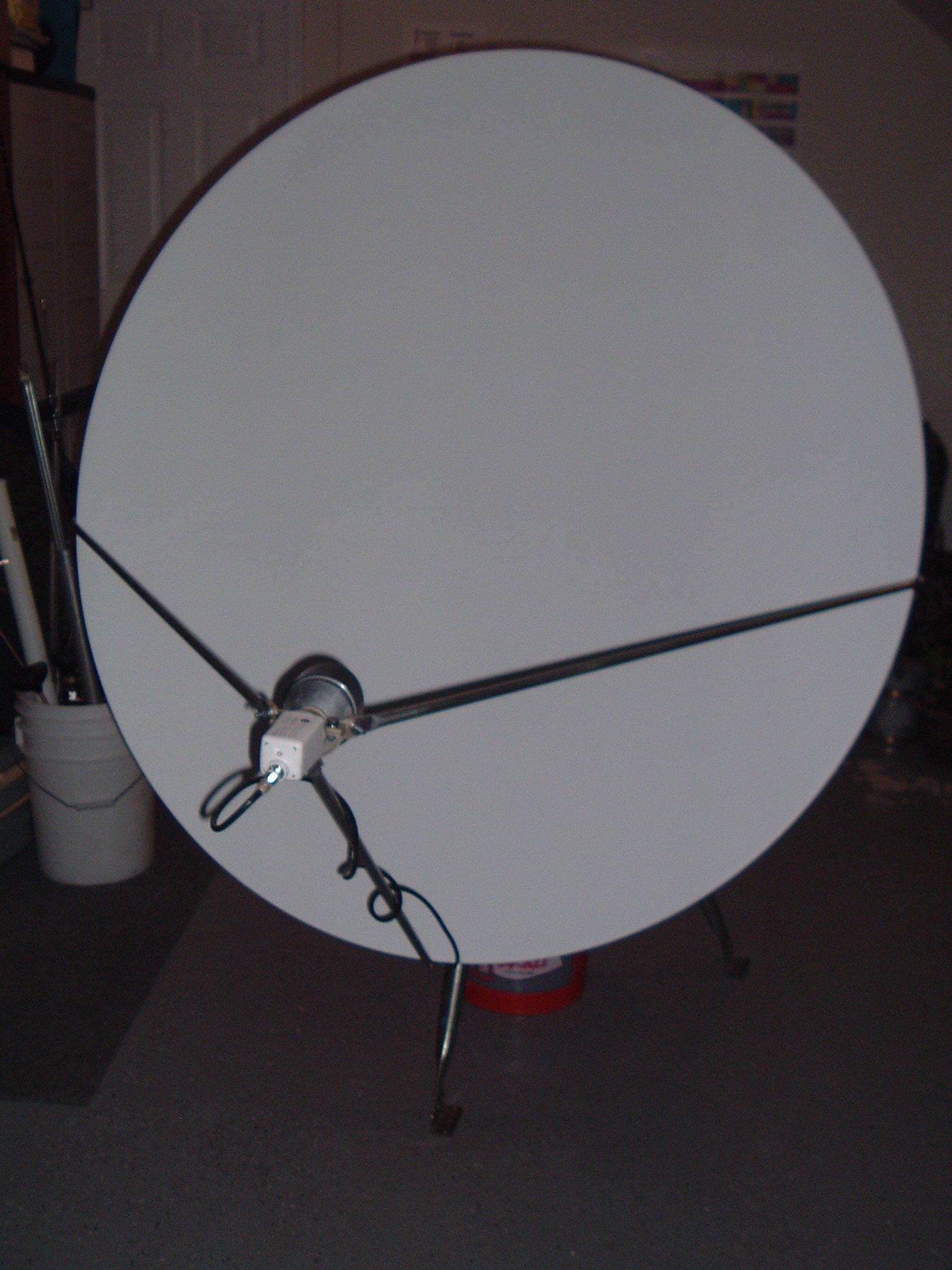

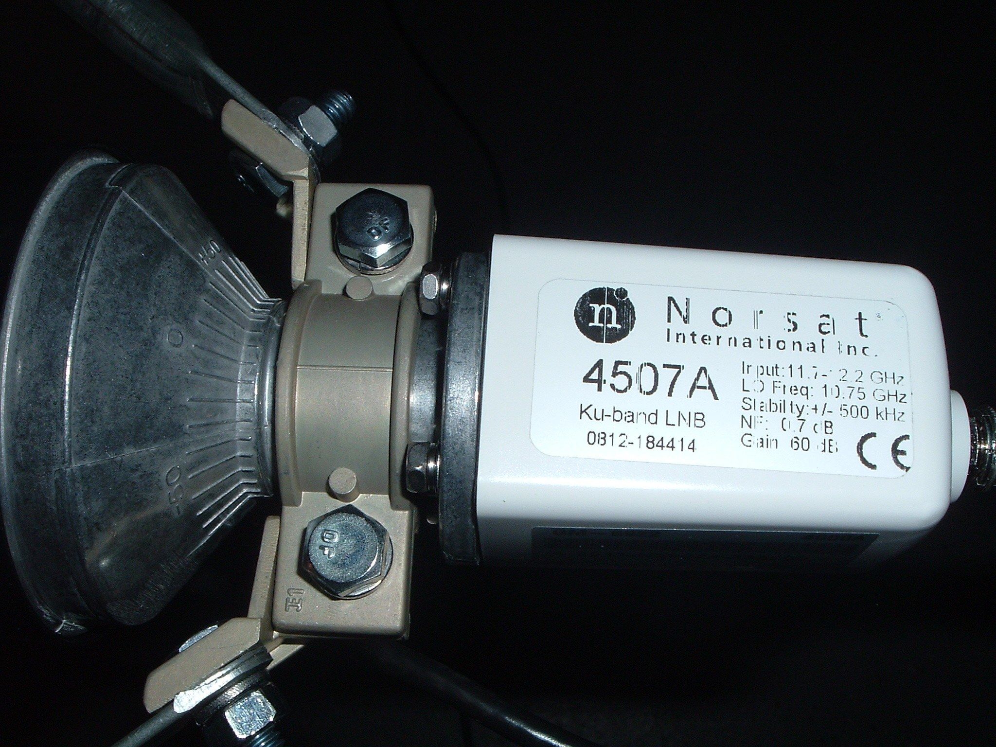

Has anyone had any experience using the Norsat 4057a KU-LNB? The specification sheet does not state if it is a signal or dual polarized LNB. Normally specifications tell if they will receive vertical and horizontal. I am in the process of motorizing my new Prodelin 1.2 meter Dish and I only had this LNB that fitted the original holder. It is raining today and I have not had time to check it out.

What does the spec sheet say about Power Requirements or, Input DC voltage?
I have a similar dish and LNB. The spec sheet says 15-24 V. No mention of polarity. To me that means single polarity.
Take the LNB off the feedhorn and take a look inside. If it is single polarity it will have 1 pin inside. If it's dual there will be 2 at right angles from each other.
Thanks Guys
Thanks Guys, and thanks Ice for changing the title. I must be suffering from dyslexia of LNB model numbers. I even took a close up picture of the LNB and wrote the wrong model number.
I did not check the probe when I assembled the LNB to the feed horn. I took it apart and there was only one probe, so it is single polarity LNB. Now if the wind and rain will only abate, I can get some test time in with my new toy.

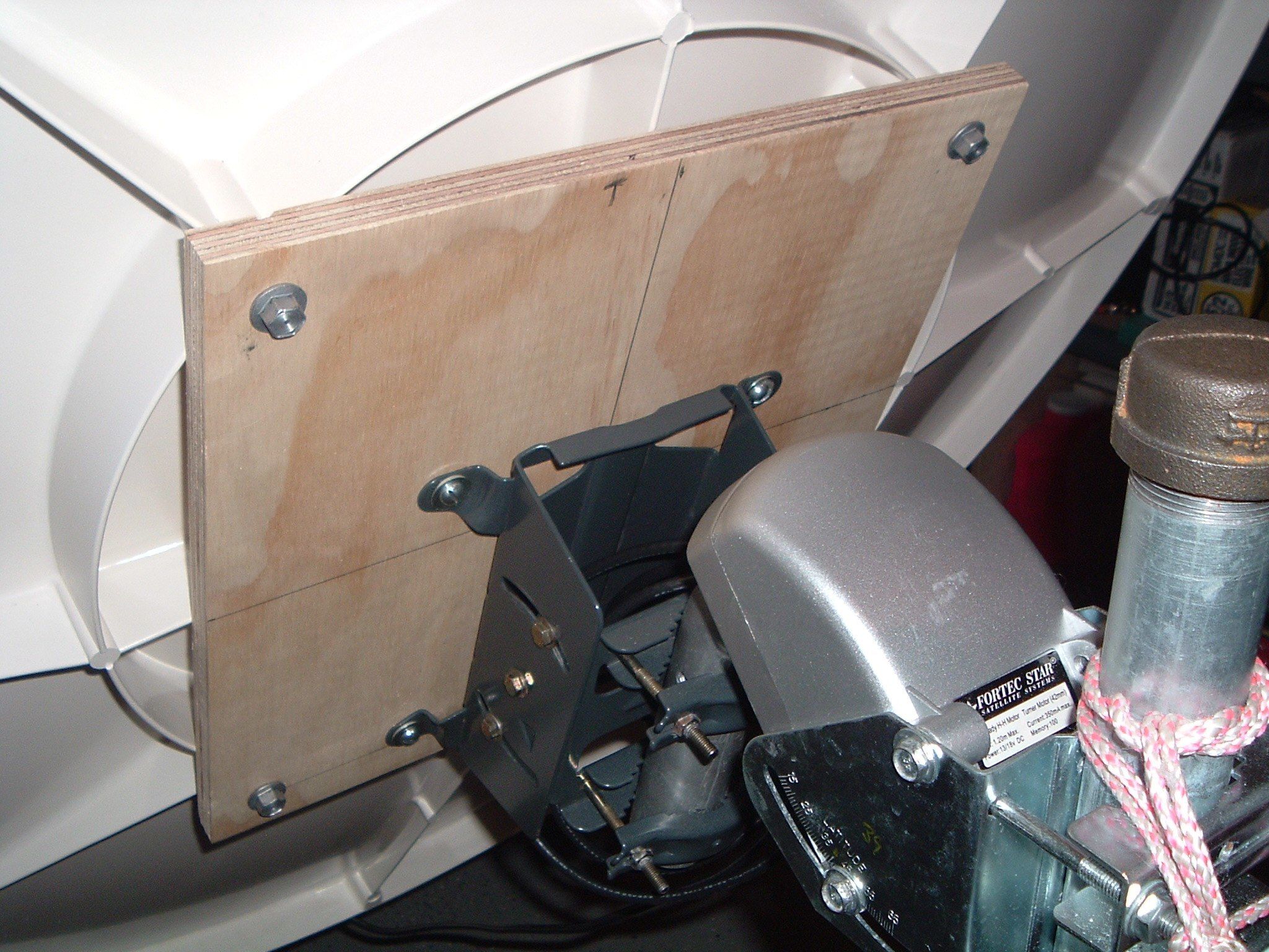

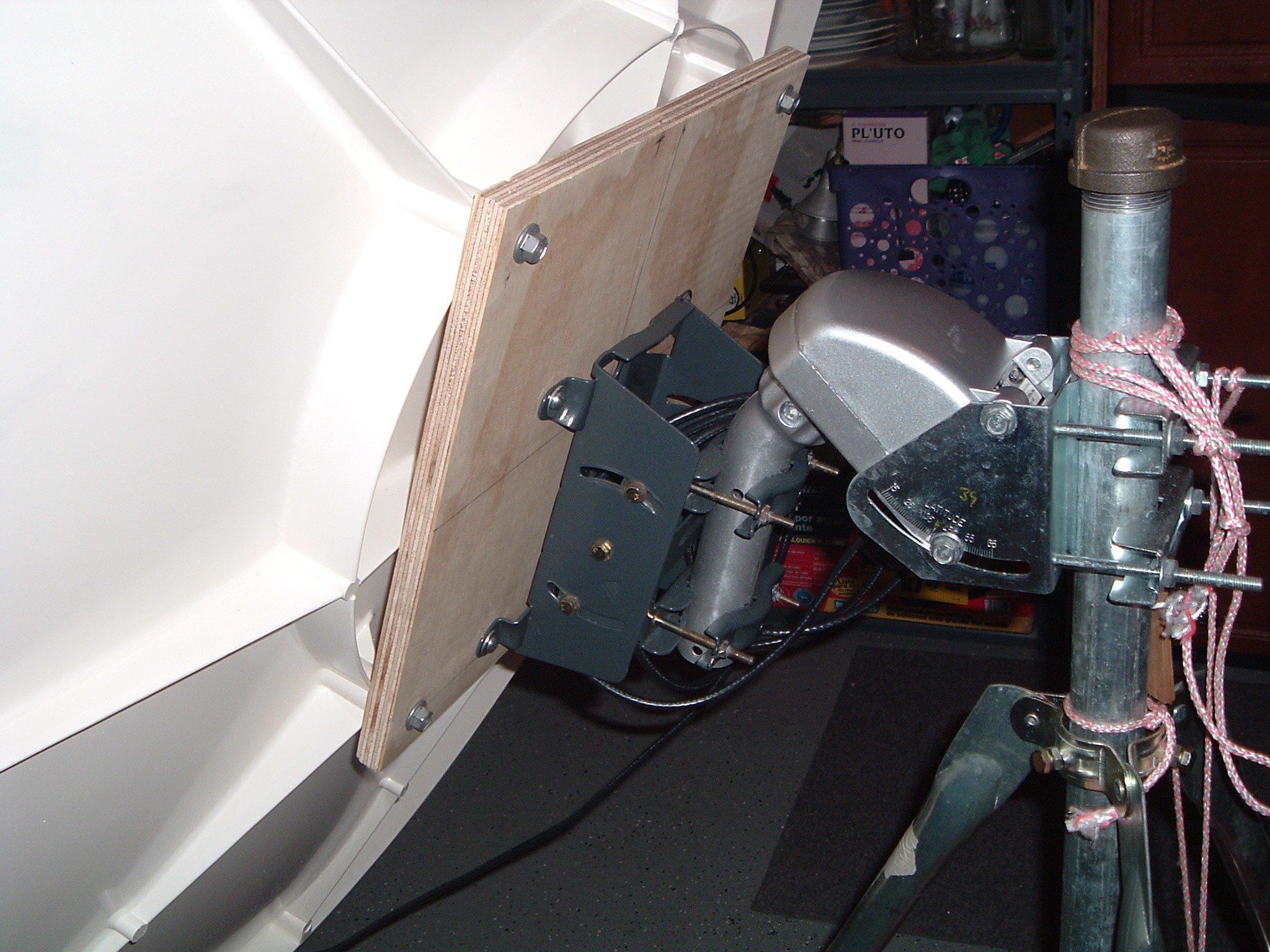

Thanks for the info, I will give them a call tomrrow and see if they have one in stock. I am also in the market for a heavy duty HH motor to turn the 1.2 dish. The reflector is pretty light since I used a piece of plywood for the back mount, but it can use a a good heavy duty motor and a good tripod. The tripod frame twist if it is windy.
