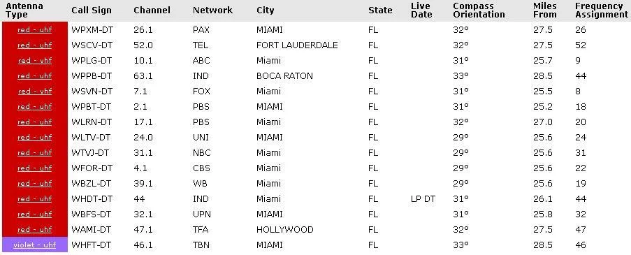

Attached is an extact copy of what antennaweb.org says about my local HD channels and my location. Will the OTA antenna that comes with the initial setup of the equipment be good enough to get all these channels. I'm less than 30 miles away from all the towers.
Thanks in advance....
If anyone lives in Miami and has Voom please let me know how its going for you.
It looks fine to me. More importantly enter your zipcode at this site and make sure that the mapping that VOOM uses is correctly identifying all your OTA channels.

I checked on zap2it to compare listings from what I found on atennaweb.org.
6 of 12 channels are identified and labeled correctly
the other 6 channels show different channel numbers on atennaweb but are shown in zap2it
