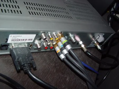

Do not use the UHF input. When you run the second line from your antenna, take out the displexer and the OTA module is right there (where the displexer is). Connect your OTA coax there.
See a picture of the OTA module without the displexer. The input to your right.
http://216.120.249.94/voom/inside/small/back2s.jpg
Is this the correct setup?
Yes.
